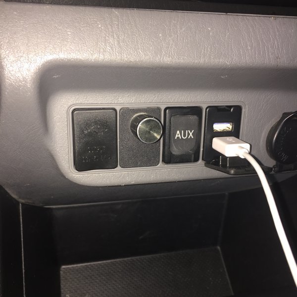

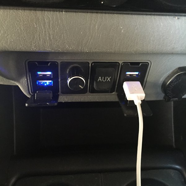

    Added some USB ports under the AC controls. They fit perfectly, but holy mother of god you have to tear the whole fucking interior apart to get them installed. I wired them directly to my Blue Sea fuse block so they are always powered and at least have a fuse in the system.
    Here is a link to the Usb ports I ordered
    https://www.amazon.com/gp/product/B00VFCDX4W/ref=oh_aui_detailpage_o00_s00?ie=UTF8&psc=1
    This thread here will help you get your interior apart without breaking anything
    https://www.tacomaworld.com/threads...enter-console-clean-look-lots-of-pics.306779/
    Yotamac, TommyG, Crom and 1 other person like this.

    They look great, very useful, all time powered! I've pulled my lower dash out twice in 7 years for power mods. No more, no thank you! lol :D
    Airdog[OP] likes this.

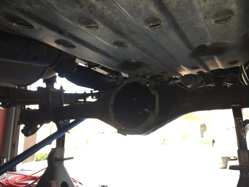

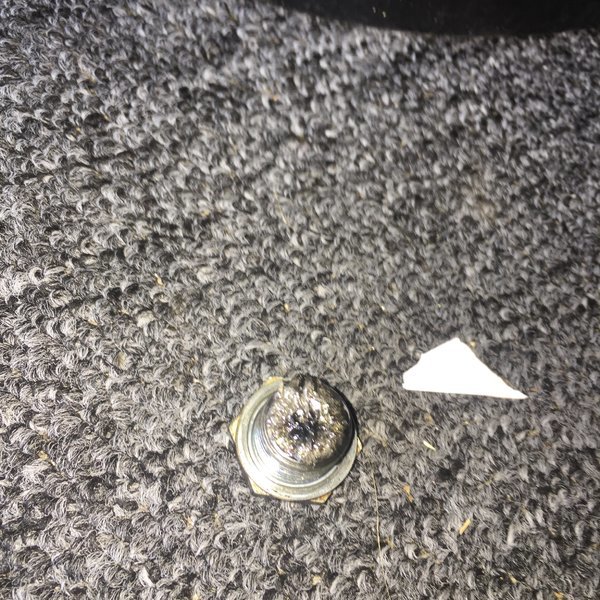

    Half way to work I stepped on the gas from a stop light heard a big ass bang and then the sound of something spinning metal on metal as I now coasted thru the intersection. Pulled over and got out to take a peek underneath and didn't see any fluid leaking. Was getting ready to call AAA for a tow then in a moment of clarity I thought WTF lets try the locker. Turned it on and it started driving like nothing was wrong with it. Ended up just continuing to drive to work for the day. Drove home later rested up for the night and at 630 am this morning started tearing into it. Pulled both axles only to see some fucked splines on the left axle shaft. Pulled the 3rd member out, ring and pinion look good...but I was not able to tell what happened on the inside. So its was time to give the axle and the 3rd member to the pros at Yotamasters in Corona.
    The good news is I finally get to regear my truck with a 4.56 ring and pinion. Bad news is its probably gonna cost me double what it normally costs.
    Updates when I get everything back from Yotamasters.
    Little bit of shavings on the drain plug

    She gone
    Really worried that the axles only had that little of engagement

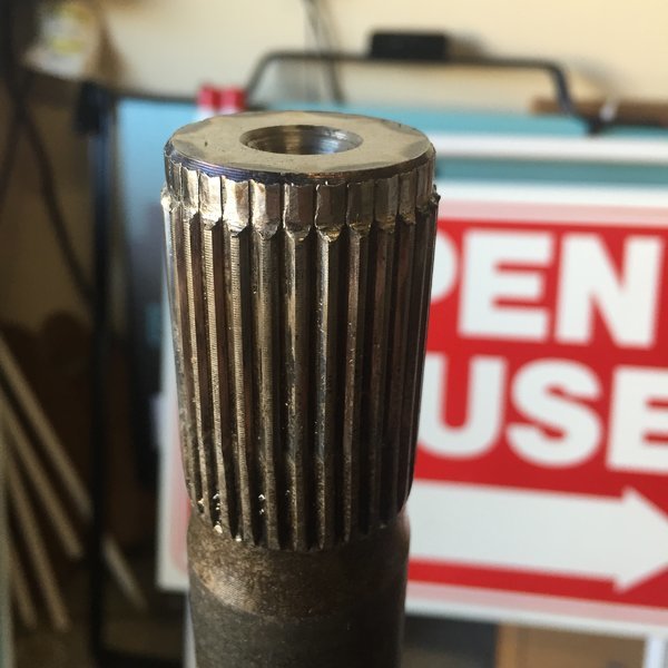

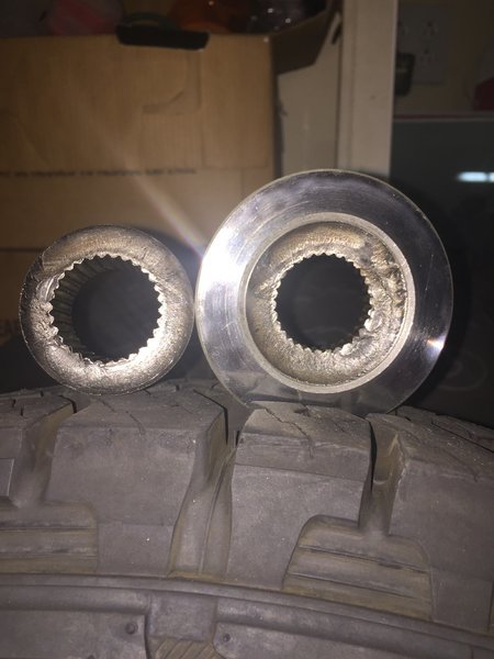

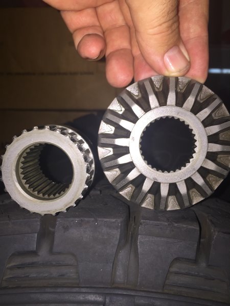

    Pretty sure it has something to do with the locker. There was plenty of engagement but there is some other pieces (locker stuff??) deeper inside where the splines sheared off.

    Here is the broken differential side gear (spider gear.) It is supposed to be 1 piece
    Here's the other side just to see how perty it is.....still not supposed to be 2 pieces
    Just for shits and grins...here's the locker off
    And Locker On

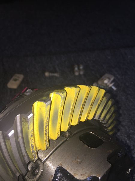

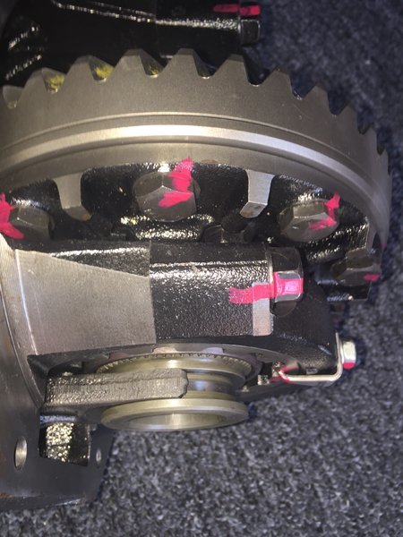

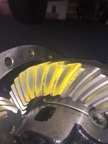

    Some pics of how the pinion engages on the ring gear. I am assuming that this is correct because this is the reason I had Yotamasters do the work because I am clueless as to how to set up a diff. Sometimes i don't mind paying the experts.
    The other side :)
