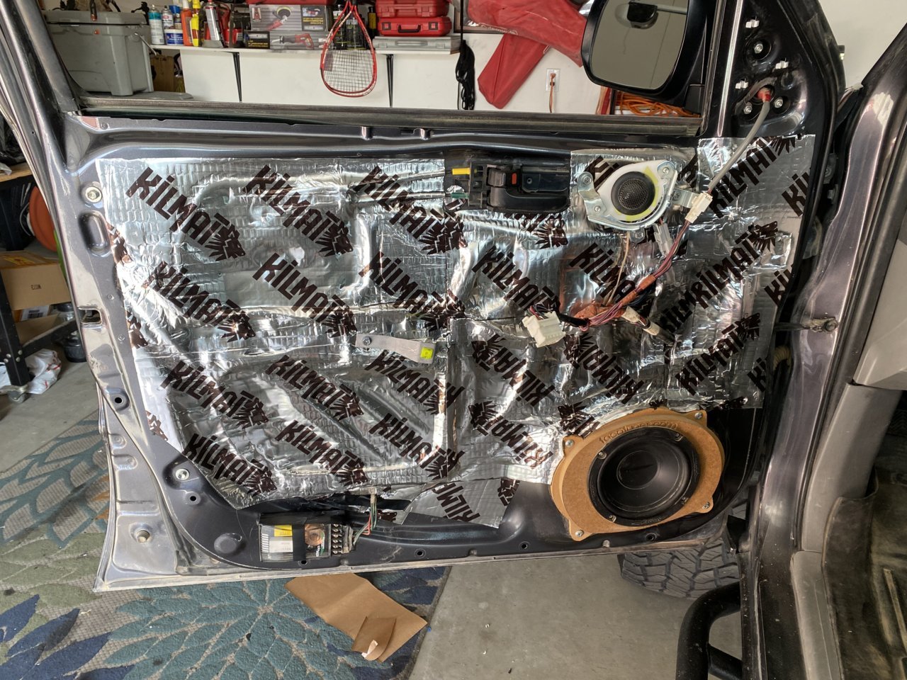

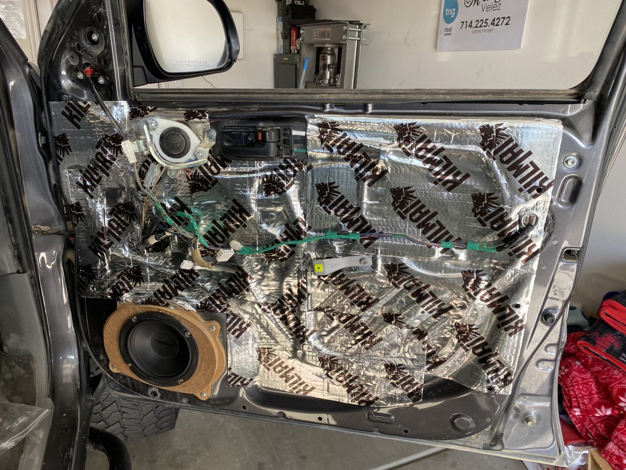

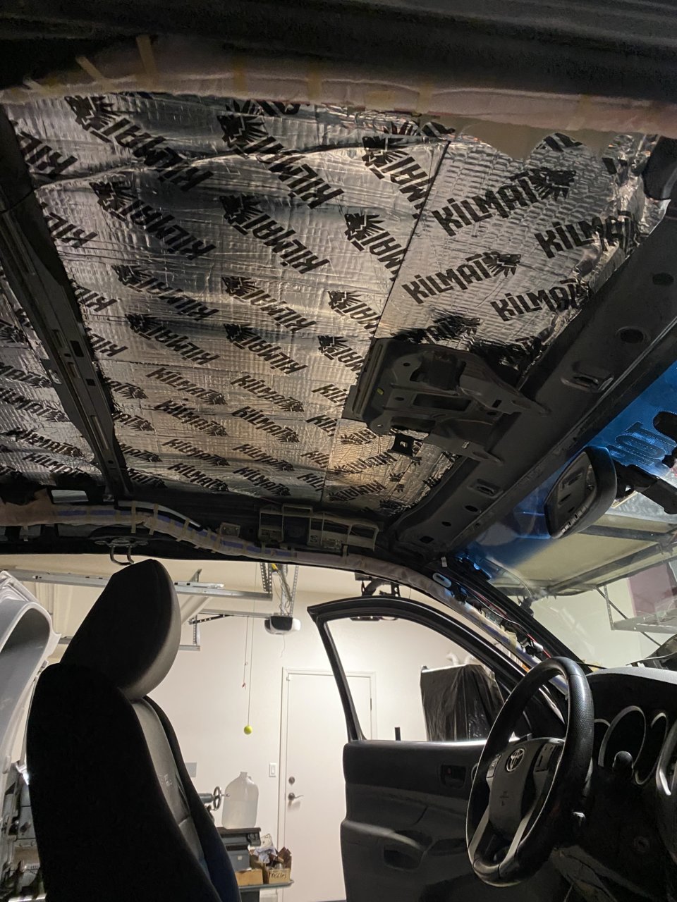

    Did a few upgrades

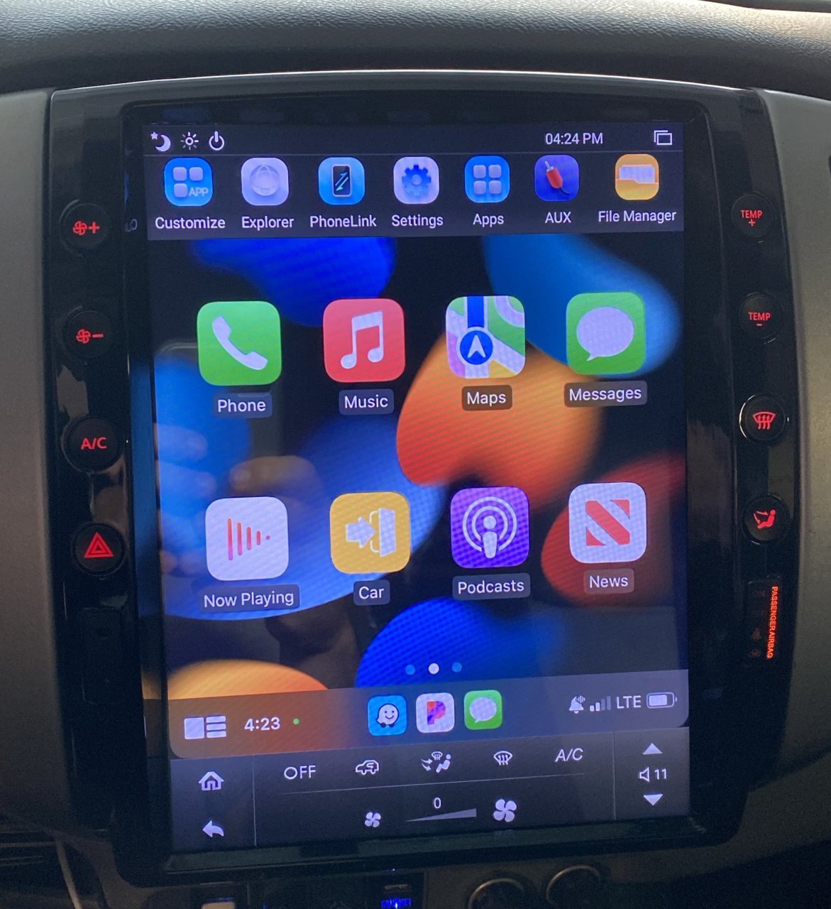

    New Headunit from aucarauto.com 12 inch screen deletes the AC controls and puts them onto the touch screen or use the buttons on the bezel.Has wireless apple carplay or android auto. It is completely plug and play with the OEM harness..JBL and non-jbl.

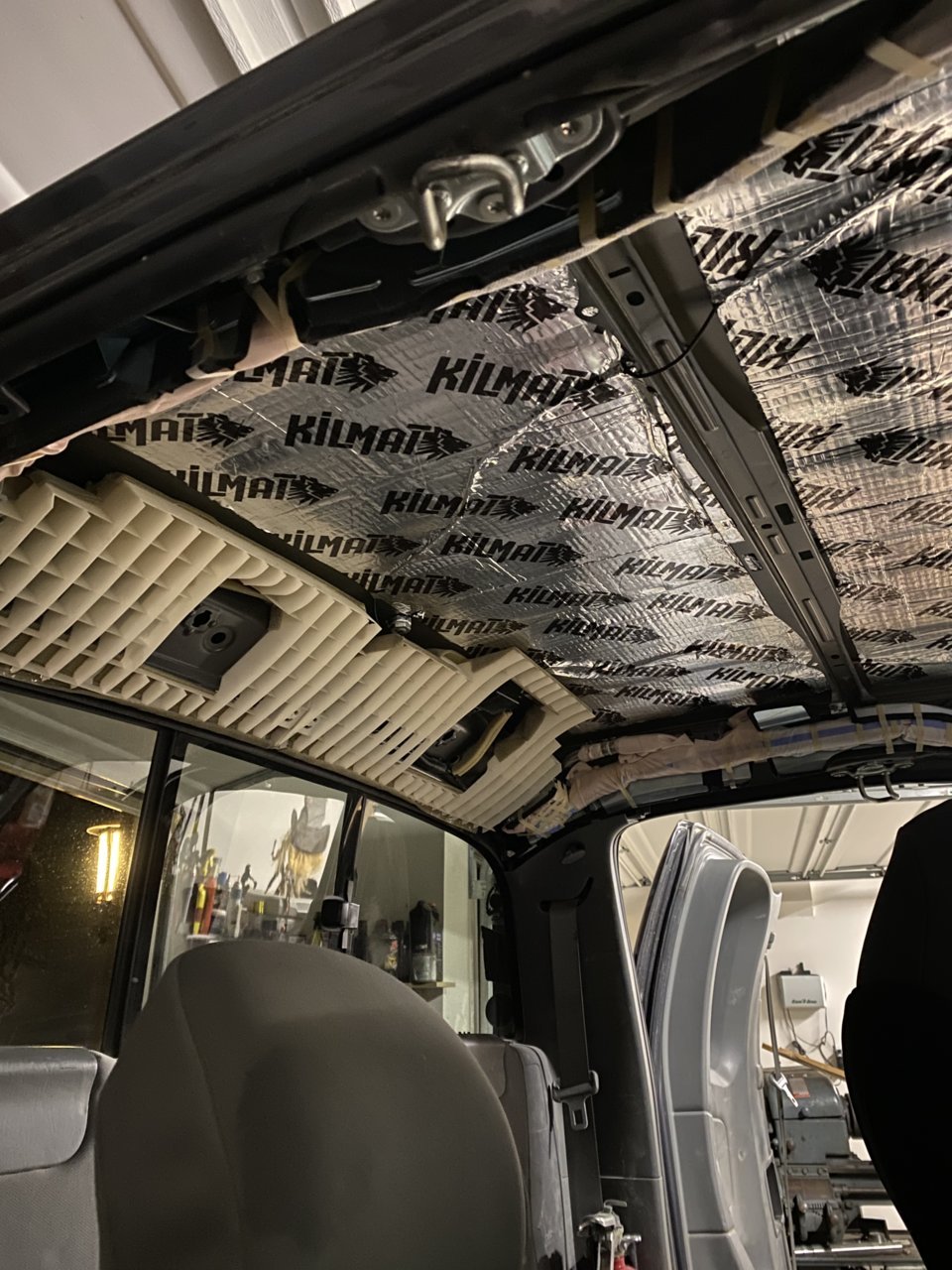

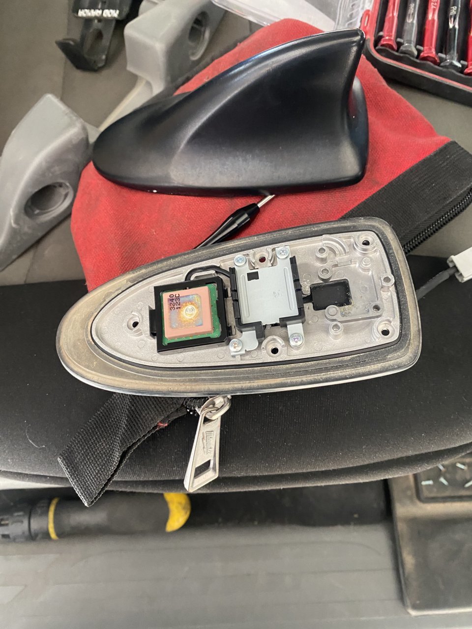

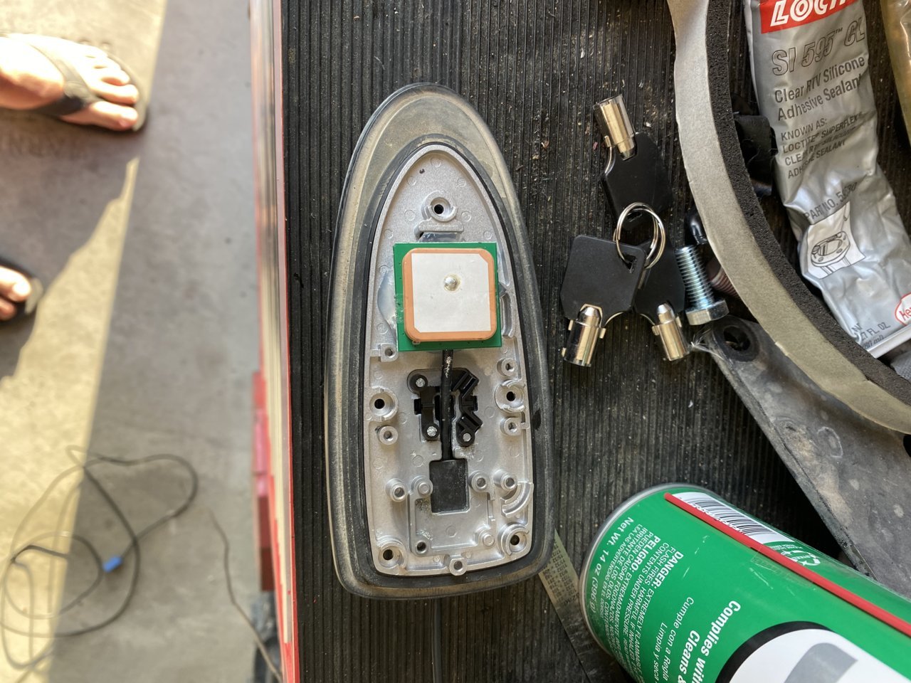

    The radio comes with a GPS antenna but I wanted to use the sharkfin that came on my truck. Sadly the 2012 only has an XM antenna in the fin...so I removed it and glued in the antenna that the headunit came with after breaking it out of its little case. Since I removed the headliner to run the GPS antenna wire from the headunit to the shark fin I decided to put some kilmat onto the roof. Turns out 25sqft of mat will do the roof and 2 doors.
    XM antenna in the shark fin. As you can see there is a provision in the fin for a GPS antenna....just not installed into a 2012 shark fin
    The new GPS antenna glued into the shark fin housing
    Kilmat install
