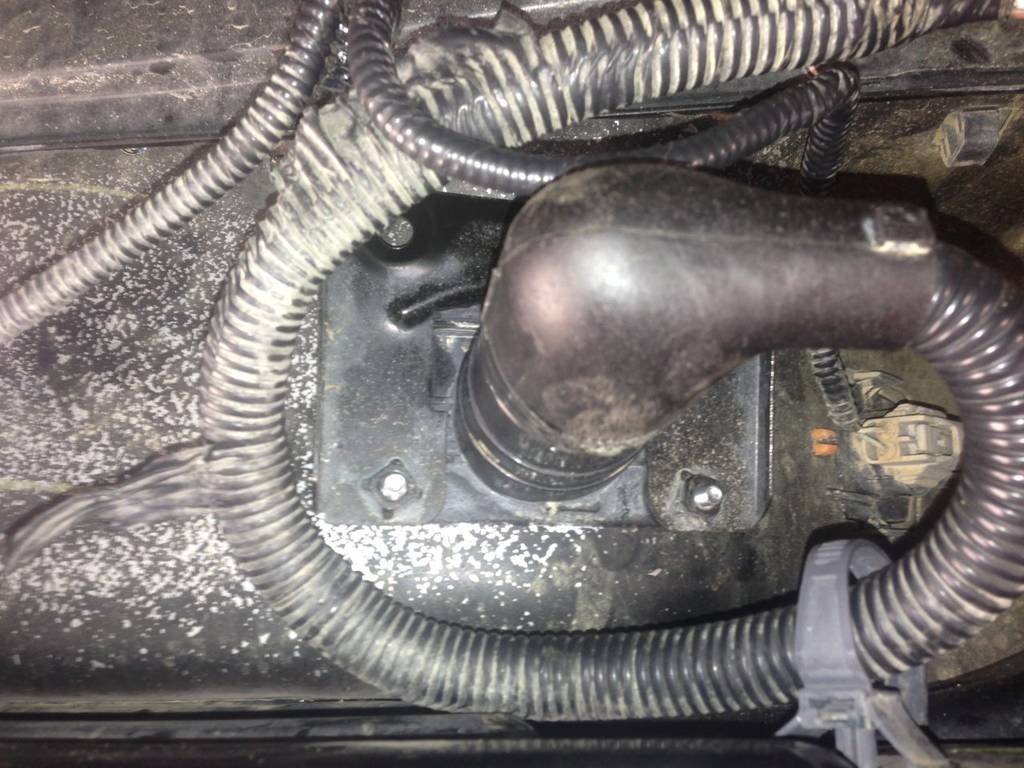

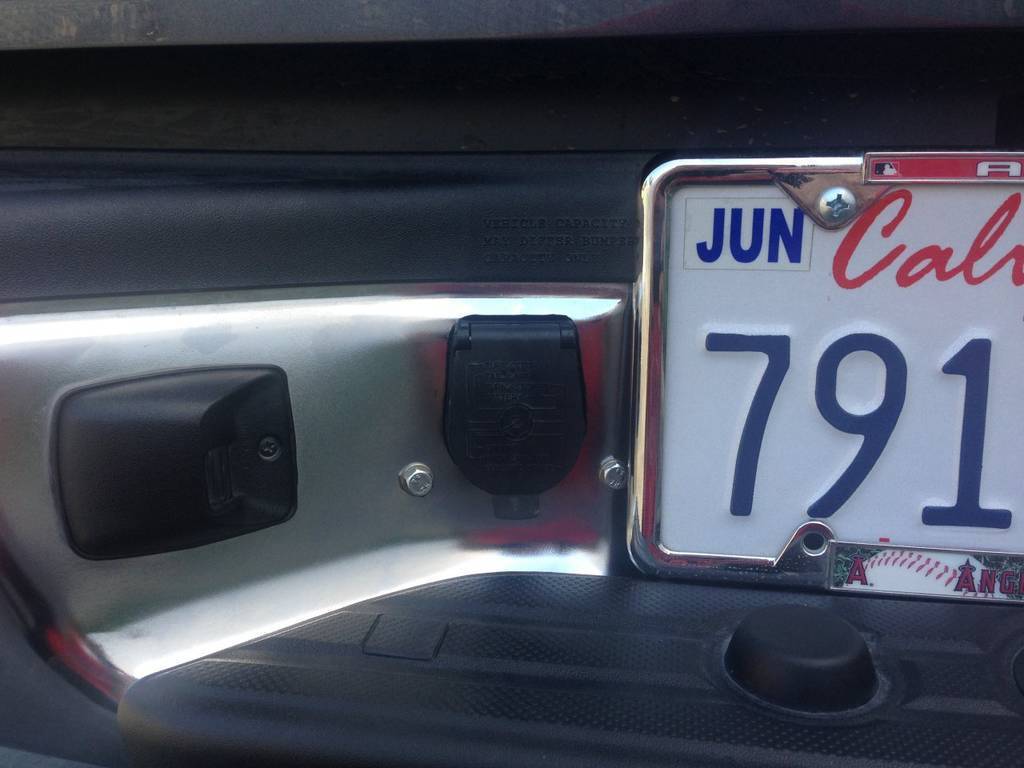

    Did the trailer harness relocation since I hit the crap out of it on my last offroading trip.
    Here is a shot of the back side. I decided to use the stock existing bracket to hold it in place. only downside is the bolt heads are exposed on the outside of the bumper. Does not bother me at all and i plan on getting a HC bumper soon anyways.

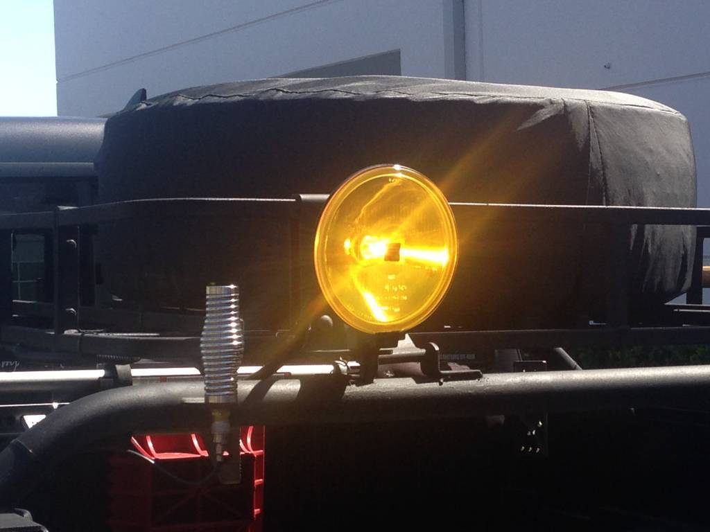

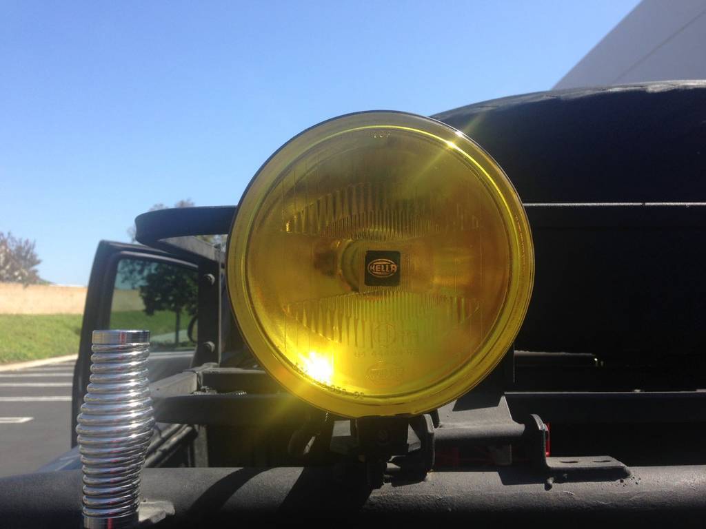

    Also painted my dust light lens with Duplicolor metalcast anodized Yellow paint. I have a yellow H3 bulb in it but wanted to yellow it up even more. Worked like a charm.

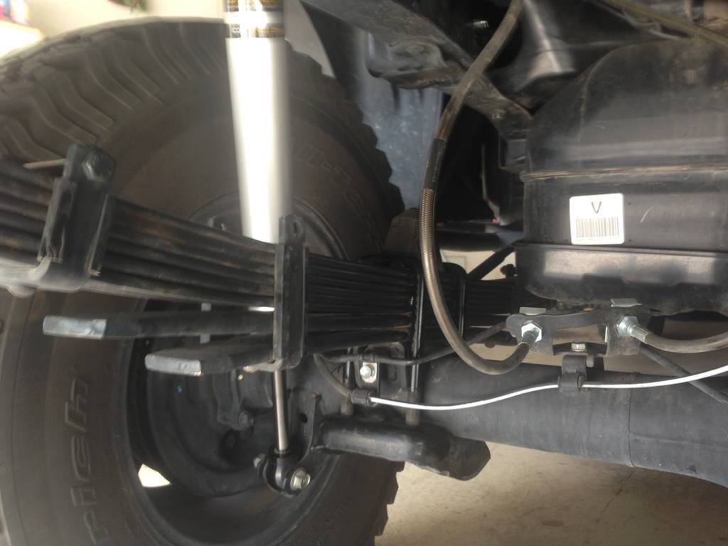

    I just added the D29XL leaf to my Dakars. I am now measuring 25 3/4 center of the hub to bottom of the fender. Fronts are at 26 from hub center to bottom of the fender. Couple of pics:
    Right Side
    Left Side
    How she sits now

    Hey Ryan.... Took me about an hour and half by myself didnt strip out shit and used the same centering pin. All I can guess is that the Dakars must come with better grade centering pins and i was wrenching on them pretty hard to tighten them up. So not all AAL's are bad :)
    Should be getting my ubolt flip kit any day now. Gonna wait to put them on when my Wheeler bumps show up.
