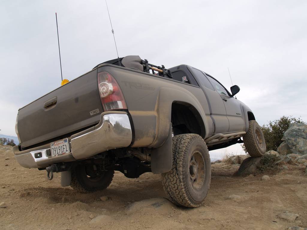

    Ok here is my idea flexin the suspension in order to figure out the height my bumps need to be at.
    1. Head to the dirt. I'm likin' the 2 tone paint job there
    2. Find a big rock to climb
    3.Crawl underneath and take a picture
    Well as you can see from the pic. There is about 1 inch of shock travel left when the bump first makes contact with the bump plate.
    I'm thinkin that a 1 to 1.5 inch spacer underneath the bump stop should be good. the leafs are close to being flat here...probably should have takin a better pic. I'm sure if the shock travels that extra inch the leaf would be completly flat.
    Anyone else have an opinion here on what they would do from this point??
    I ran from Lake Elsinore all the way up Main Divide to Santiago peak and down Silverado canyon today. The front bumps are soooo much better.
    Aired back up here and drove home.

    Supposedly the rear bumps are different from the fronts. More dense from what I read so there is less compression. That vid only shows the fronts.
    The picture is deceiving as far as the arch goes it is not quite flat if you see it in person.

    Oh. I just showed the video for the fronts because I thought the rears were made out of the same material.
    So are you gunna raise the bump stops a little bit to protect your super gnar gnar icons? :p

    In the pics you look like you might be right on. There appears to be about an inch of shaft remaining and the leafs could flex more without too much frown. I can't imagine those bumps compressing more than about an inch. Throw one in a vise and mash it, see how far it goes

    What a brilliant idea!!! Tomorrow the bump gets the mash test! Well tomorrow night at work. I don't have a vise here at home big enough to do that. But the bonus of doing it at work is if I need a spacer I can machine one right on the spot!

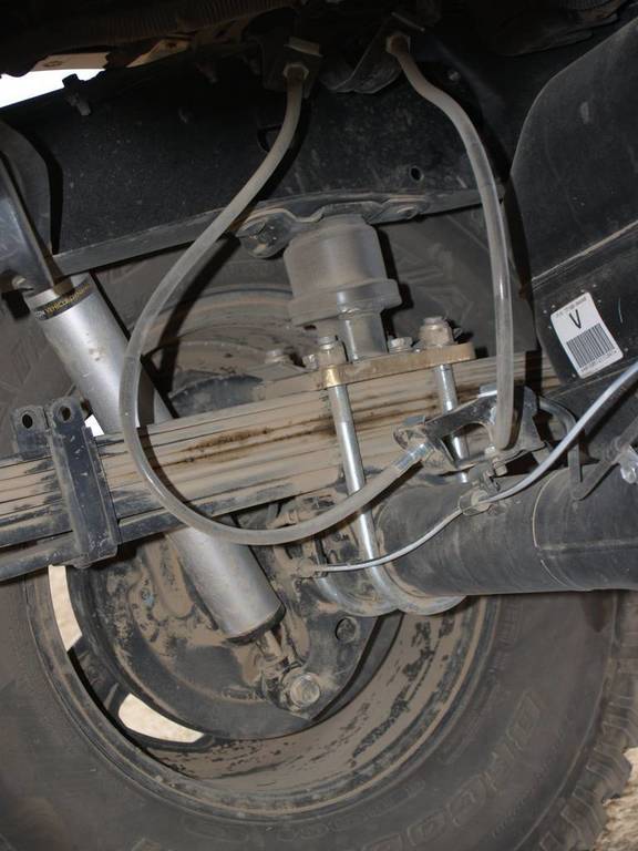

    Hey did you do the same with the oe bumps? If so do you have any pics?

    sure did...pics are on page 6 of this thread or here
