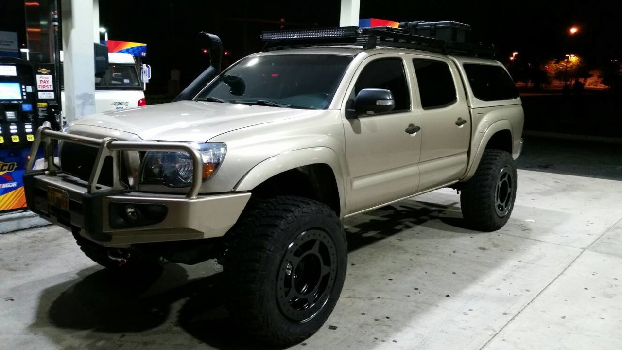

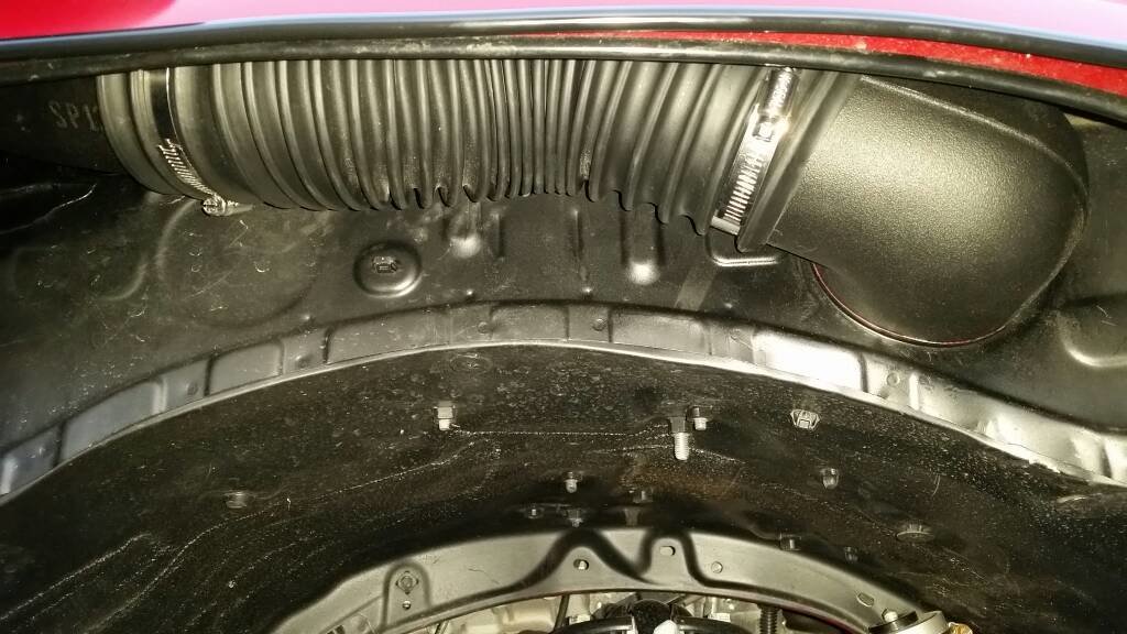

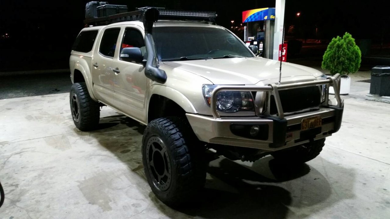

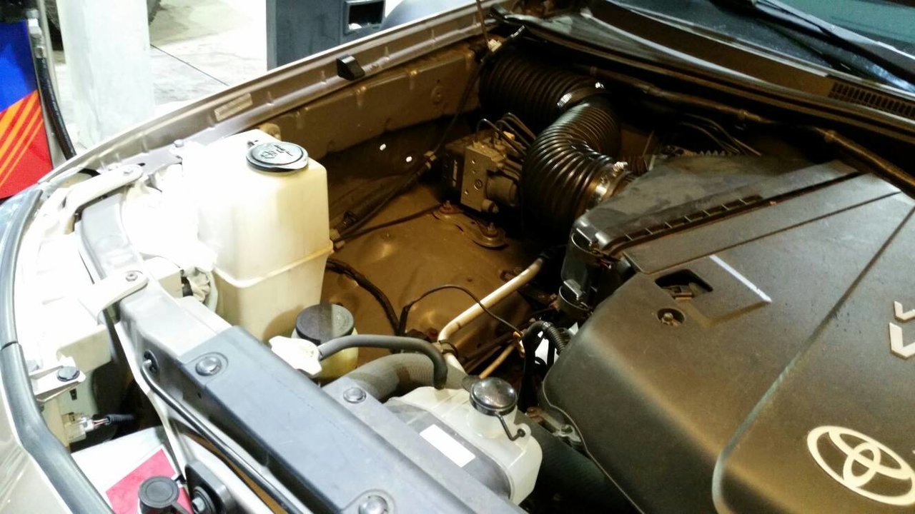

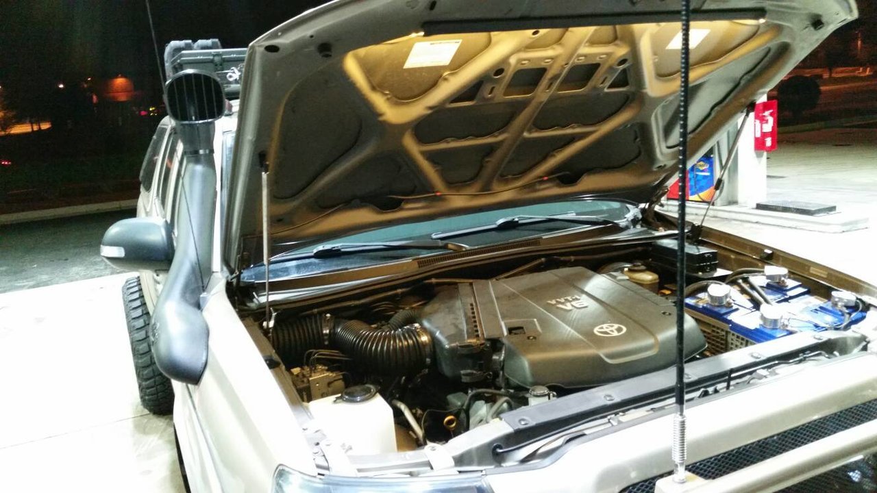

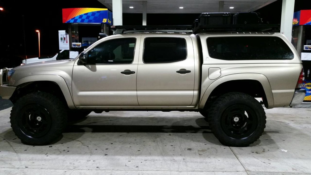

    You turkeys.

    Looks like you took out that air box dohicky. Do you have diiferent low point in that connector in the center?? If not, I think it'd be a good idea to catch any and all water that gets in there :notsure:

    Plan is to get some aluminum pipe and elbows. Making a custom trap out of that. So like a 30° drop, chamber with holes, 30° up with 60° bend, short straight pipe, into another 60° into the filter

    Nice! I just wanted to make sure it was thought about. :thumbsup:

    So whats going in the new opening? Youve already got on board air....third battery?

    Maybe. Or divorce my dual setup.

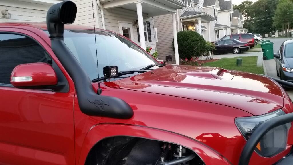

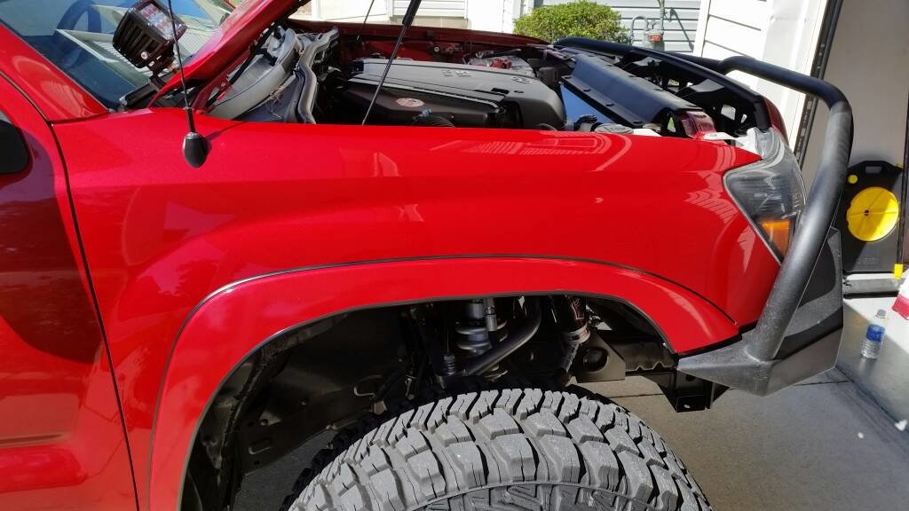

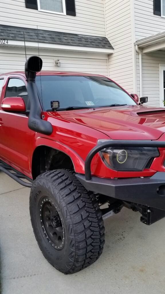

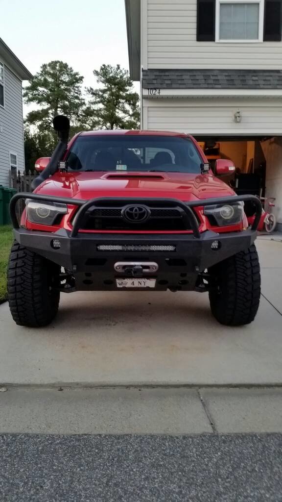

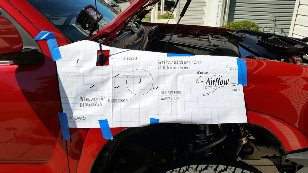

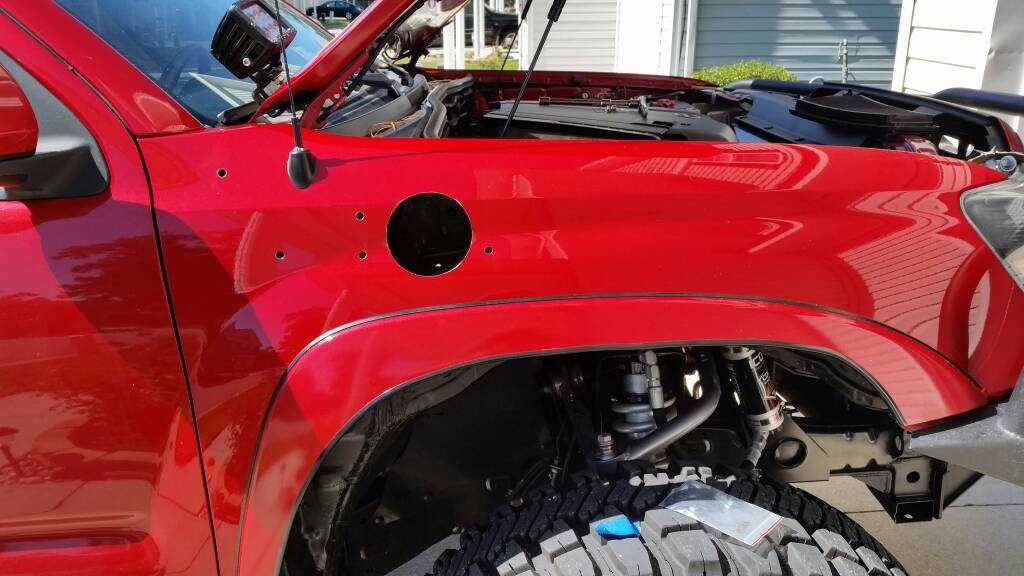

    Interesting. I just installed mine, would have done something similar but it'd be a waste on 12+ thanks to the air pump.
    Side note, I think airflow could have come up with a more finished piece of flex pipe. Was hoping the kit would be more refined.

    I'll grab a pic tomorrow of the air pump and stuff :( Takes up a ton of room! You have much more room for activities. Great spot to mount a nice manifold and locker valves, regulator all that good stuff.

    Still looks great
