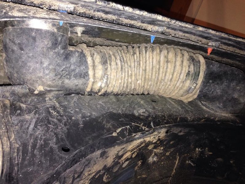

    There is no routing under the hood different from the factory, its all in the fender well.

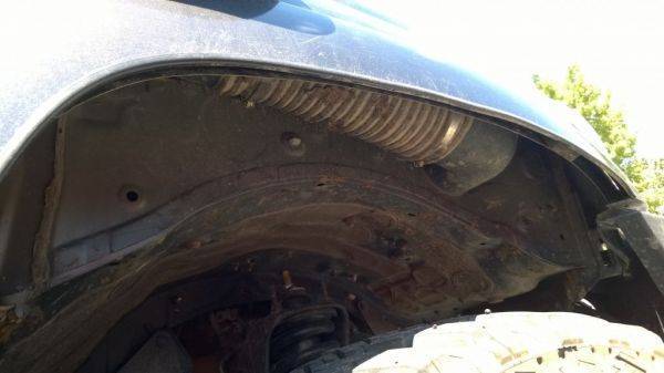

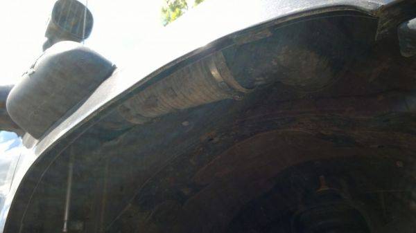

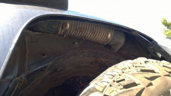

    Are there any photos out there with the tube routing inside the fender wall? wondering how low it sits compared the the bottom of the fender

    I didnt take pics at that point but it sist pretty snug doesnt hang at all

    I can take one when I get off work if you want.

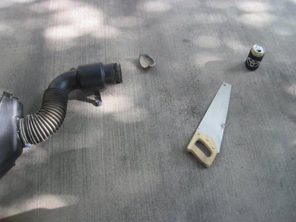

    Do you need the factory intake tube for this to work? Currently I have the 1st gen trd intake and the main intake tube is different than the Oem one

    It is intended to be plumped to the OEM intake with the scoop cut off.
    Edit: the OEM piece slides into the Airflow tubing with some silicone and then tightened down with a hose clamp. You could probably change out the attachment to fit thought.

    This is with 2.25" cut out of my fenders. The lowest point of the plumbing is still probably another 2" above my fender cut.

    ckeene beat me to it but I took them so I'm sharing them :)
    I have 2" cut out of my fenders

    Exactly what I was looking for. Thanks guys!!! About to cut 1.5-2'' off my fenders and was just hoping it didn't hang too low.
