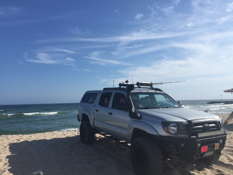

    Are floor mats a mod?
    What front bumper issat? Isss Purdy!

    CBI Moab 2.0

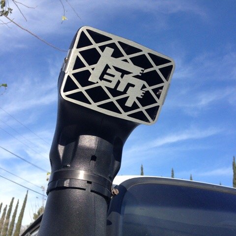

    Anyone know if the Safari tops work on these?
    Before anyone gets their panties in a wad, it's because of this:

    The ram is specifically engineered to work with the rest of the product so I wouldn't put an ARB on the airflow. If you want one for the airflow, have someone with a CNC make one for you. Though it looks like it impedes air flow so I wouldn't use one.
