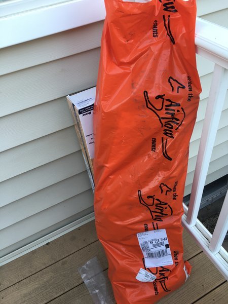

    Mine should be here within a few hours:fingerscrossed:...Installing tomorrow also

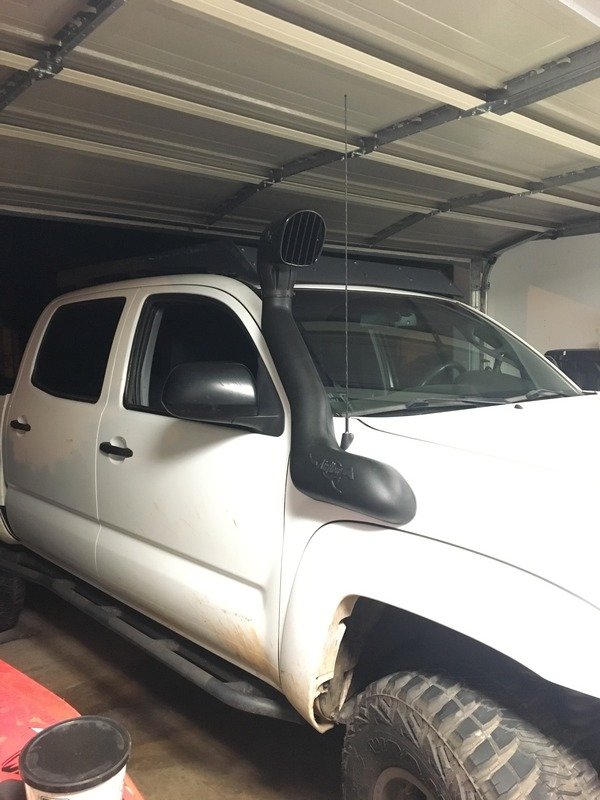

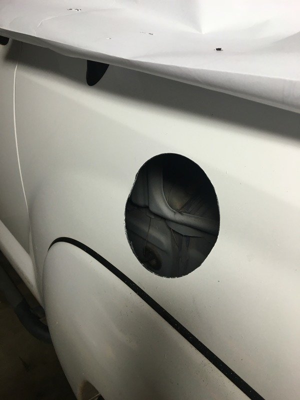

    Installed mine last night. I'm not too impressed with the hardware, instructions, and template quality. Seems really half assed to me. The brass screws in the snorkel go straight thru the plastic. The studs you screw into the brass screws all needed to be filed due to slag left from being cut. Template was way off. Ended up drilling the big hole, and using grease on the studs to mark the other holes.
    For the butyl mastic, I am a huge procrastinator and didn't order anything online. So, when my shit arrived yesterday I absolutely needed to put it on lol. Trying to find butyl mastic is insane...the Home Depot and lowes guys looked at me like I was speaking Chinese. Ended up using mastic tape to seal it up. You need this shit because the snorkel fittings are horrible and will leak without it.
    Just my .02¢. Overall pretty stoked. Thanks again mahalo taco.

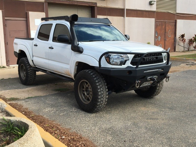

    New profile pic:
    B0BF7A02-A0CC-41F5-9330-D4718E97B317_zps_c1637650fa3a1103106abe9b3c630893273974d6.jpg

    How long did it take you for installation?
    mahaloTaco[OP] likes this.
  10. Jul 22, 2016 at 12:11 PM
    #1870
    kumz
    kumz Well-Known Member
    May 12, 2013
    #103998
    563
    About 3 hours. Beer consumption time included.

    Did you take the fender off?
  12. Jul 22, 2016 at 12:26 PM
    #1872
    kumz
    May 12, 2013
    #103998
    563
    negative

    couple other notes -
    the elbow that goes into the engine bay is a c-hair too large to fit thru the hole. I shaved it with a dremel and it fit thru perfectly. Im running the clamp inside the engine bay like another member on here stated. Also, be patient when taking the plastic splash guard (fender liner) off. I almost ripped my flare off getting frustrated with them.
    Trim lots of that stupid bracket inside the fender. Its super tight in there. Instead of using the stud with a nut for the upper snorkel bolt, I just used a bolt with the same treads. To me, it was easier to get in and tighten.
    Oh yeah, don't forget to plug the 3 little drain holes in the beginning of the OEM air intake. Youll see them when you take it off to cut the old intake tip.
    Sorry, I suck at taking pictures. Only took 2 the entire time. Was more interested in drinking beer.
    B3943AC1-33CA-49A4-8785-5CC851550168_zps_3b83642d5fceb3398a9733933d0c88b8839664f9.jpg
    4FF1F77B-6DDC-4F2A-ADFA-3FD7C4F6C62D_zps_baf25d130dca44b7c010cfa5a824a2752c986f07.jpg

    Yep. I said to have fun shoving the elbow through the factory inlet hole. :)
