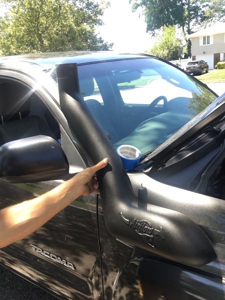

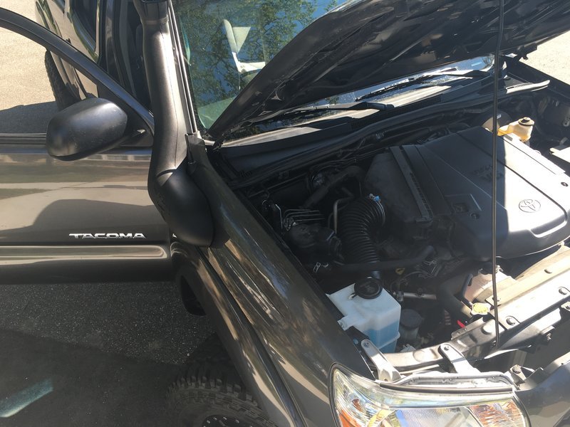

    Got mine installed yesterday. Had a hell of a time with that upper most stud. Lost the washer, but got the nit on it. Also those damn retaining clips for the splash guard didn't wanna come out very easily. If I could have did it differently, I would have bought all new clips and just cut the old ones out. I managed not to break the ones for the fender flares though, I was very careful there. Also couldn't find butyl mastic, so went with black urethane calk instead. Got that stuff all over myself, and it's not easy to get off. I used the heat gun method to pull the elbow through the engine compartment, worked well. The template was slightly off, so make sure that it fits how you want it to sit. All in all, I'm glad I did it, truck looks awesome with it, and my intake will be much cleaner. My intake tube was full of leaves and dirt. Pic for proof of completion.WP_20160724_001.jpg

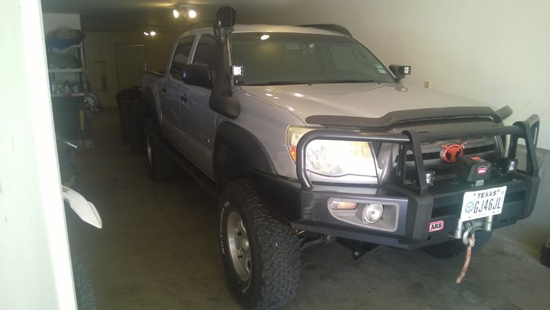

    It all looks fantastic except for one thing...

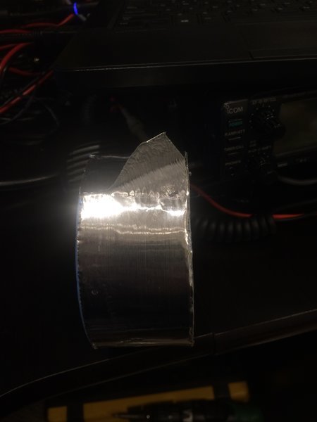

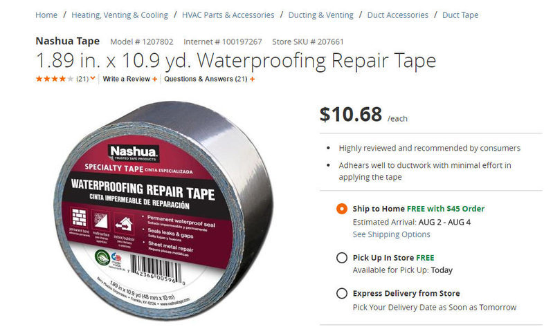

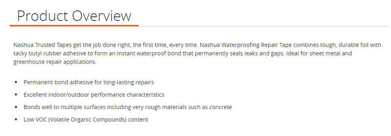

    So I had previously bought some of this tape from Home Depot to seal a leaky exhaust pipe from my gas dryer. It was next to the foil tapes for ducting way against the back wall. HD website Description says Butyl Rubber Adhesive; not certain that this is the product of discussion but appears to be close enough. I may have to fold it over on itself or add layers to make it a bit thicker. The Nashua website is devoid of any tech specs or info. As you can see from the pic, the end of the tape without the anti stick backing shows some very good and flexible adhesion. Anyone have experience or can comment on this? Thanks!

    The butyl rubber is just the adhesive portion of the tape. Although that stuff is great for sealing ducts, I think you'll find that it will be difficult in our application. I used black urethane in a calk tube. I put a bead around the male portions of each tube, and it seems to have sealed very well. I picked it up at Ace where the rest of the calking is. I'm sure HD, Lowes, or any other hardware store should have that. Good luck with your install, cant wait to see the result. Oh and, Hook Em!
