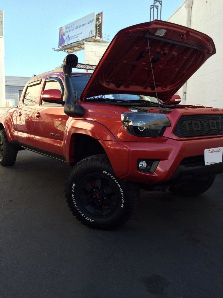

    THIS IS HOW I DID IT AND YES YOU MIGHT NEED NEW FENDER CLIPS

    There is 1 bolt that I didn't get on, the only way (I know how) to get it on is to remove the fender. I didn't install it and the snorkel is still tight to the fender. I also opted to run a bead of silicone along the edge of the snorkel (touching the fender) to keep water from between there as well.

    yea, I've heard the one at the very top is a PITA.

    Yea that one was a stubborn mother trucker,
    but the results are beautiful.
    shes a attention whore

    Ulysiss, that red and black is kicken ass man what size light bar you got on top I am going with a 50".

    I'd say 40 since between the roof rack bars.

    Thank you brother its a 40''.
