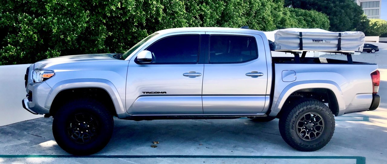

    I go down to 25 on the same tires for forest roads. Makes a huge difference for comfort and less worry about punctures. I'm only a 2WD though, but it helps with traction for sure as well.

    Lifted or stock. Tire size. I like how it looks

    It has Bilstein 5100's at the 1" notch in the front and a 1" block in the back as well as Spidertrax swheel spacers. Its 2WD, not like I'm wheeling hard or anything. Weight of gear seems fine when fully loaded with camping gear. Sits about level. It's well under that vehicle max weight when loaded with gear and 2 adults. Unloaded it has a rake of 3/4 inch, not too bad. I like the level look. 265/75/16 Falken WP
