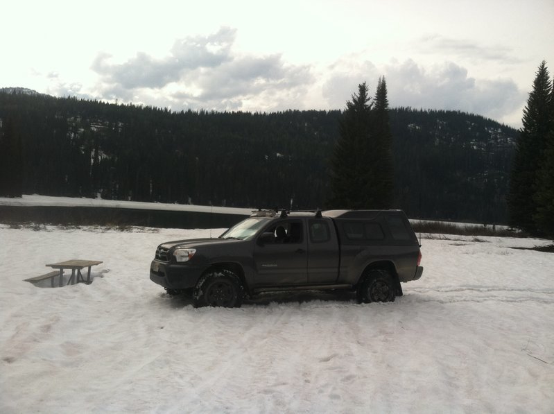

    Many variables. When I was running 265/70/16 p rated tires, 20 was as low as I felt comfortable going even at slow speeds - lots of squish. I never aired my 265/75/16 load C tires past 20, but had lots of room to go for low speed wheeling. Both were before I added on board air. I was already hauling quite a bit of extra weight in the truck daily at that time. I also drove to a gas station, doing the speed limit (up to 60 mph) on both a few times.
    Now the truck is even heavier and is rolling on 255/85/16 load E tires. If I'm airing down for a long day on Forest Service roads, I'll go to 25. If there's going to be much deep snow, I'll go to 15 - I can drive all day on FSRs and feel comfortable at prudent speeds (up to 30mph) at this pressure. If I need more traction or float, I can deflate further (haven't needed to yet) or put tire chains on (haven't done this with 255s yet). If I plan on driving faster, I keep it at 25 because the conditions aren't calling for lower psi if I'm driving that fast.

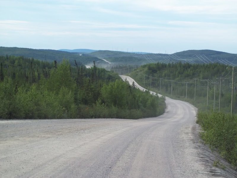

    Also, just to be clear on the safety issue, I drive those speeds when I'm going through clearcuts and places where visibility is at least half a mile. We have dirt roads as wide as highways in some places. Washboards and grip are the main concern.
