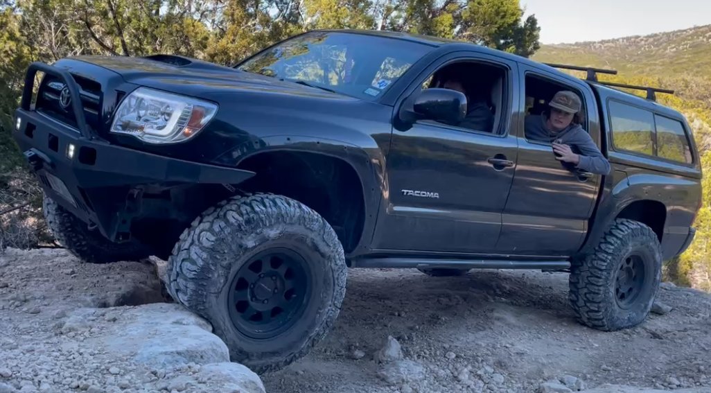

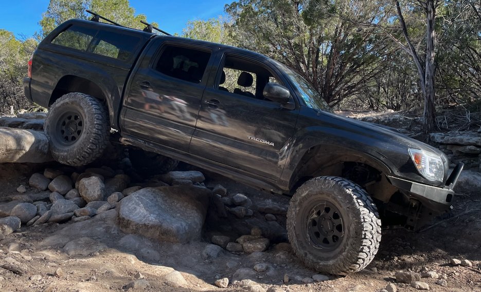

    10 psi (C load Patagonias) - like others, I am also going slow and haven't had an issue. I think I can still go lower if I need to. I also have bead grips. I had load E before this and 10 still felt like too much at times. I guess I'd trial & error if I were you. But why not give 10 a whirl and see the difference. If you're slipping, lower the pressure. If you're not slipping but need more clearance, raise it.

    Yeah! that's the right pressure for wheeling. Those tires are squatting and bulging properly. With that much traction and a calm throttle control foot you will have less problems.
