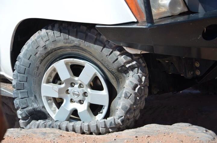

    Yeah I should mention that I do 15psi on rocky terrain with E rated KO2s, I wouldn't be so confident in going that low if I was on a lighter tire

    Being the post whore that I am...with a C rated tire 18 lbs. would be the safe choice, with bead blown danger zone 12 lbs. and under. :thumbsup:
