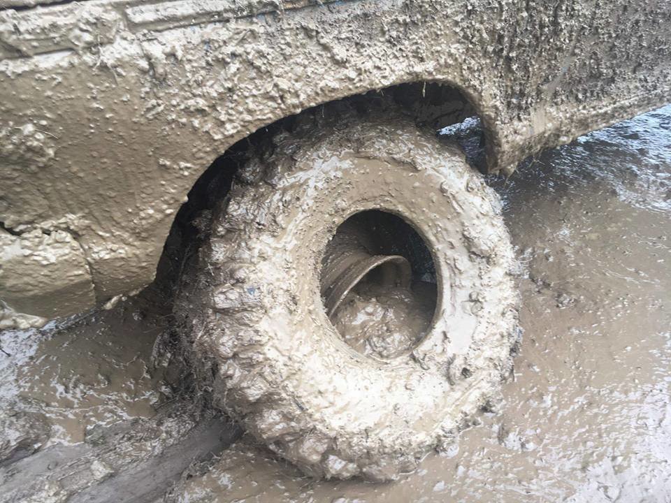

    This is my Ford and what can happen with 9PSI. After this, I ordered weld on beadlock rings. That's a 38" comp cut bogger. I had the 460 wound pretty tight. The guys watching said, "You would have made it if you hadn't debeaded a tire". This pic was after I got pulled up onto "higher ground". When it originally happened, most of the tire was under the surface of the mud/soup/oatmeal.

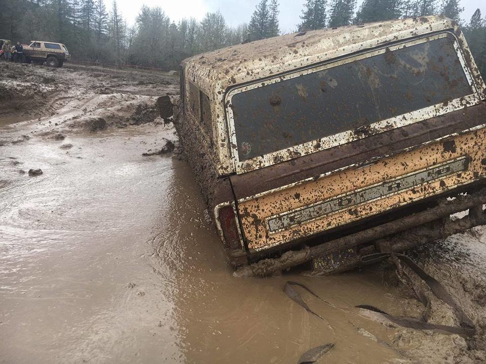

    This is right after it happened. I rolled down the window and looked out. There was no way I was opening the door, and especially no way I was stepping out. I climbed over my passenger and got out on "more solid" ground. When that truck is sitting flat on solid ground, that tube bumper is at about 3 feet.
