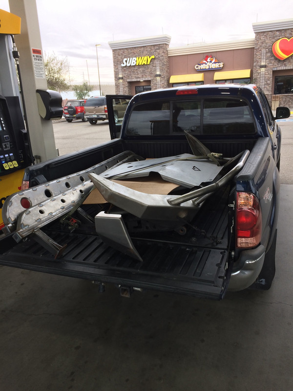

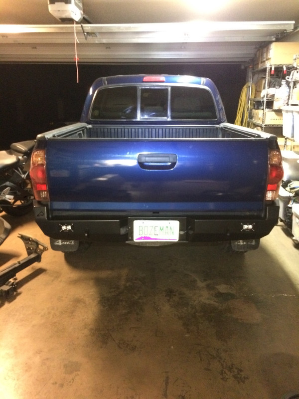

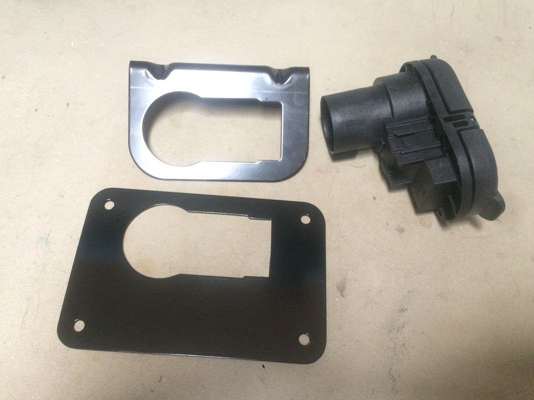

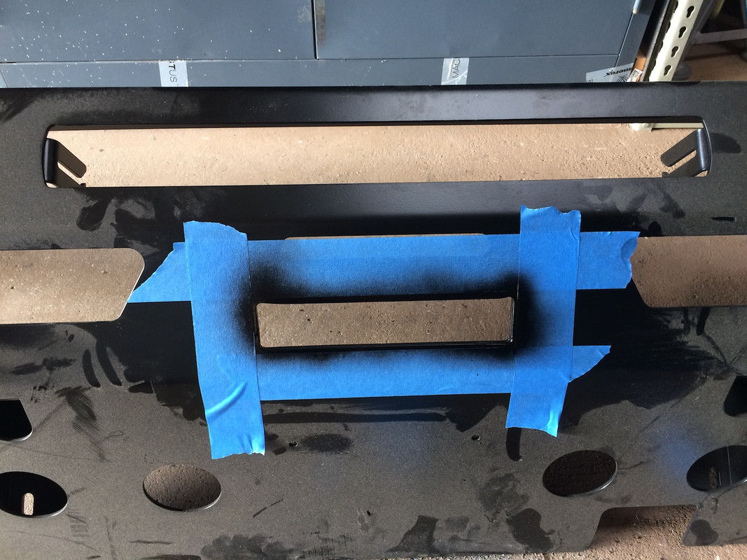

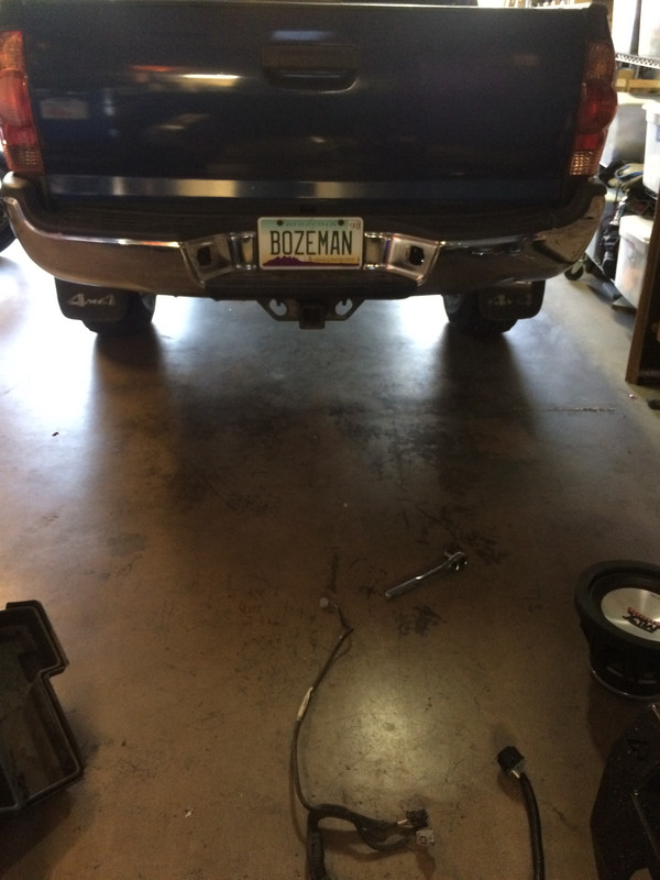

    Rear bumper needed some mods to fit a modern trailer plug. CAD template
    [​IMG] [​IMG] [​IMG] [​IMG]
    Later this will get recessed into the bumper. For now I'm welderless :(
    So off with the old
    [​IMG] [​IMG]
    On with the new
    [​IMG] [​IMG]

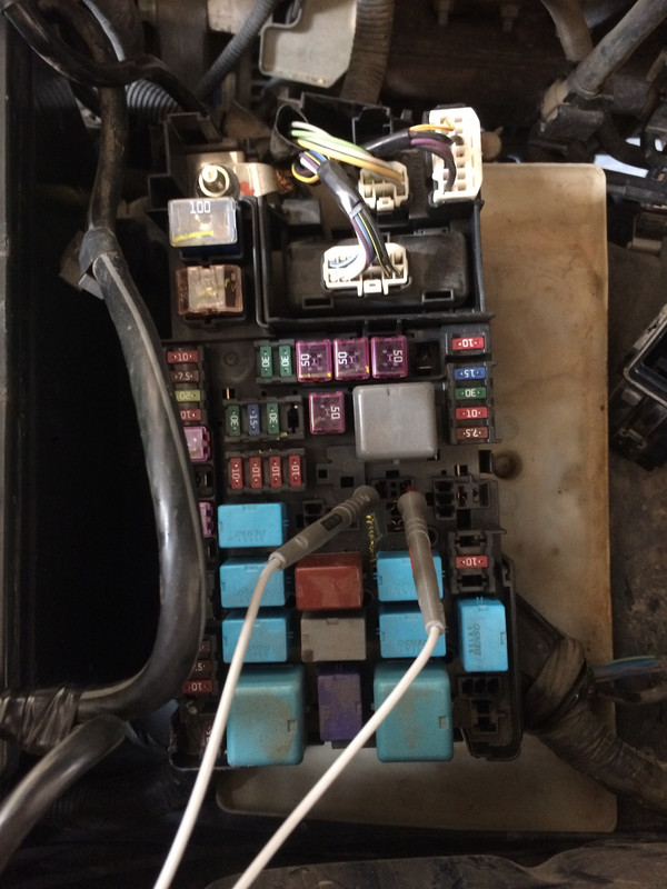

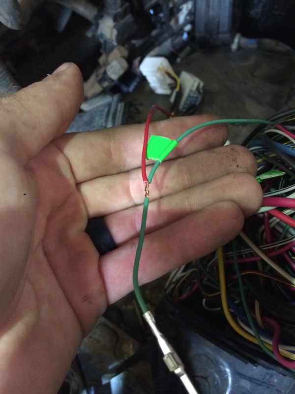

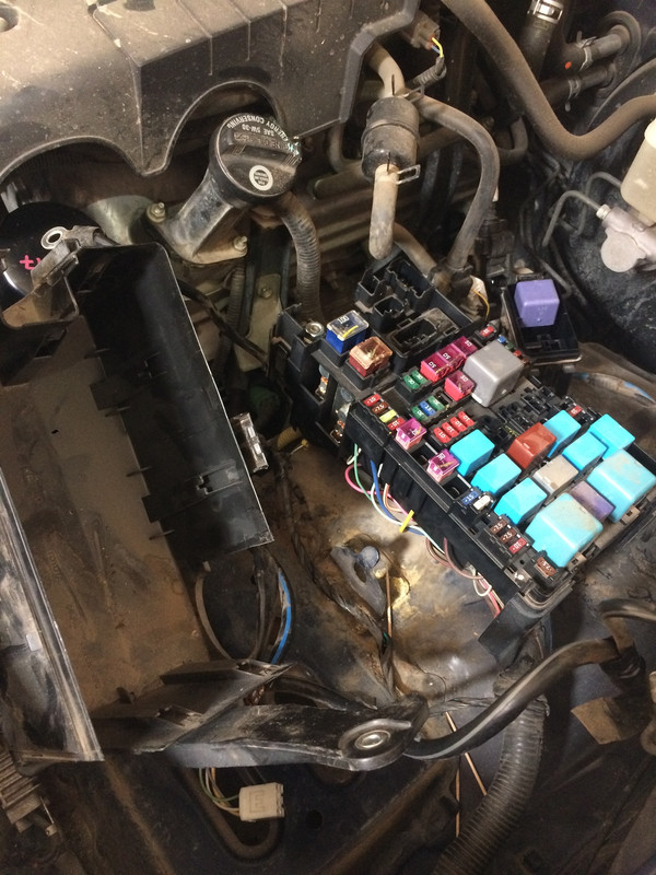

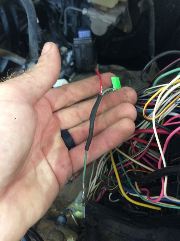

    To prep for front bumpers new more better fog lights I performed a anytime fog light mod. Electrically what I did was as described on this thread but I wanted an OEM look.
    Removed the fuse box lower cover
    Exposes this nest
    Locate the relay pin
    Remove and tap into the ignition on hot wire
    Cut the old relay source and tie it to the ignition hot wire
    [​IMG] [​IMG]
    Test before re-assembly
    And happy with the results
    [​IMG] [​IMG]

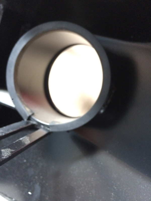

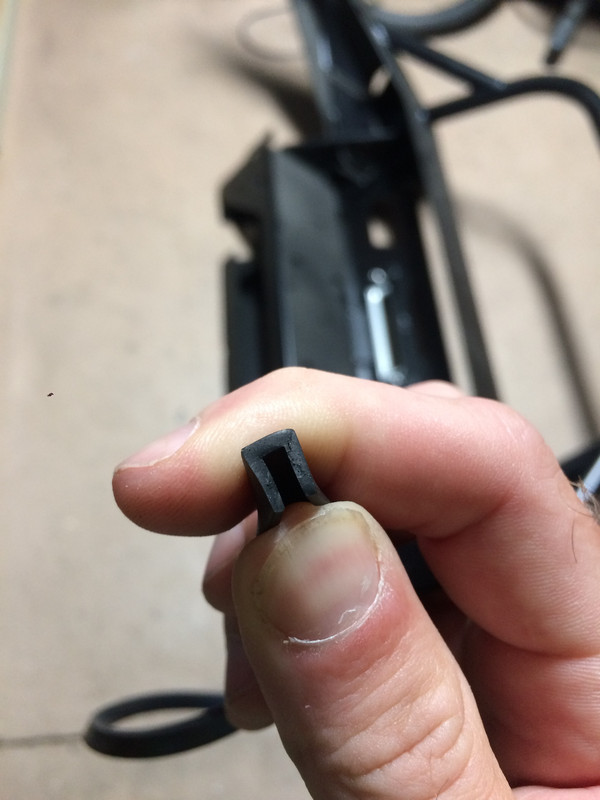

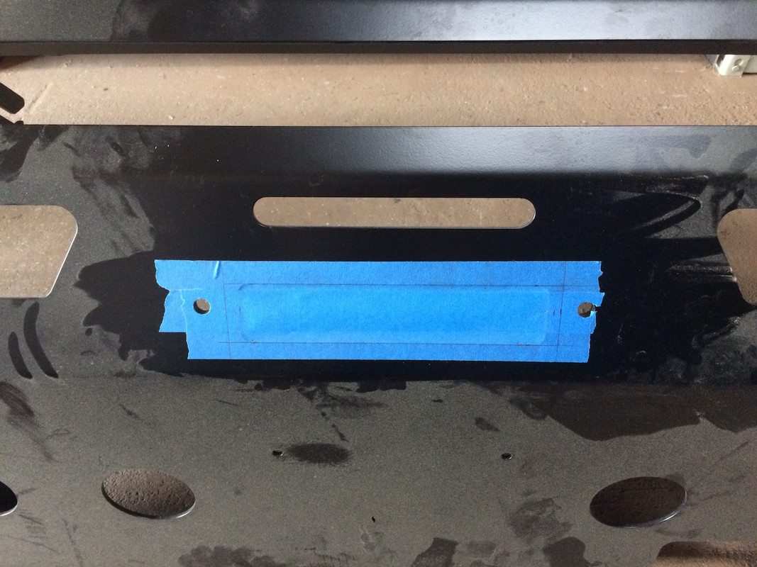

    The front bumpers winch rope hole was too narrow for my fairlead so I cut off about 1/2" from each side. I wish I had all my accessories and test fit them before powder coat but fortunately the powder coater gave me a can of matched touch up paint.
    [​IMG] [​IMG]
    Save more $ and bought the fogs. To keep the light housings from vibrating/rubbing/banging against the bumper I used some rubber weatherstrip from ACE. Sold by the foot.

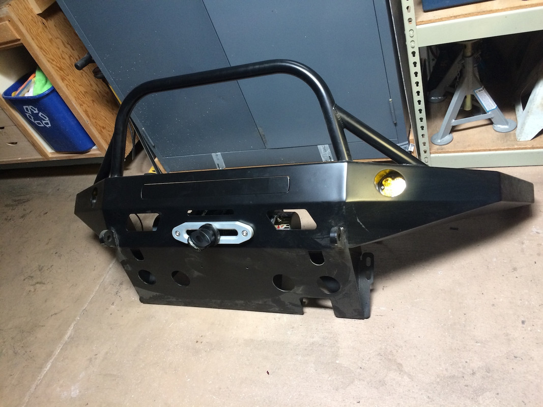

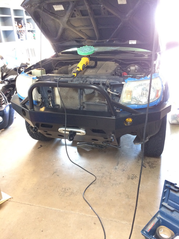

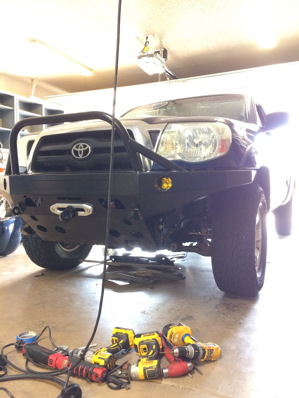

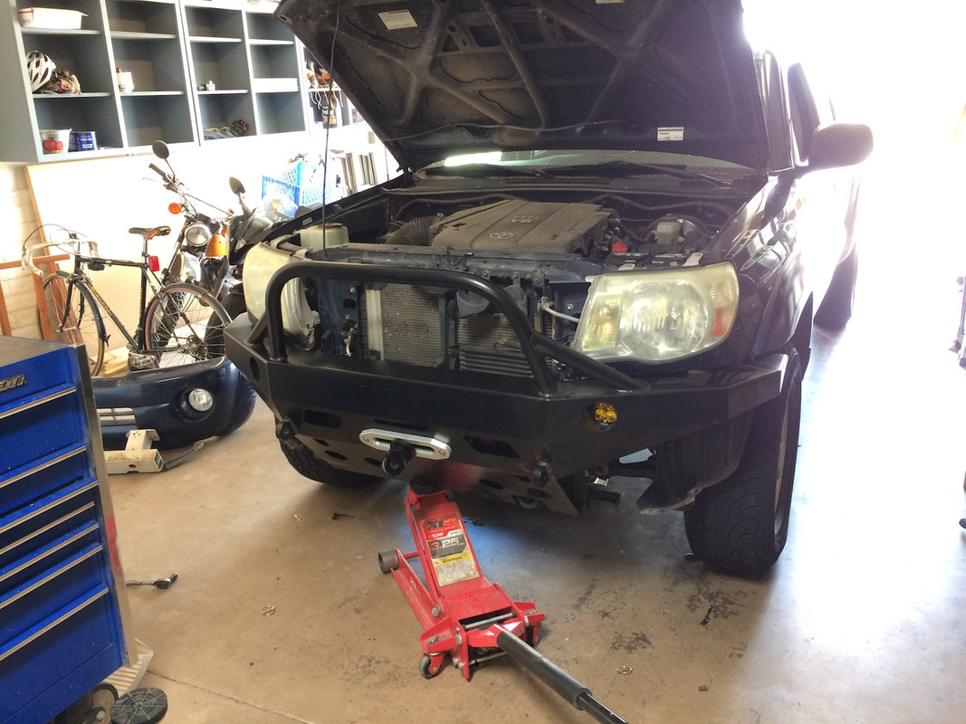

    With the lights in, and winch in, I hot wired it up and spooled line
    Safety squints on, let's get this party started.
    Remove bumper, perform several reps of dead lifts, (remember bar should drag shins). I ended up with 1 washer on the top frame stud to space it and get the tilt right.

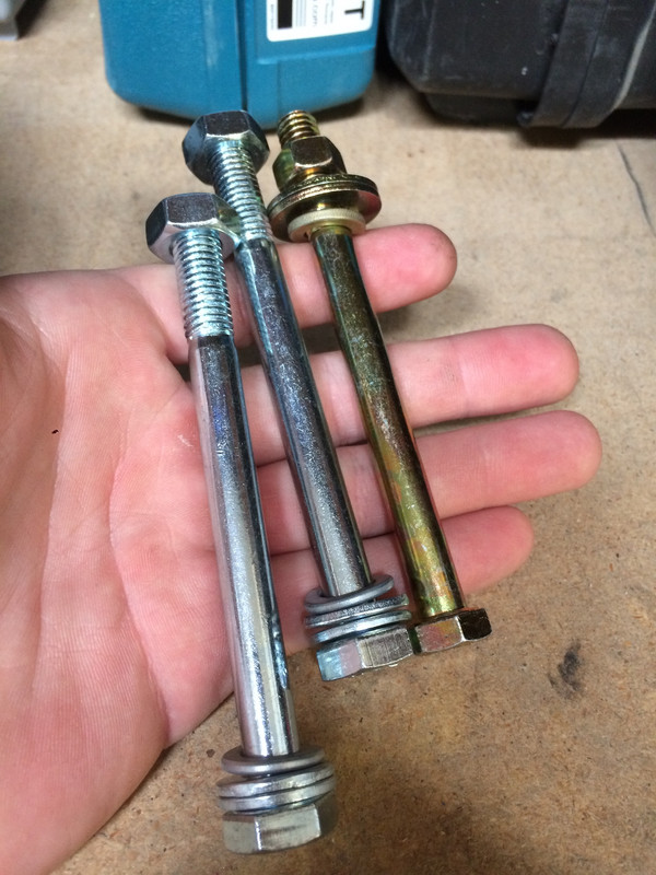

    It annoys me that the bumper hardware supplied is SAE. Eff that; Went and got me some metric. This is a Toyota after all.
    While I'm here I polished up the headlights. Tucson sun beats these to heck
    [​IMG] [​IMG]

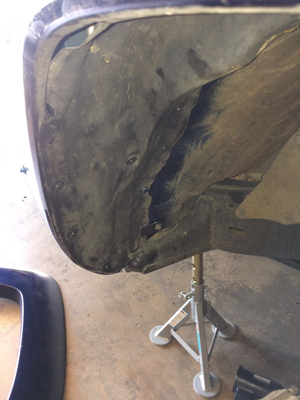

    Figuring out what to do with the inner fender liner. I decided to use a heat gun and form it forward to meet the bumper. Then I trimmed it to fit, installed speed nuts on the fender liner and put screws into it from the bottom of the bumper. I think it turned out pretty clean.
    With the bumper on, I went ahead and installed the IFS and Mid skids as well.
    [​IMG] [​IMG]

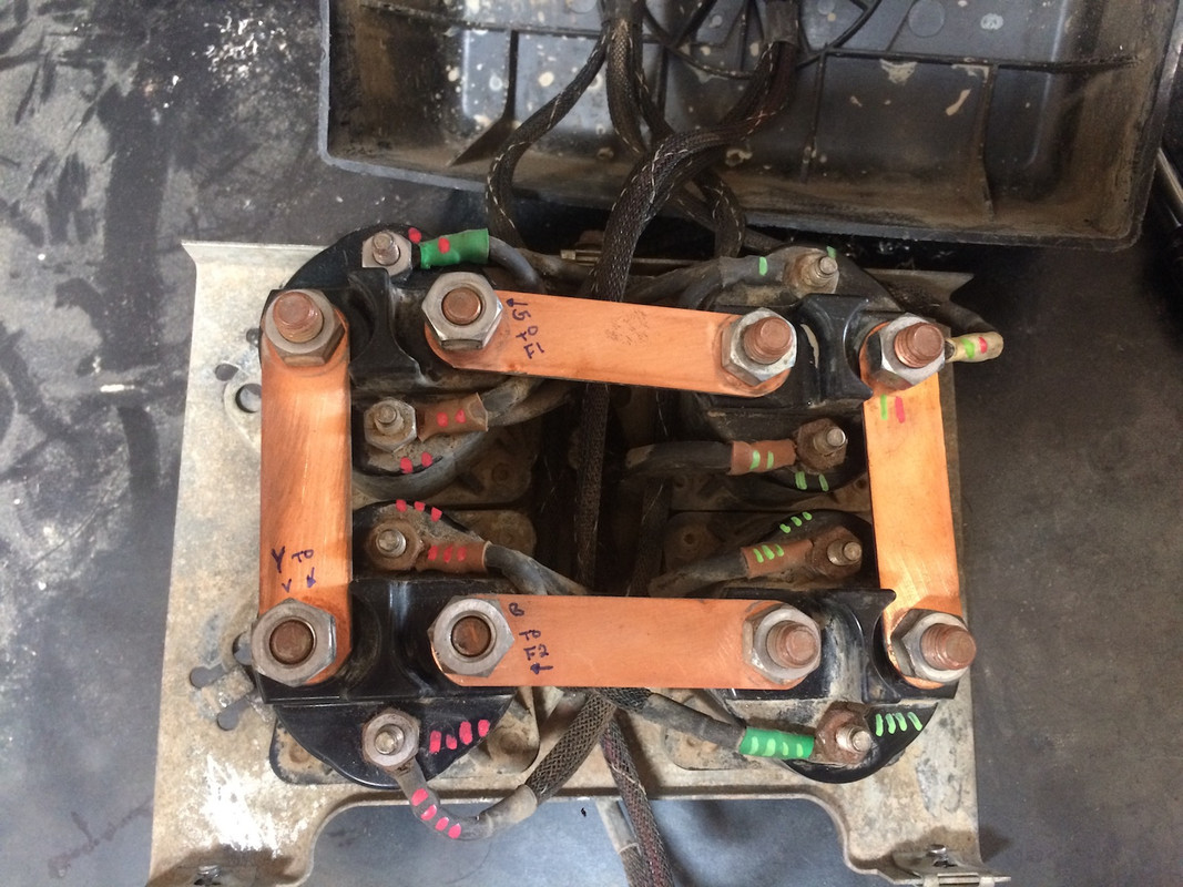

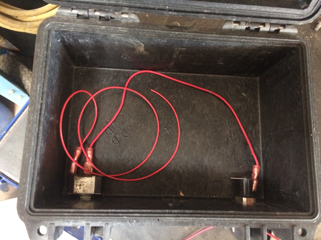

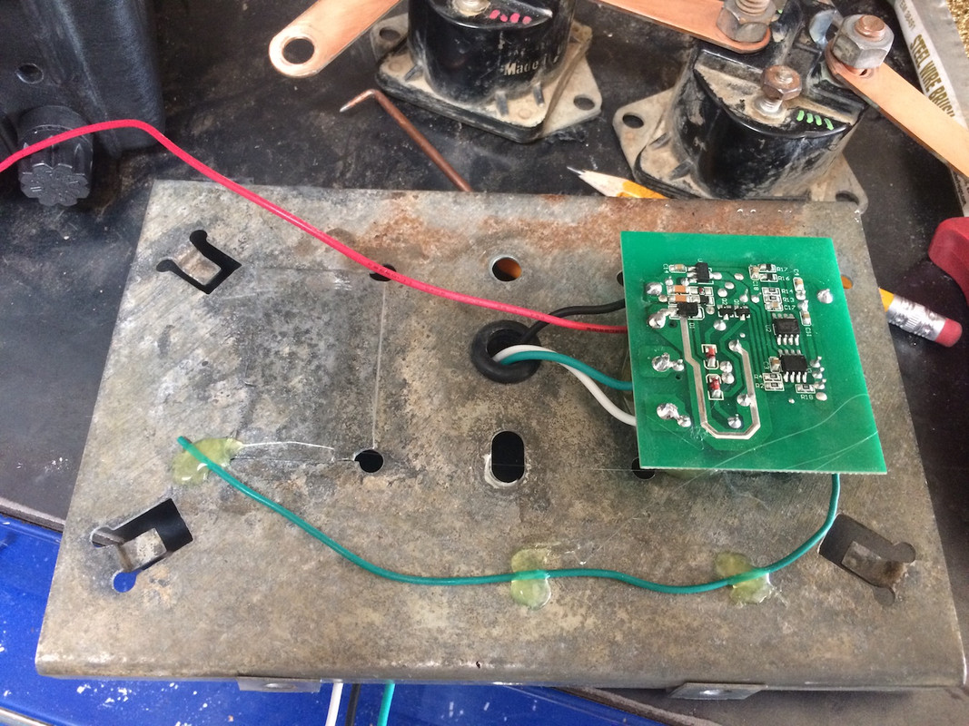

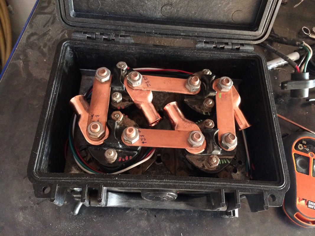

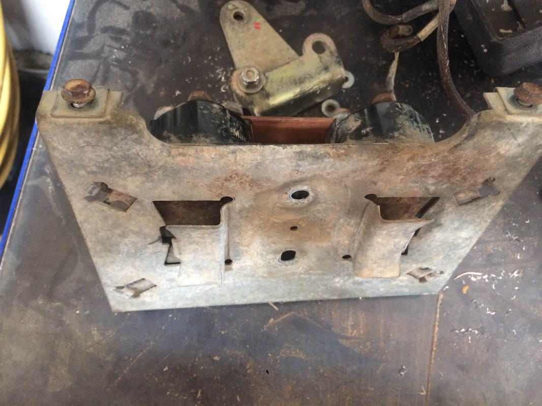

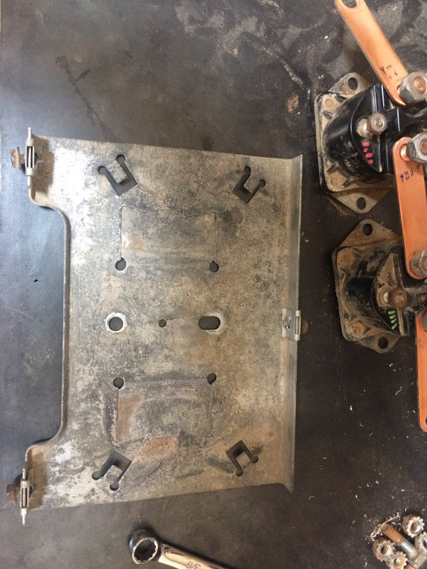

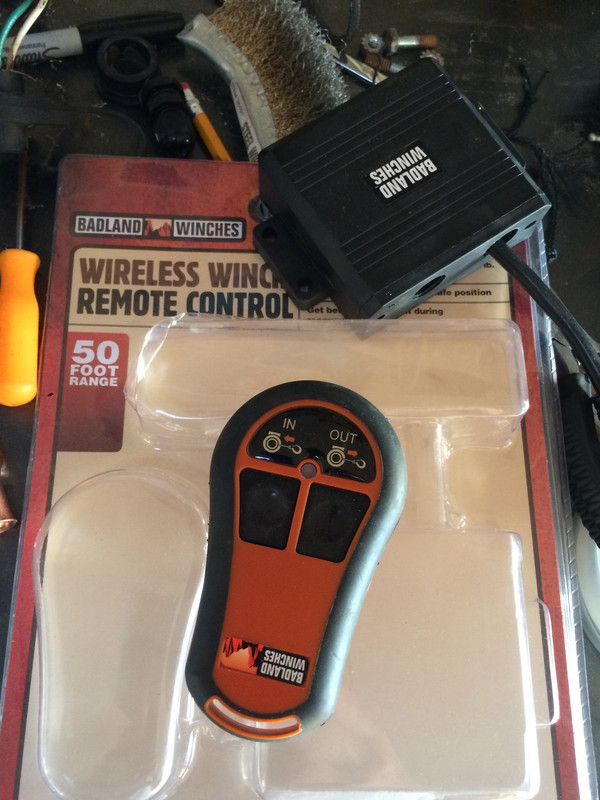

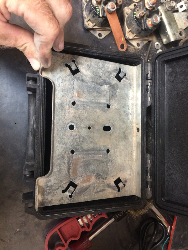

    Working on hooking up my winch. I wanted to remote the solenoids and put it in a semi water resistant container.
    Also wanted to add a wireless control.
    First thing first and mark where all the wires connect at
    I'm going to reuse this mount plate so need to flatten the round, mount to motor standoffs
    Better
    Almost fits in the pelican box
    Fix that later.
    Note the wire colors of the harbor freight wireless winch control have changed slightly. Green and white are in out. Red and black are hot and ground.
    Hot melt attach it to the bottom of the solenoid plate
    Fuse and "arm" switch for the wireless control added.
    Can you believe how cheap this thing is? make sure you use your 20% off coupon (avail just about everywhere)
    Here's where I left off. I needed to order some 90 deg cable glands and also I confess I ordered 2/0 gauge wire instead of 2 ga wire. So oops. more stuff on order which is fine; out next week for work anyways. It's going to be tight. Eeek hope it works out.

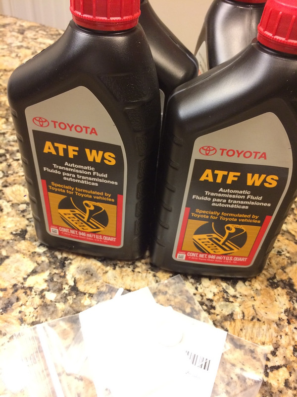

    Transmission fluid change time. I'm at 108k so past due if this is the first drain and fill.
    Followed the great directions at here. Only notable difference I encountered was to get into temp check mode I needed to do full shifts from P to N *not* as the described with P-N then D-N several times. Whatever, still went to temp mode after I figured that out.
    I drained just shy of 3 quarts and filled with 3 quarts then about a cup came out when checking the level so I feel like I put in what came out.

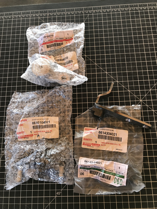

    Fixed my rear doors to stay open.

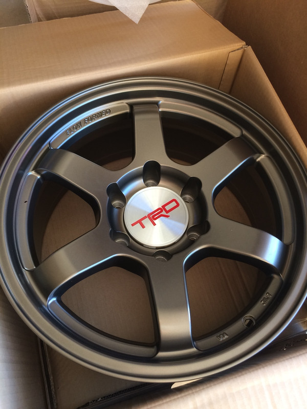

    Also got some goodies from Dustin at FN Wheels. He's the man if you're thinking about it. Very professional and knowledgeable.

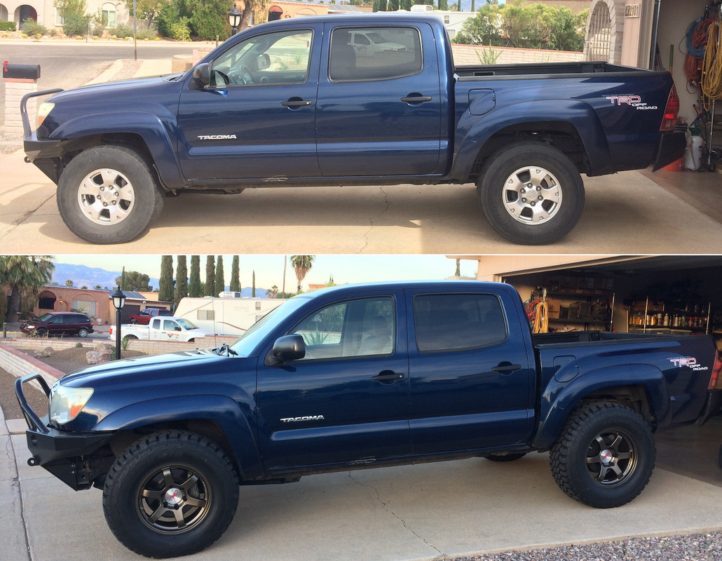

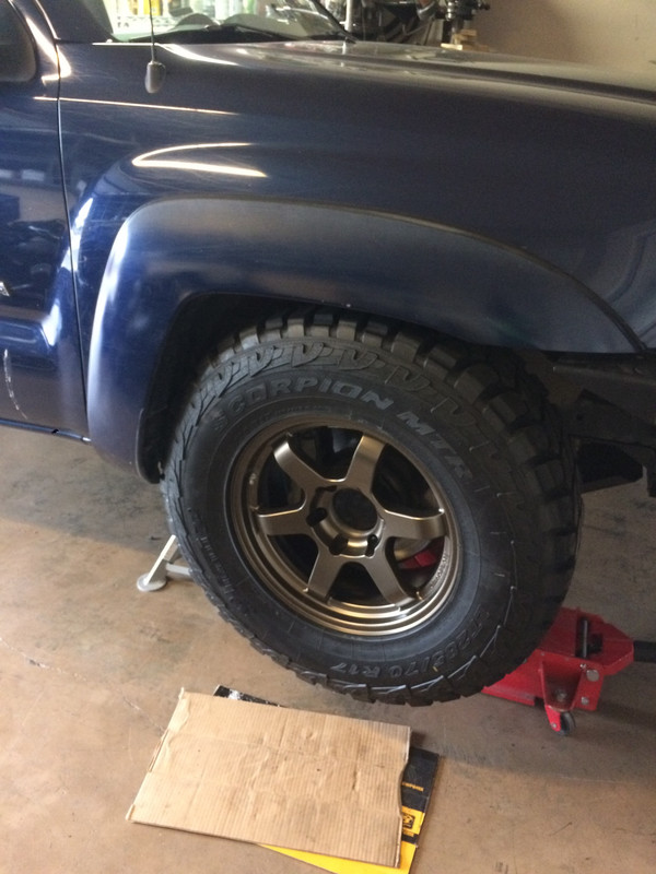

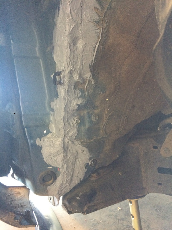

    Need to fit these. These are intermediate tires. The old tires were worn out and it felt like a waste to put the same ol stocker size on it. So on with the 285/70 17s. I knew it would be close and that some modification would be required but this is just to hold us over till we can afford the LT. If you're curious like me, the rims are 20.6 lbs, the tires are 54.8 lbs so total unsprung for the combo is about 75 lbs
    It rubs of course on the seam weld and a touch, i mean just a touch on the lower bit of the fender in this area here.
    Took the strut out so I could cycle the suspension to make sure I knew exactly what was needing to be clearanced
    At full stuff
    Took a hint from MrGrimms build and cut and alternated folding the seam to the inside and outside
    [​IMG] [​IMG]
    Then I puckied it all up again with 3M seam sealer (note folding back and keeping the square hole inner fender liner tab
    [​IMG] [​IMG]
    Way overkill, but over the seam sealer I sprayed on the duplicolor paint. Yes, I'm aware this will be covered up and not visible; what can i say.
    Oh, and I love it when I turn my grinder off, set it down and as it spins down, the nut inertia loosens it up, comes off and it auto-dissembles itself. (that's exactly how the parts came to rest)

    Trimmed the flares a little. I used a jigsaw with a metal blade and it went through like butter.
    I also used a heat gun on my inner fender liners. Once it's hot it's workable like leather sorta.
    Put the flares back on. I had ordered the square fender liner retaining clips off Amazon but they didn't show up in the mail yet. So tried to source locally. Toyota had 3. WTF?! and at 2.50 a pop. Tried several auto parts stores (one might come through but they have to get them in from their warehouse), but... Fastenal had some that worked for me. 8mm vs 8.7mm on the square but they worked. 50cents each. They seem fine, but if they end up failing, the ones I have on order should be in so meh.
    So heres a few shots after I put the wheels on. Previously mentioned that while it was in the garage I cycled it through full droop and stuff while turning the wheels so I was pretty sure I wouldn't rub, but I drove it around the block real slow hitting lock to lock too just for peace of mind.
    Before and After

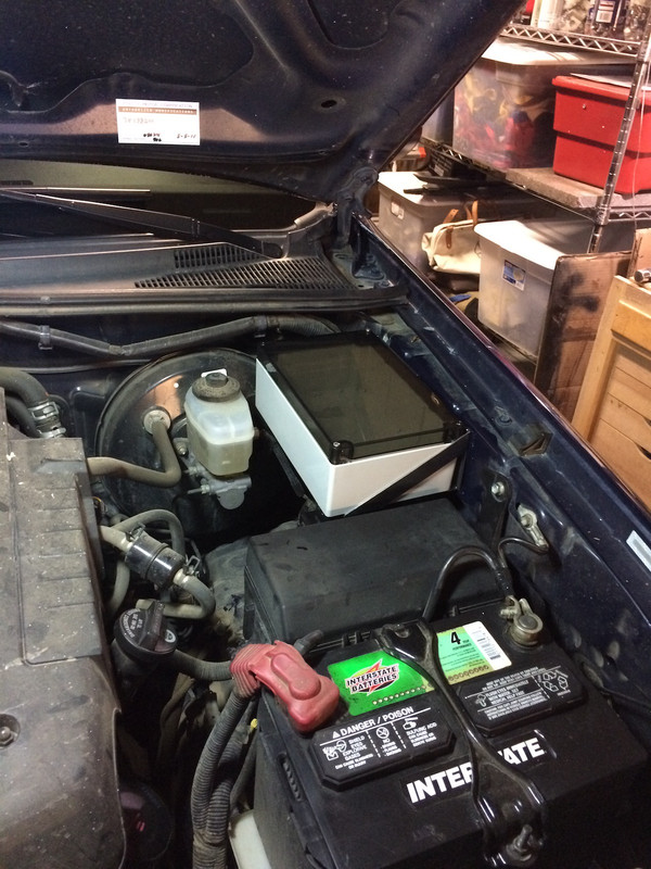

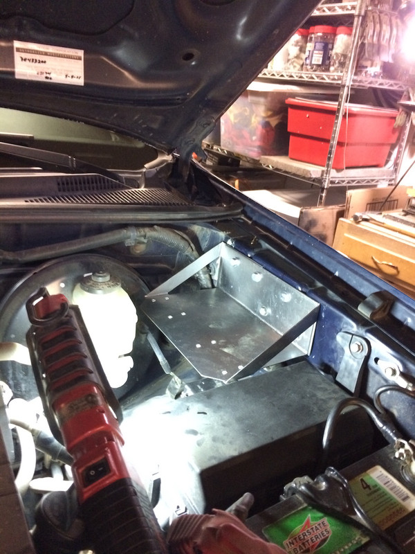

    So yeah, back at getting this under-hood winch controller hooked up. The pelican turned out to be too small so off to Hammond to get a different box. With that need to make a base to house the wireless controller so I used a piece of one by.
    Then had to figure out mounting a bracket to the truck. I used the two existing holes that have a nut welded behind them then put in 3 other nutserts.

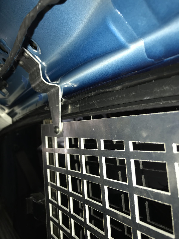

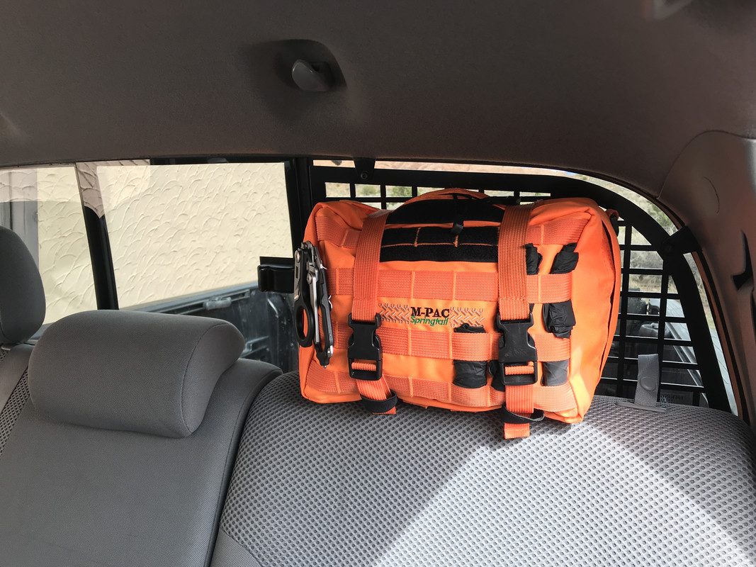

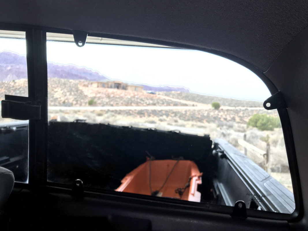

    Wifey built up a trauma kit in a similar vein as Chris @overlandbound.md and gave it to me to put in the truck.

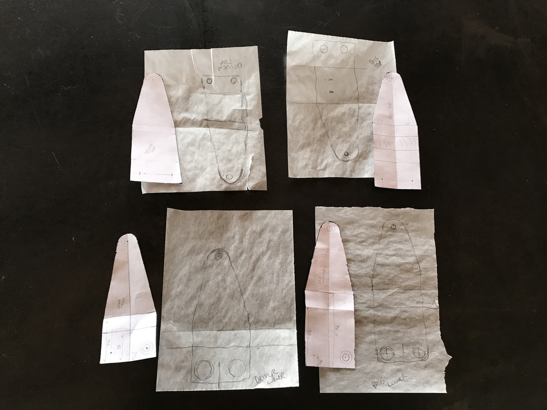

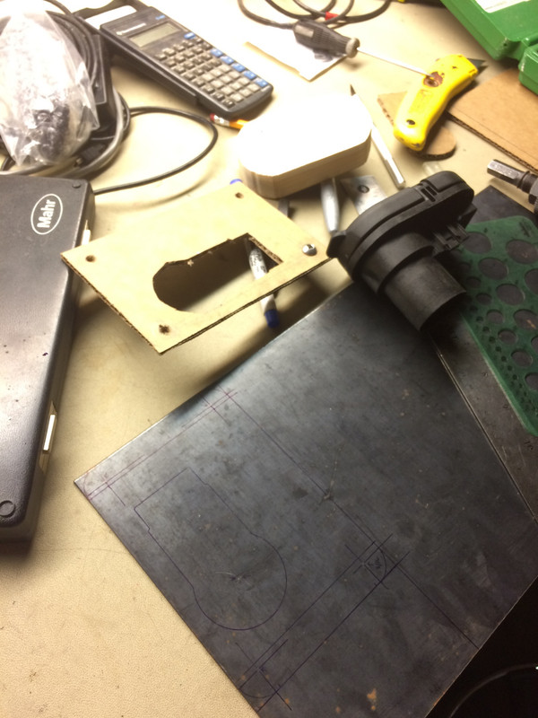

    First I thought this would be easy, was planning on just doing one of those molle panel's on the back of the front seats but found that would be seriously in the way for back seat passengers.
    Only spot I could find that wouldn't interfere was in place of the headrest on the rear seats. So 15 minutes later. Had to remove the interior because the brackets to mount this in place.
    Used some thin wrapping paper to trace the window shape
    Then worked up a mockup out of cardboard. Cutting all those little squares out with a xacto was a PITA
    Mockup seemed okay so drew it up in Sketchup and printed a 1:1 copy
    Locally one of the off-road shops has a plasma cutter but he recommended I take it to someone with either a wet bed plasma or a waterjet. For me that's 2hrs away but was able to give them my drawing and just head up when it was ready to pickup.
    The brackets was the real time suck. Next time I need to have a profile gauge. Overall though I was successful, just time consuming bending these guys with just a hammer and a vice.
    Mocked in place. I used rivnuts in the truck body which worked out pretty slick I think.
    Final attachment I put silicon calk between the bracket and truck body to combat rattle demons. Then all the interior back in place you can barely see the brackets.
    And finally, after a month, the trauma kit is in the truck. :dancingbacon:
