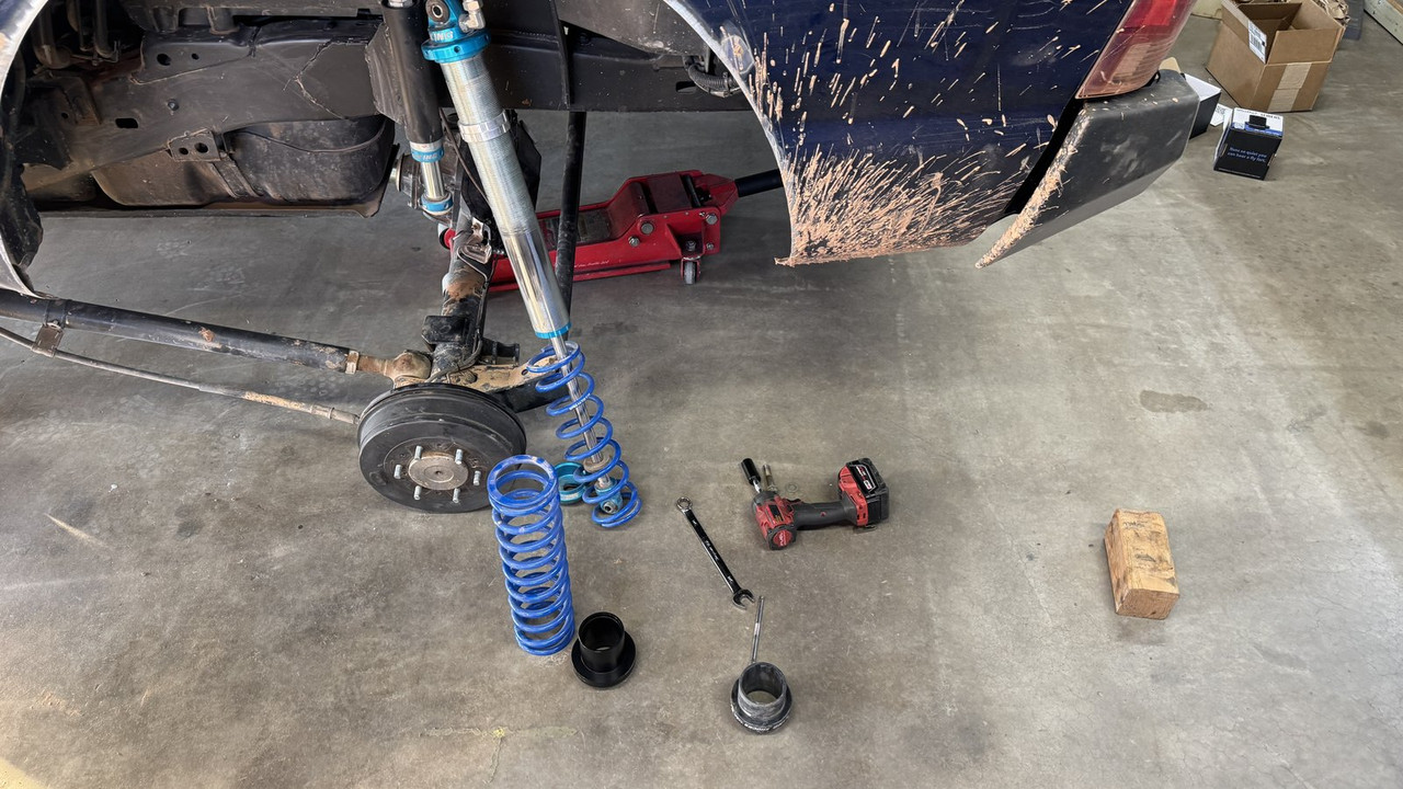

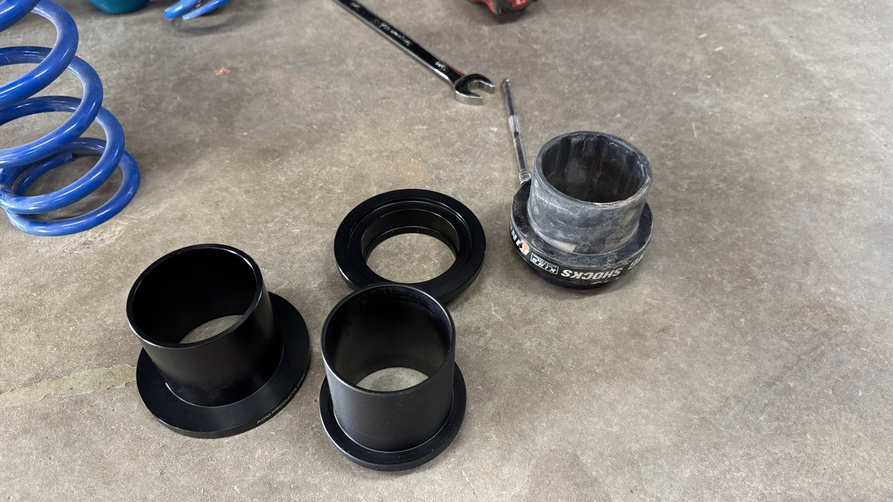

    After some more wheeling, the gosh dang coil slider is loud. Sheesh, I mean if race car fine, but groaning and moaning like a ______ um, use your imagination.
    So I'm trying out these 3-piece units from AGM. They are a tighter fit and well I hope this helps.

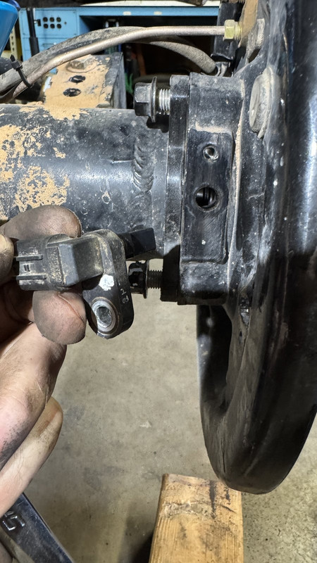

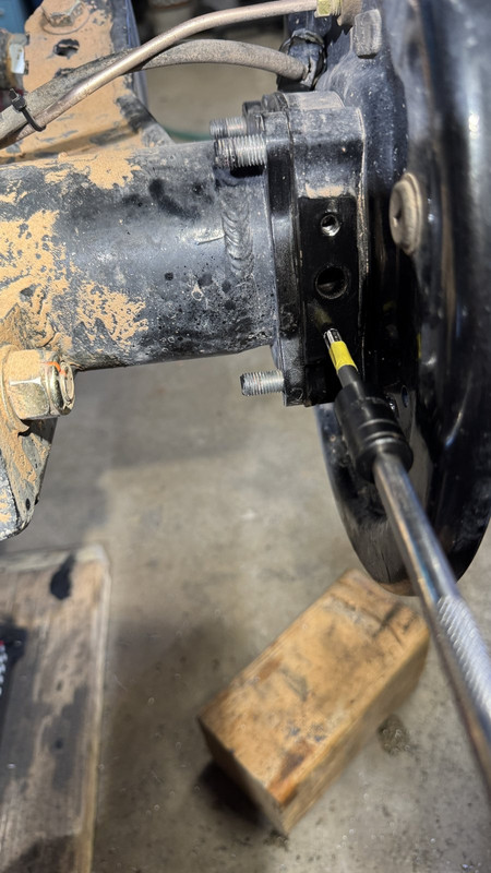

    Apologies for the vertical pictures. So this is some beef I have with Fusion. I haven't been able to get them on the horn yet about this. My axle came assembled wrong and this was the like very last thing after full assembly to the truck to notice. The wheel bearing flange? IDK what to call it, that the speed sensors go into is wrong. Either a passenger put on the driver or a driver put on 180˚ around but the bolt hole is 180˚ off, on the top when it should be on the bottom. You can see how then the connector would be pointed straight into the backing plate. NO GOOD. I did try a passenger side speed sensor but that didn't work, ABS threw and error code which wouldn't clear unless it had a driver side sensor in it. So...
    So yeah, Got to drill and tap this right, which is a pain because you need to clear the backing plate. First I thought I might have to remove the backing plate but OMG.. that's a process, so I was able to find a 3/16 long bit and a 13/64 1/4 drive bit locally. So with the long bit I got a nice straight hole, and then the 13/64 could just follow it and ream it out to the right size for tapping.
    And with square tap socket thing and an extension I could tap it fine.
    I should not have to do this on a seven THOUSAND dollar axle. Not happy about that and I hope they make me right. In any case, it's fixed, my speed sensors are all happy, and the ABS, Brake & CEL lights all are cleared and the speedometer works again. So overall Win!

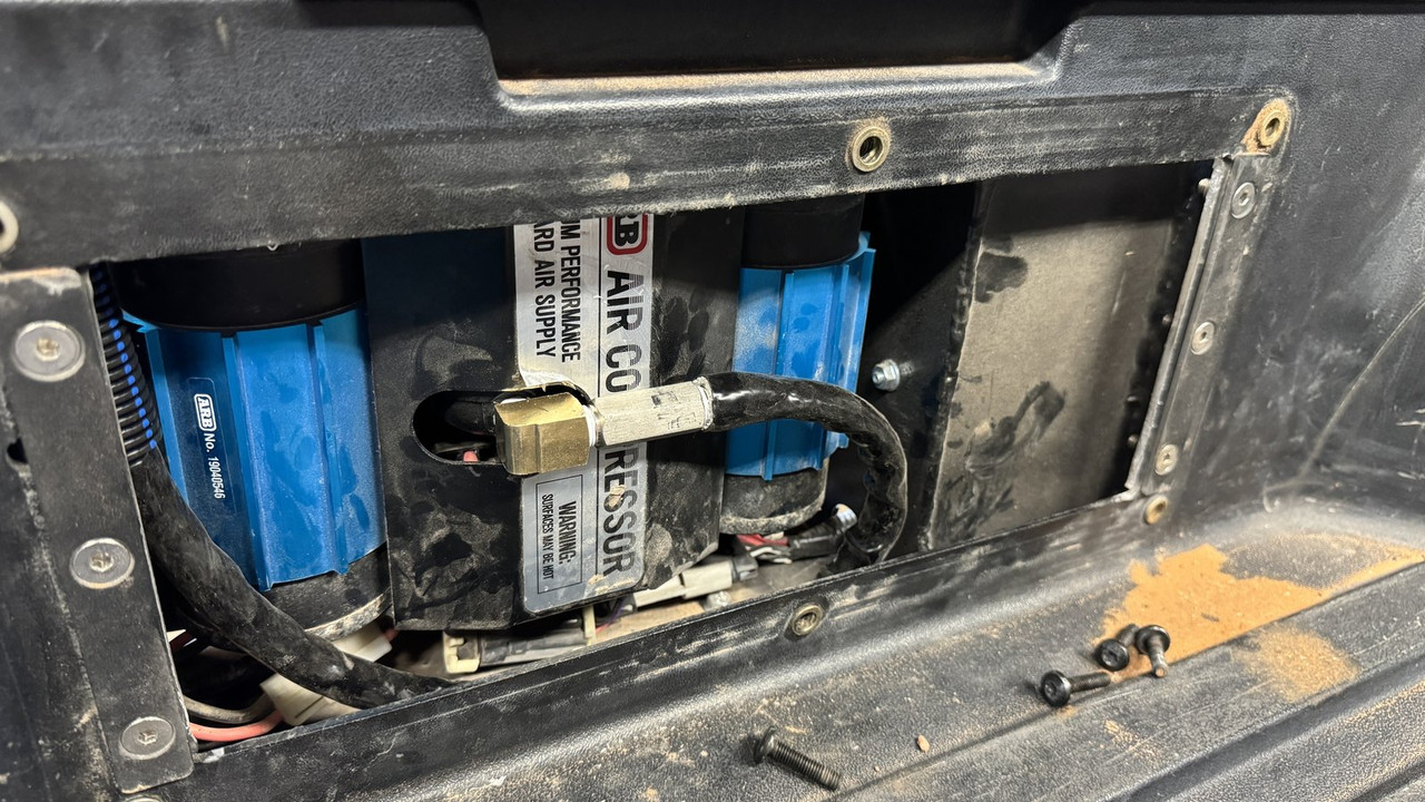

    I blew the line from the compressor that feeds the manifold when running it for 15+ minutes of air up (me and another rig). This is 3/8 PTC line and it blew right by the compressor so I was thinking maybe it got hot and soft and that's why. So off with the fender again, and add some silicon fiberglass insulation tubing stuff. Also a check valve so try and not loose air back flowing through the compressor. I got to thinking, this could also be a failure from hot air coming from the compressor basically heating it up from the inside which maybe is why there's such a thing as leader lines but I don't know... if any of you do, post up.

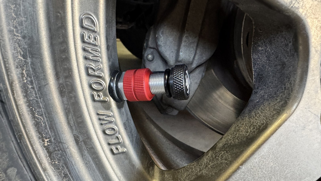

    Installed monster valves. I have Staun deflators which were great, but man that takes a long time with the 39's.
    The place on the wheel for these was a tad narrow, so I both widened the footprint and made it nice and flat with a forstner bit. Then after followed through with the regular drill and tap.
    I do like being able to chuck on the gauge at the same time as airing up/down so you can just monitor it, not like air up some, check gauge, air up more...

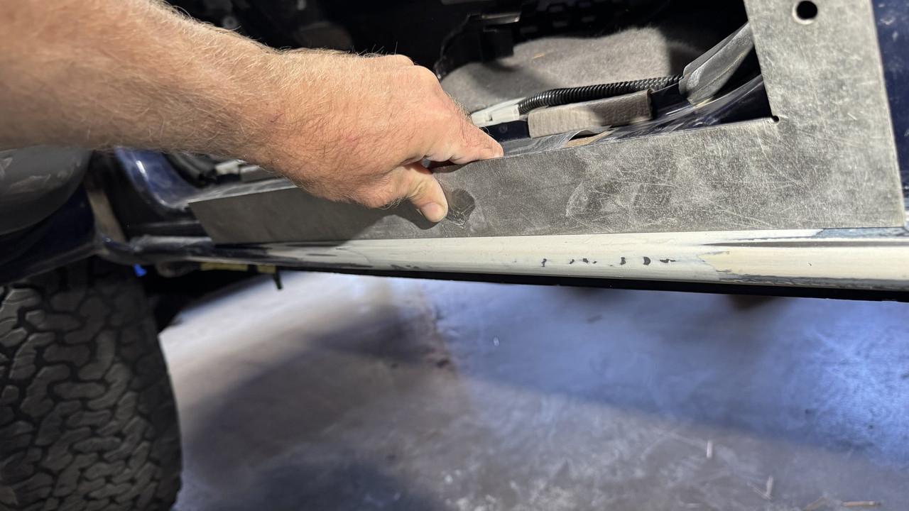

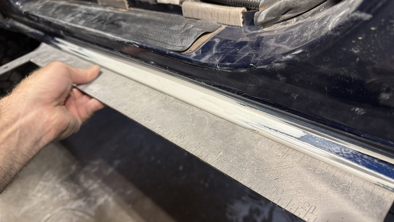

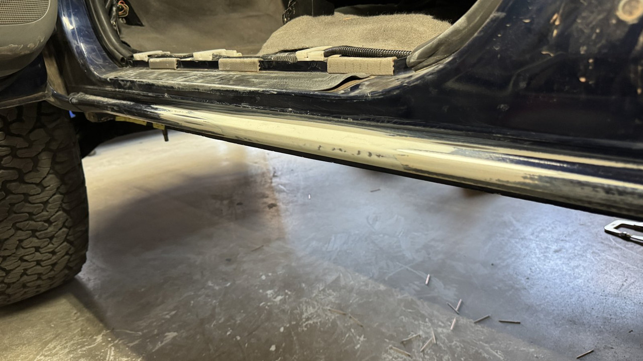

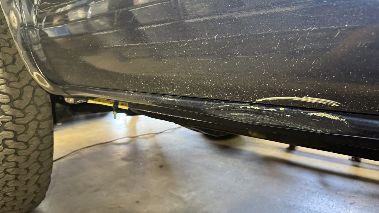

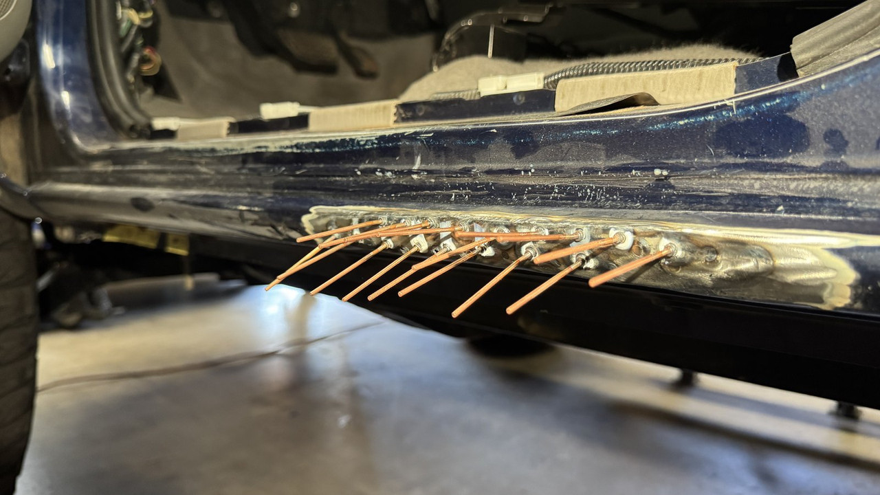

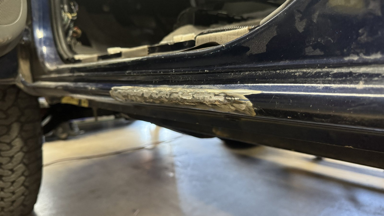

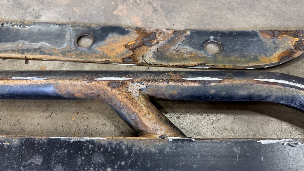

    Back in the day BRS (that's before rock sliders)... somewhere in Arizona while doing some bonus wheeling after a canyoneering excursion, I dented the rocker. There's no real access to this unless maybe you've got some real cool PDR tools. As I'm working toward getting the sliders put back on, I wanted to fix this before the sliders get all in the way.

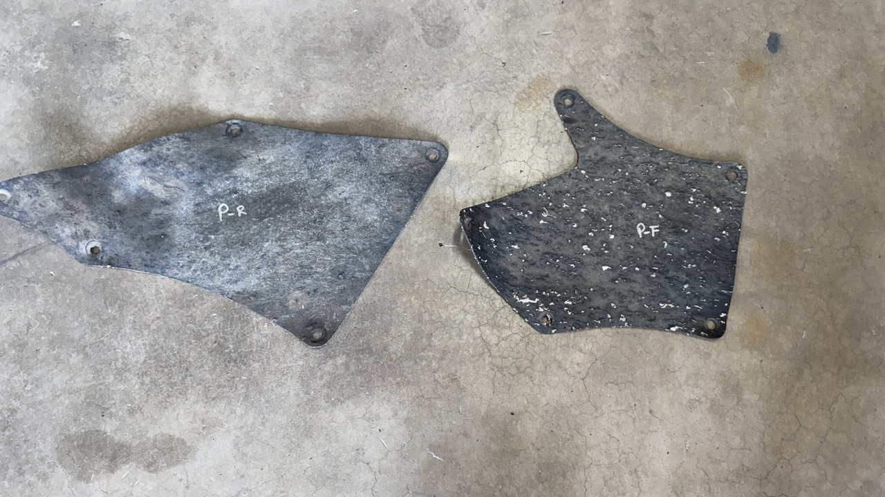

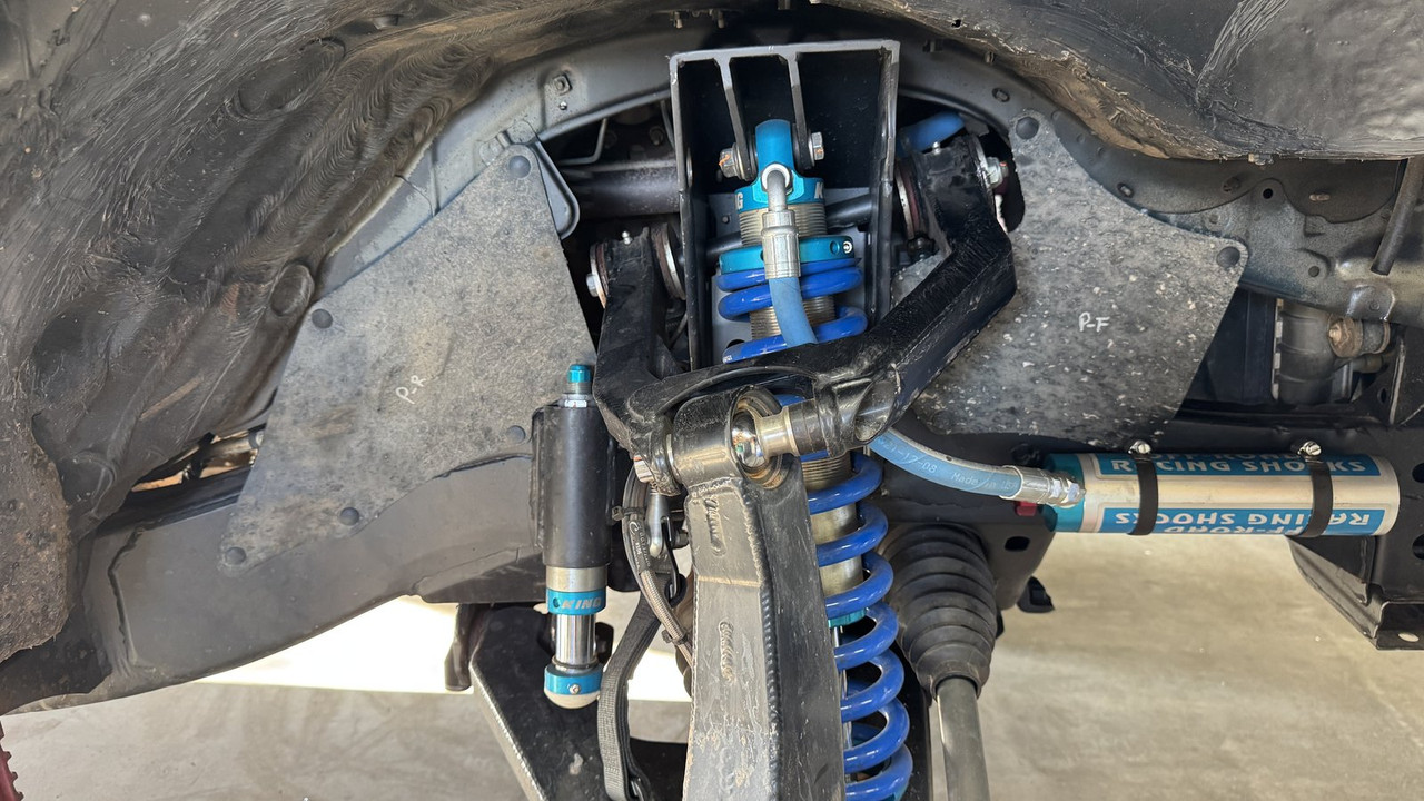

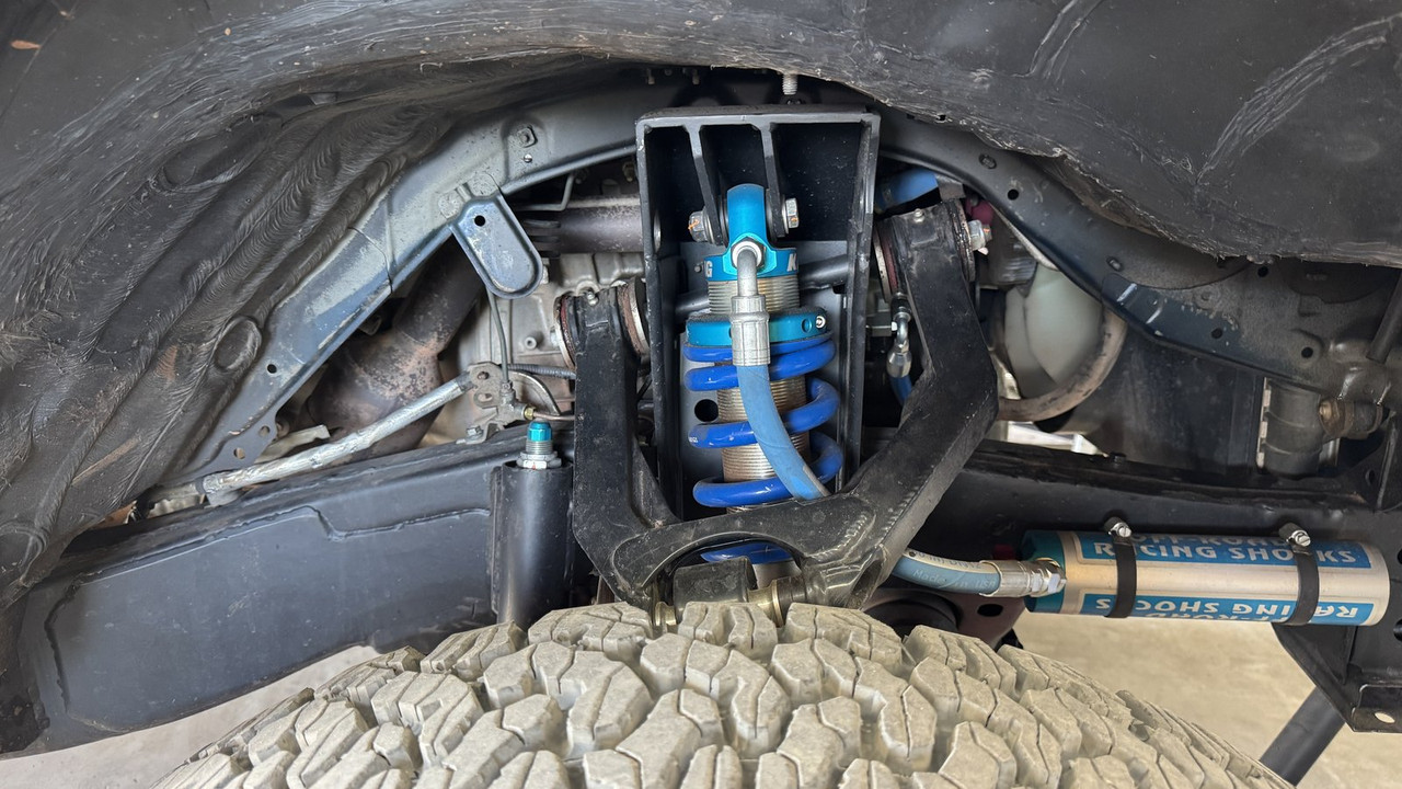

    They go left and right of the shock tower to keep some junk from getting onto the engine? Maybe for reduced drag too, IDK?
    Turns out with just a little trimming and drilling some new holes in the frame through the plates I'd put on, they go back in just fine. Happy with that.

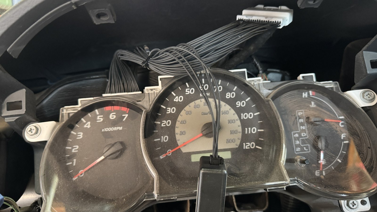

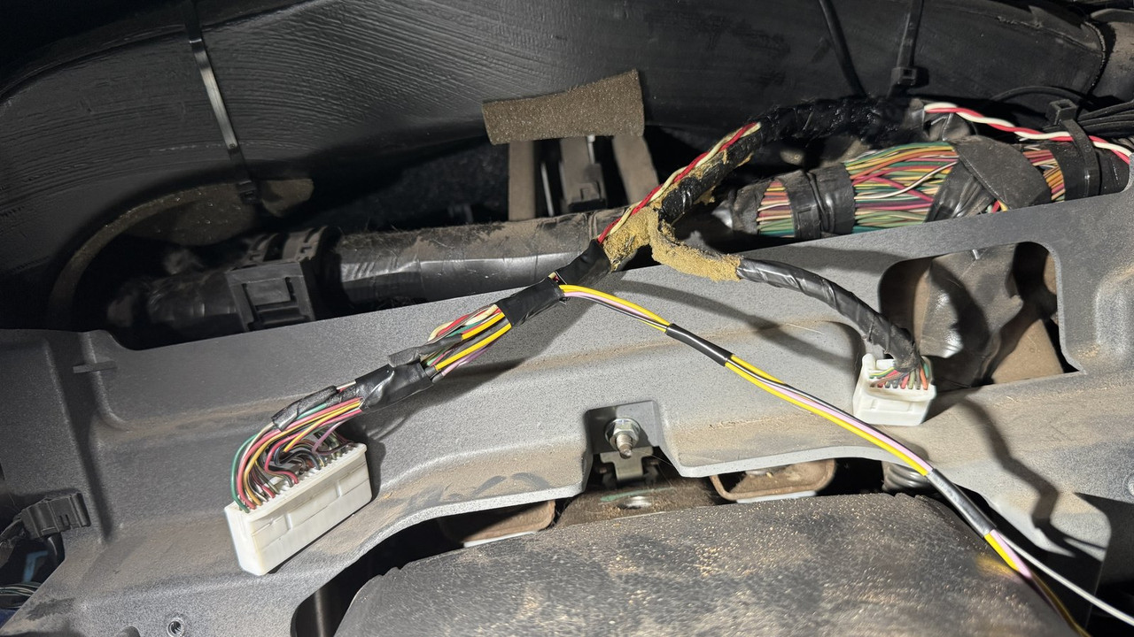

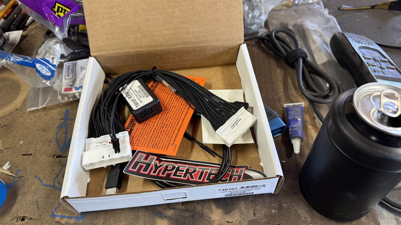

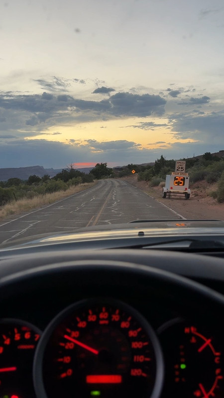

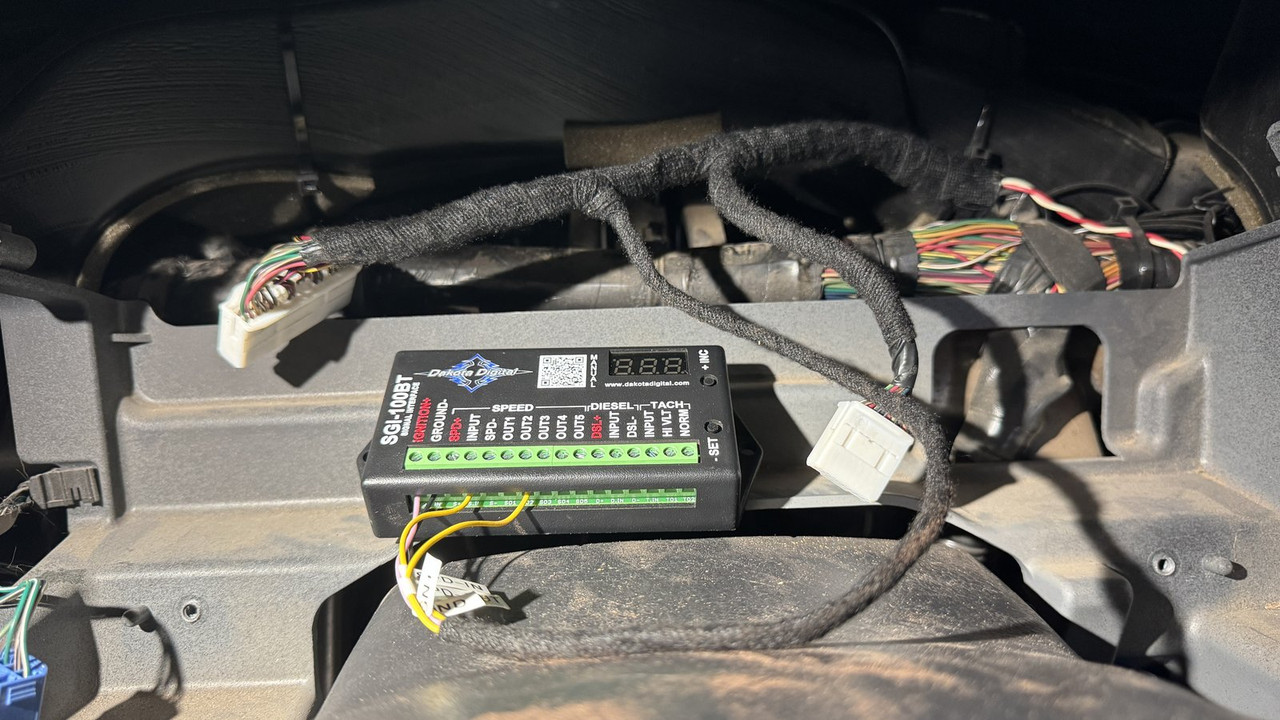

    Going from stock to 39" and 3.73 to 5.29 the speedometer was off by close to 10mph. I got this unit from Hypertech. It's a really nice user experience. You just program the thing with a USB cord, then plug and play to the dash with their inline splice cable.
    Unfortunately it didn't work for me. I rung out the cable and that was fine, and the unit responded to programming, but with it in place, I'd get a generic P0500 speed sensor code and speedometer would just read zero. Contacted support and they said to return it so I did that.

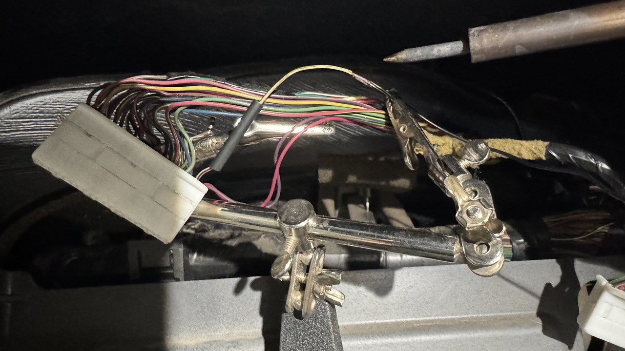

    And got a Dakota Digital unit which means I had a more complicated install. Still not bad but not as polished as the Hypertech. Cut and solder work
    Taped up all good. Turns out that you can configure the unit via Bluetooth without depressing a button on the device as you turn the key on. I get it, you don't want people to monkey with it but that's a pain. Had I know that before I spliced into the loom I might have made my extension longer and tried to mount it down in the left knee bolster cubby that covers the fuse panel there. But instead I just zip tied it to the vent duct work behind the cluster.
    I found that adjusting it via the app really wasn't as easy as putting it into adjustment mode while driving anyways. You can just be driving, and press the + and - buttons while watching your GPS speed on your phone until your speedometer reads right. Pretty easy.
    Toyota, like many others, decides that they need to not make the speed == real speed though so if you set the speedometer to read actually true, your odometer is a little off. So I did more driving and figured out what my calibration needed to be so that 1 mile driven is 1 mile on the odometer. Then I split the difference, between accurate speed and accurate milage. Im about 1mph fast now so if it reads 70 I'm actually going 69. I can live with that.
    And glad to be able to stop running the speedometer app on my phone

    So my idea of the silicon insulating sleeve over the air line didn't work. Still blew.
    So went with the stainless leader line deal from Viair
    I am getting really proficient at taking off the bedsides.
    Let's hope this lasts because I'm now out of ideas.

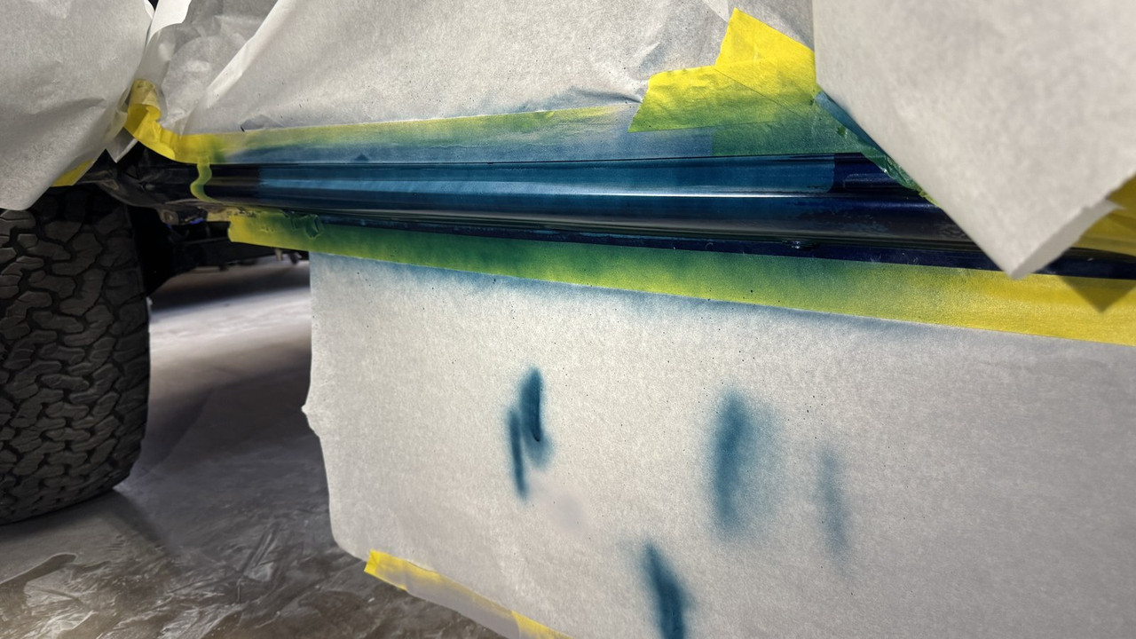

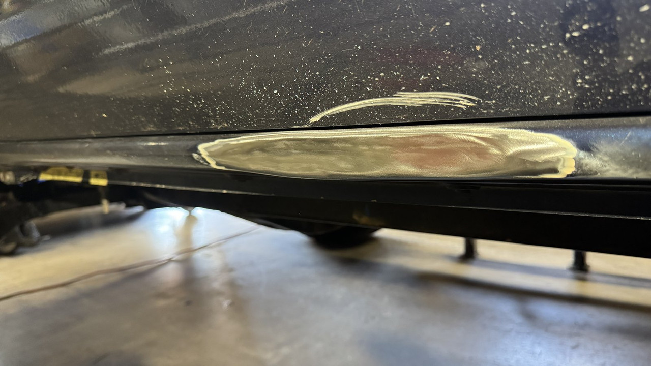

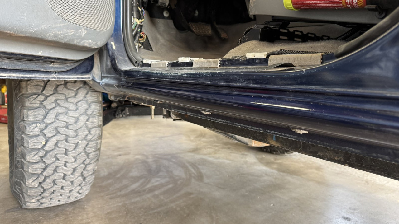

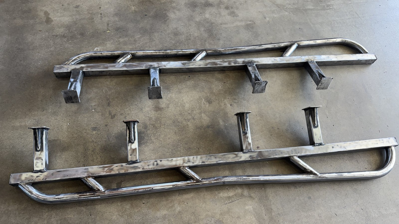

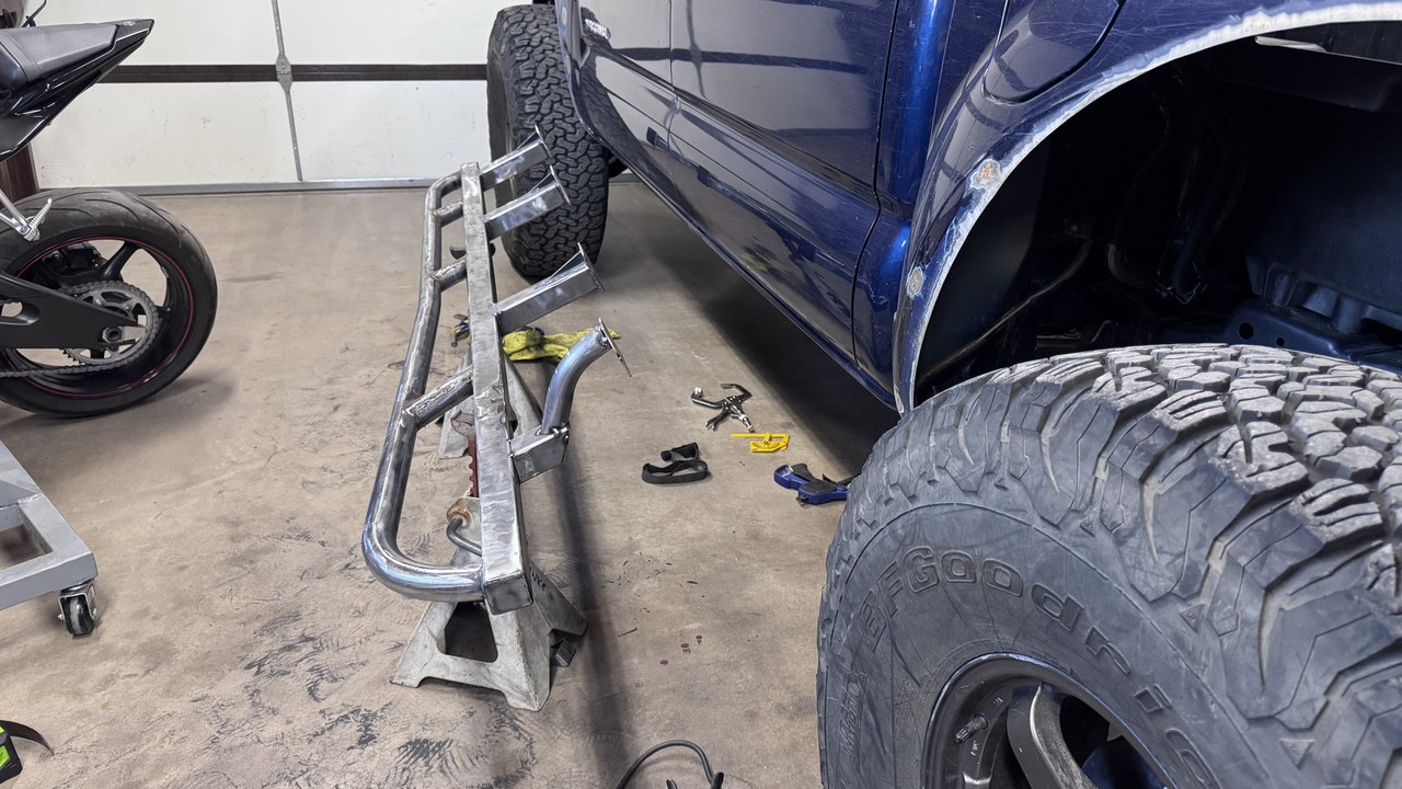

    This might look like a previous picture but no, no this is a new dent in the rocker... Only a few days after fixing the first one, I went out Rose Garden Hill and kissed a rock. So this time it's below the driver rear door.
    Okay okay, I *really do need* to get the sliders figured out.
