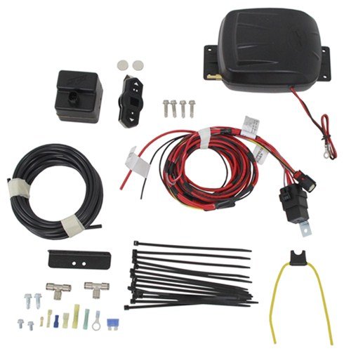

    Anyone have pictures of where you mounted your
    airlift Wireless One compressor, manifold and relay?
    Just looking for ideas on where to mount

    Did you ever get this installed? I’m looking for ideas on where to mount my compressor and manifold for the Air Lift Wireless Air system.

    @treimche - I did. There appear to be zero good choices under the truck. At least I couldn’t find any. So I mounted the manifold and the compressor in the drivers side bed cubby hole. Benefits of doing that is it’s easy to service and relatively dry. Downside is you lose one of your bed cubbies.
    I actually didn’t even mount them. Just threw
    Them in there:)

    Without getting really creative and building some mounts, I didn’t see anywhere under the truck to mount this stuff either. I also came to the conclusion of mounting the compressor and manifold to the drivers side box cubby. I might try to mount it all behind there in order to keep the cubby space.

    Not trying to hijack this thread, but I got started on installing my Airlift Wireless One kit tonight. If you drop the spare tire, there's actually a bunch of room above and around that area to mount the compressor and manifold. I didn't get any pics, so once I get the wiring all finished up I'll share.
