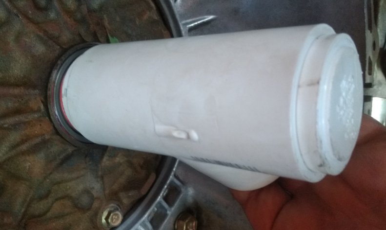

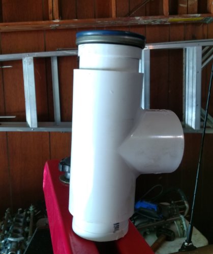

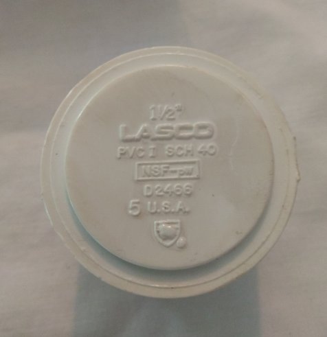

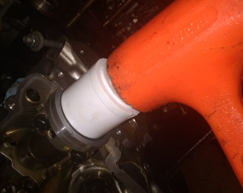

    I replaced every single thing while I was in there, including the crank seals using the Ebay all OEM kit. See Timmy the Toyotaman video. By the way, you do not need the $106 seal tapper inner tool. I made a tapper inner from a piece of PVC.

    +1 for PVC. No need to spend a bunch of money on limited use tools. Just take your new seals to Lowes or HD and find pieces of PVC that match up. Spend money on good torque wrenches.

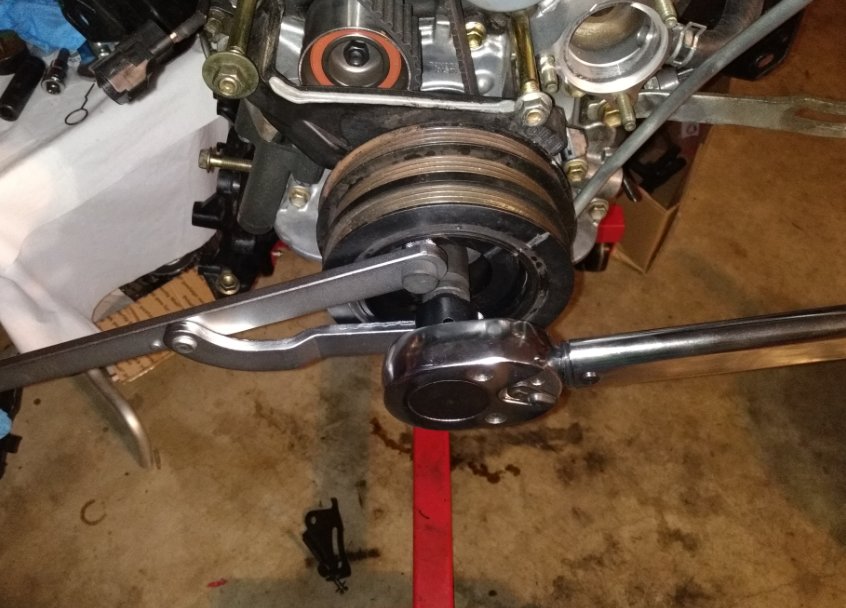

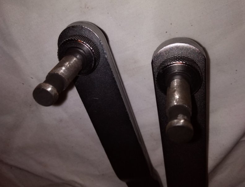

    OTC 4754 with a 3/4 inch torque wrench from Harbor Freight.
    You can use this tool for the timing and crankshaft pulleys.
    Buff down the ends of the largest points to use these on the crankshaft pulley.

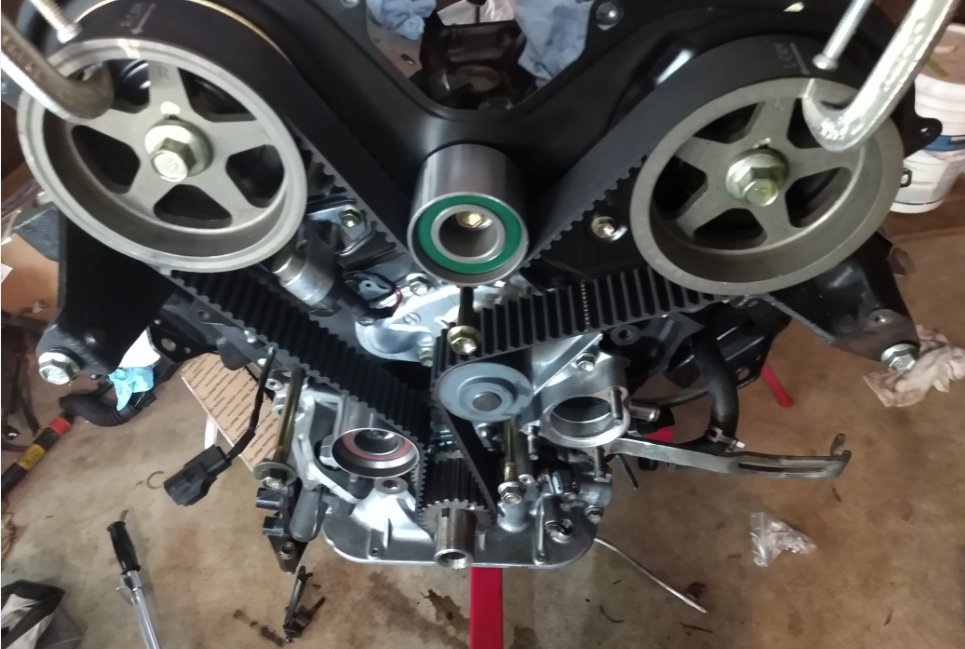

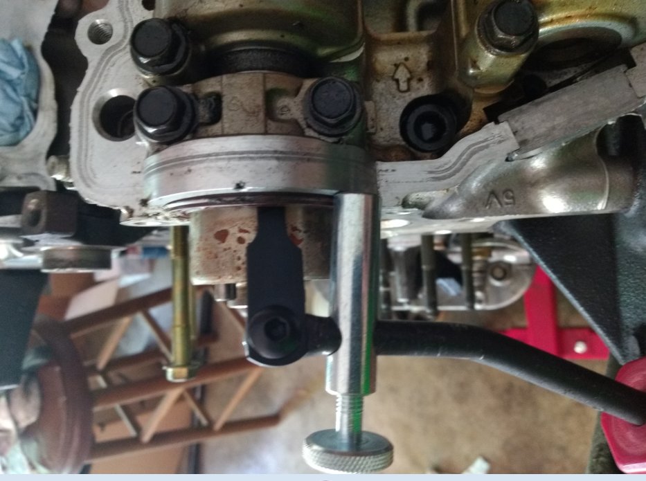

    This little seal puller worked well.
    Use some c-clamps to hold the belts to the pulleys. Turn the pulleys in opposite directions to produce slack at the bottom of the belt so it will slide over the crankshaft and idler pulley. That was an easy step.
