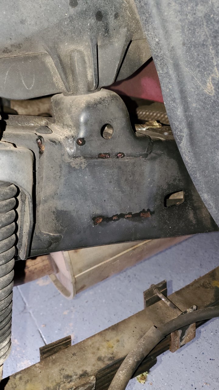

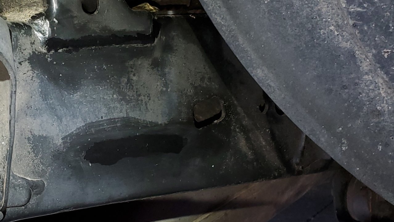

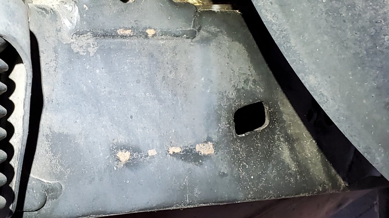

    After 5 Wisconsin winters I found some frame rust on the backside if a weld20211005_092915.jpg
    Applied rust converter
    Encapsulate with enamel

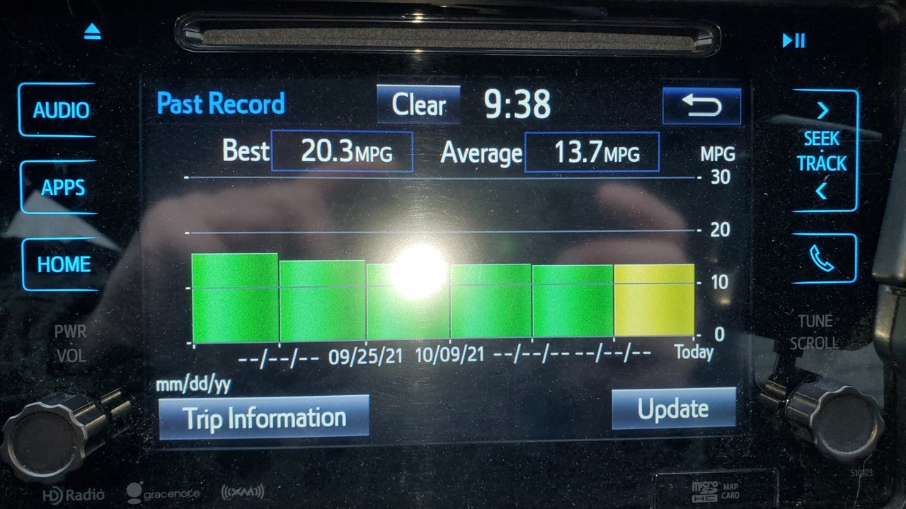

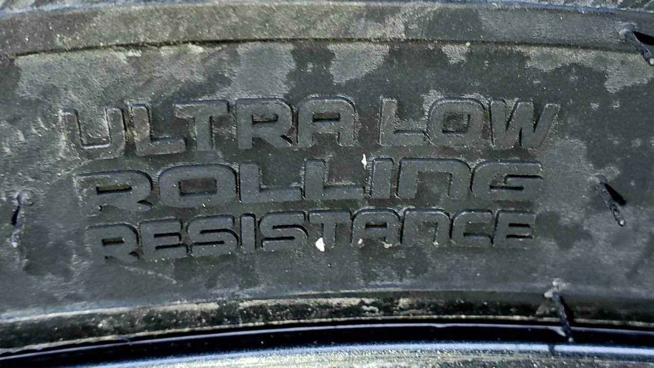

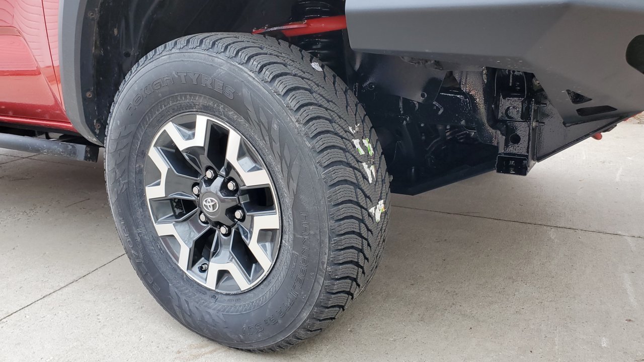

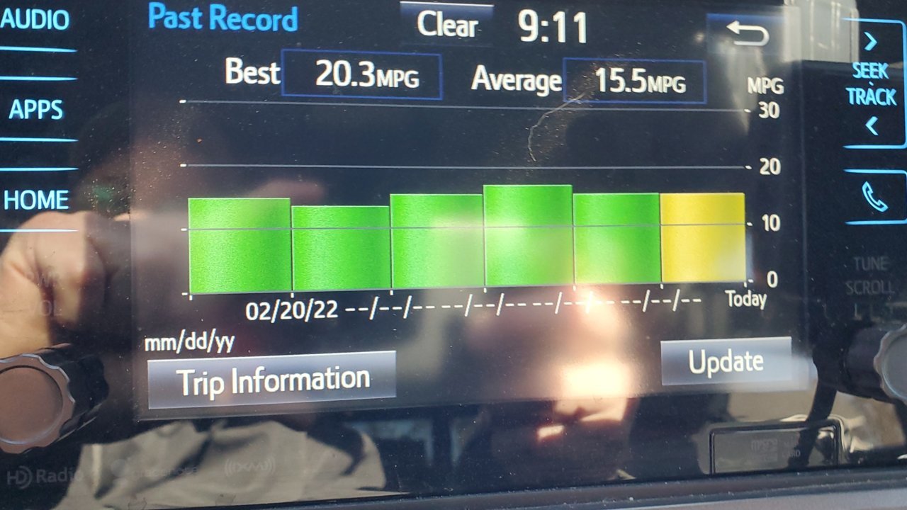

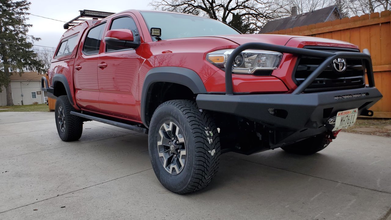

    Hakkas installed. They feel good on dry pavement. The low rolling resistance is noticeable. MPG experiment has begun.
    20211219_093928.jpg 20211219_093938.jpg 20211219_093840.jpg 13.5MPG at the time of install.
    36PSI Front
    34PSI Rear
    Edit 3/27/2021
    15.5MPG average through winter, not too bad
    BEAR_KNIFE_FIGHT and Thatbassguy like this.

    They look good! You're going to love those things!

    20211219_120214.jpgThis is promising

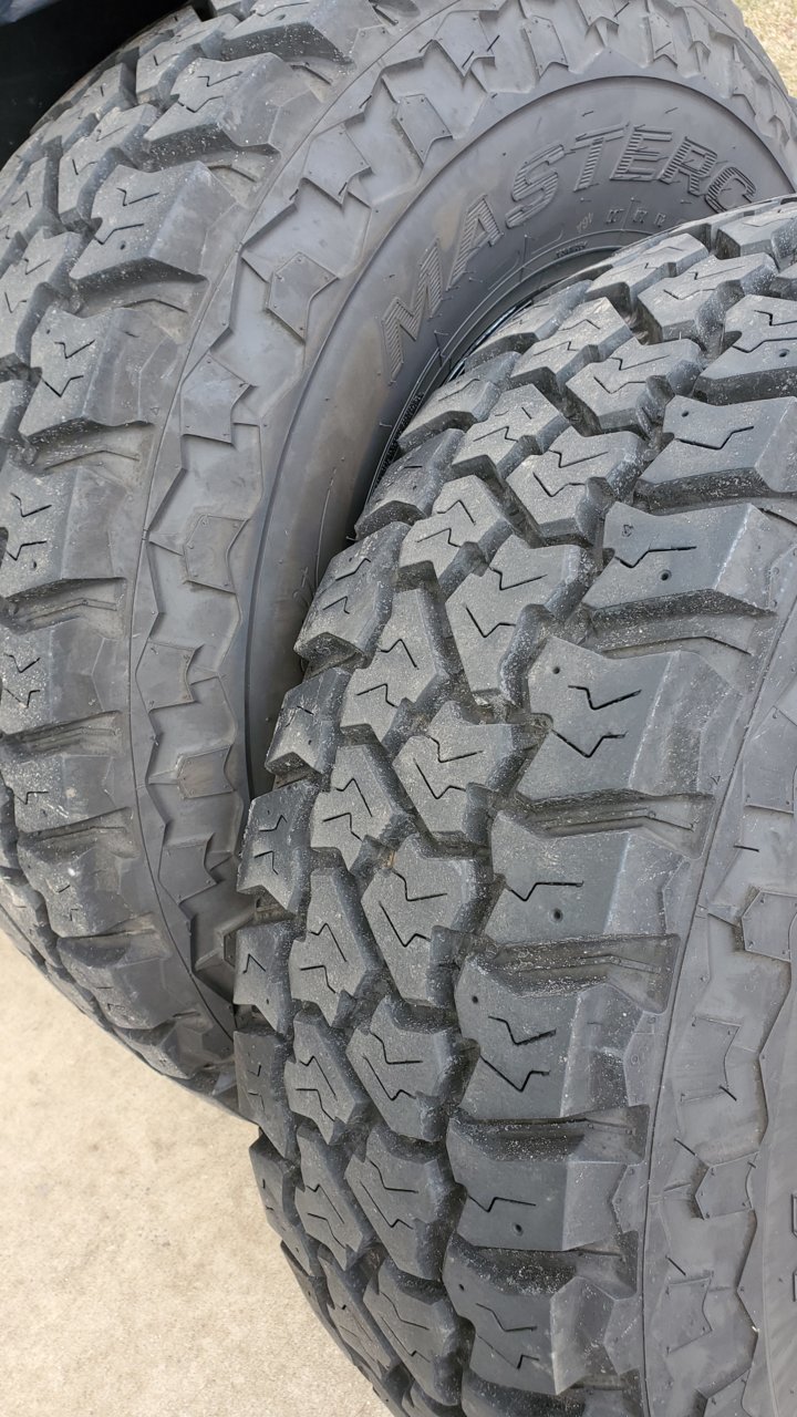

    Mastercraft Courser CTX 9K review: 9000 tough miles, lots of high speed highway miles and a good amount of sidewall rippin' rock and mountain roads. Wear is even, balance held well, they still look new. I think these are pretty good tires20211219_112304.jpg

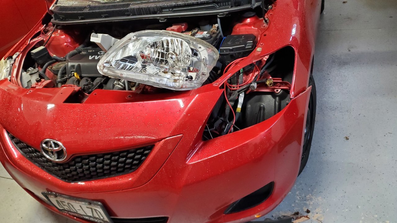

    20211125_095412.jpg Yaris report: 204k tree fell on her, had to replace headlight assembly and a bunch of bumper clips. Reform some bumper cover support, added a couple of fender washers at broken plastic.
    Airbag, window switch, seat rail and clock spring recall complete.
    Replace spark plugs.
    She's ready for another 100k

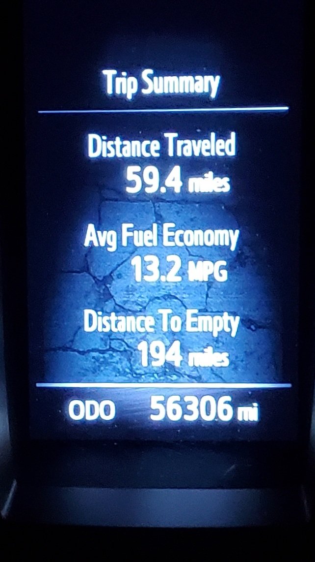

    Back to reality. Anything over 75MPH results in shitty MPGs20211227_203717.jpg
