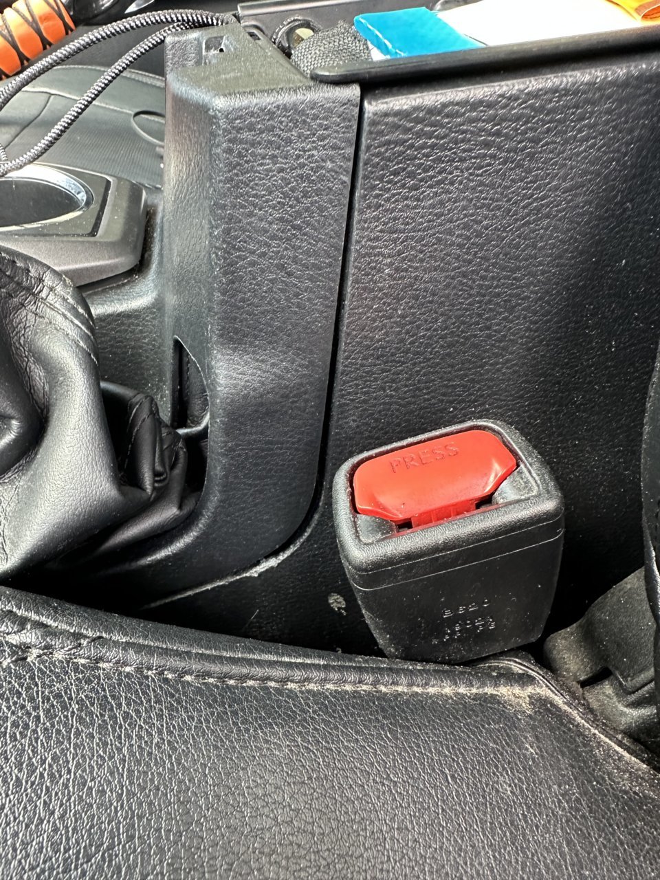

    I had the same issue as you. My trim just would not pop in properly. Clips weren’t lining up as they were all moved forward. Spent an hour trying to make this work. Had to move back the inner plastic brace as the cups were too large and we’re getting hung up. It’s not a perfect fit but I can live with the gap. Just Glad I can finally put my yeti there :)

    I just received my AJT Design cup holder and like others could not get it to fit. There is a crossmember under the center console cover that sits just behind the cup holder. This interferes with the oversized cup holder. It forces the center console cover forward enough to not allow the clips to line up. I was unable to click everything back into place without breaking clips. It’s a novel idea and much needed in the 3rd gen Tacoma, but unfortunately was poorly executed.

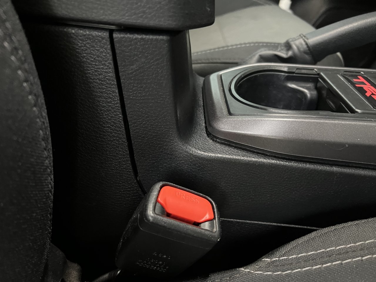

    Just installed mine. I had the gap as others had. In trying to adjust it to not have the gap I bent/broke two of the top clips. Now the top portion where it connects to the center console is raised. Had I known this was an issue I would have went with Z Precision. I’m slightly pissed right now. Maybe I’ll revert back to stock and see how that looks. If it looks normal after reverting to stock I’ll order Z Precision. I shoulda done more research before ordering. I looked at both and ordered this one cause I thought it looked more stock and didn’t have the logo showing. Big mistake but I guess I mostly have myself to blame.

    Keeping playing around with it. It will eventually clip in. There’s 3 clips on the top of the centre console. I crushed mine trying to install the cup holder. Double check to make sure none are bent and sitting improperly

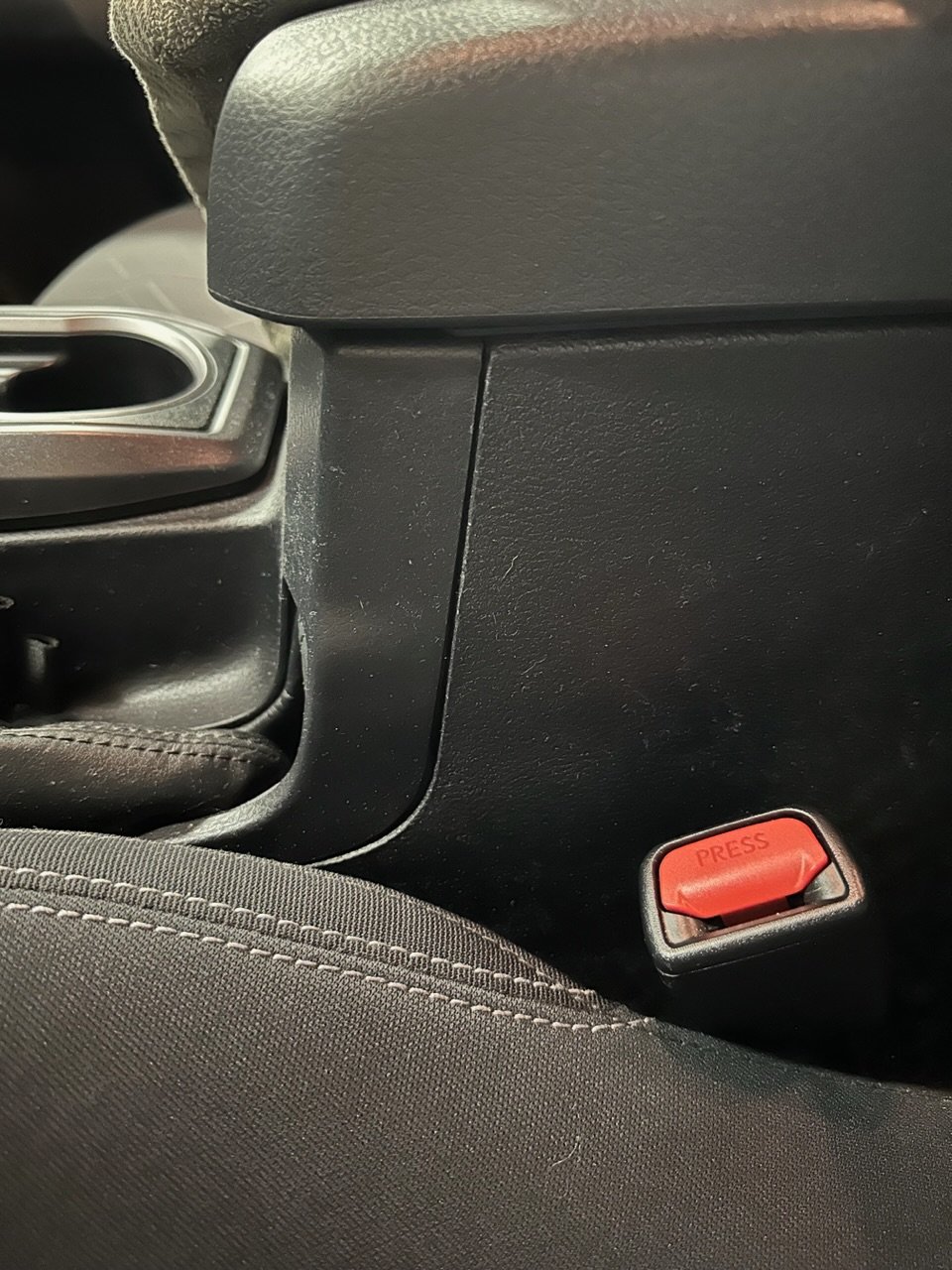

    Just installed the AJT tonight. Before snapping in I loosened that screw and moved the bar back and I still ended up snapping 2 of the clips and the plastic guide at the back of the console. I also have a gap on the right side but not the left. I can live with it but I wish I'd have spent a little more on the Z precision now.
