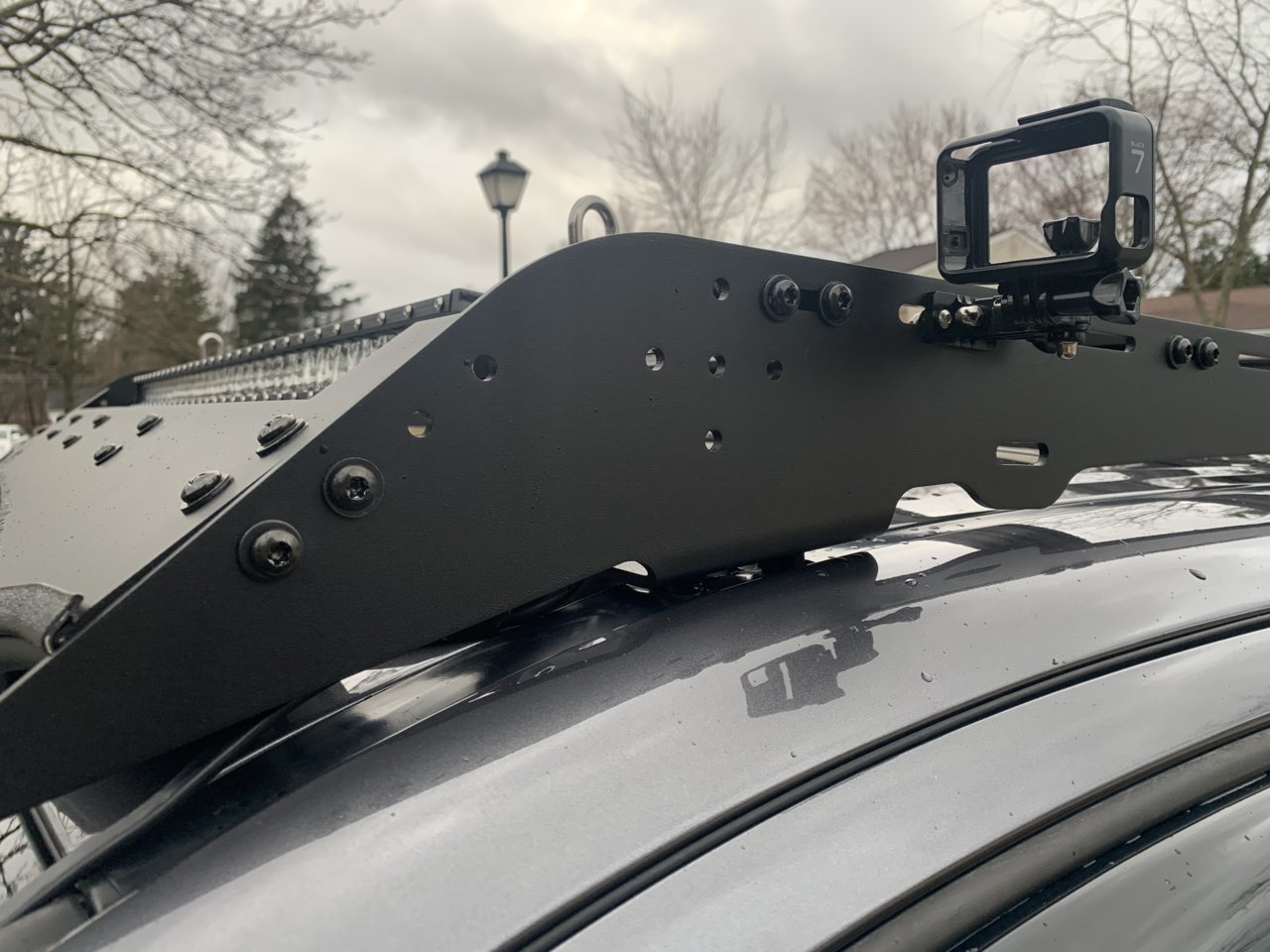

    Added a GoPro mount. Although I’m not too happy with it and will make some modifications

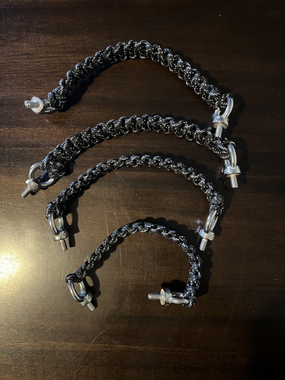

    Special thanks to @Mr. Excitement for crafting these grab handles for the prinsu. Now I need my truck back.

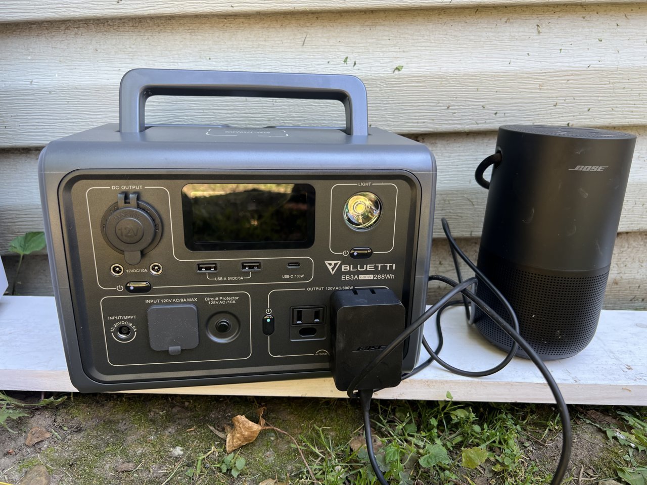

    Added a portable power supply for camping. Looking to eventually get a solar panel and put on the prinsu. Must say, this this is powerful for the size. Played my Bose portable and charged two phones from 32% for about 10 hours yesterday. Still has 12% when I woke up today.

    Added the grab handles @MrExcitment made for me and the Pelican case I refurbished. Think it’s looking good.

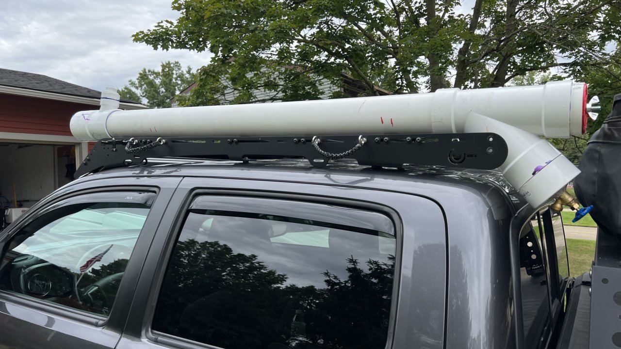

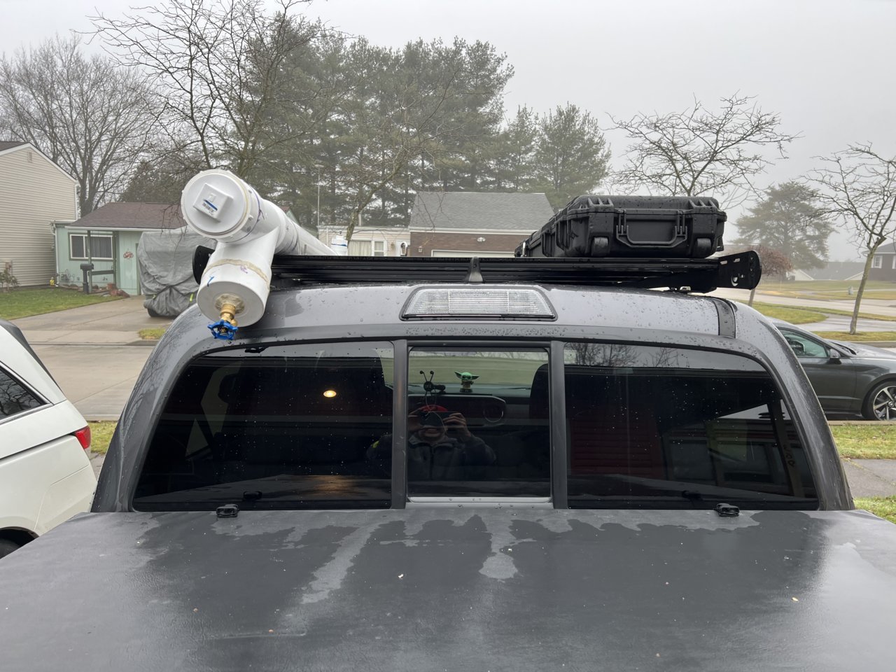

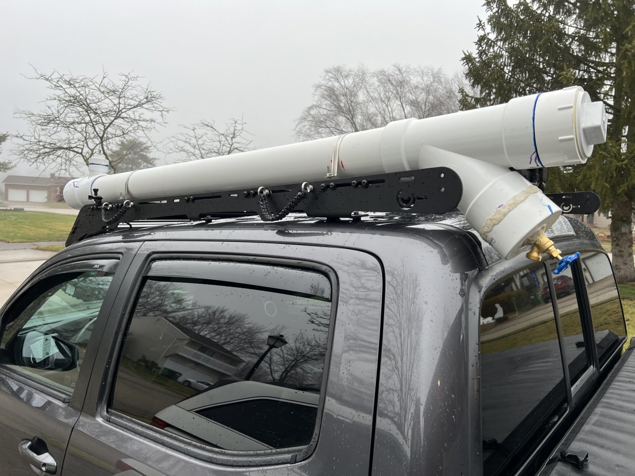

    Working on a PVC shower for camping, wash kids and dishes. Need to mount and paint, probs after winter.

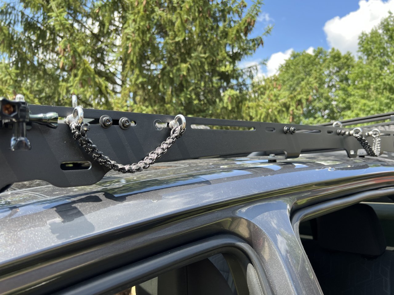

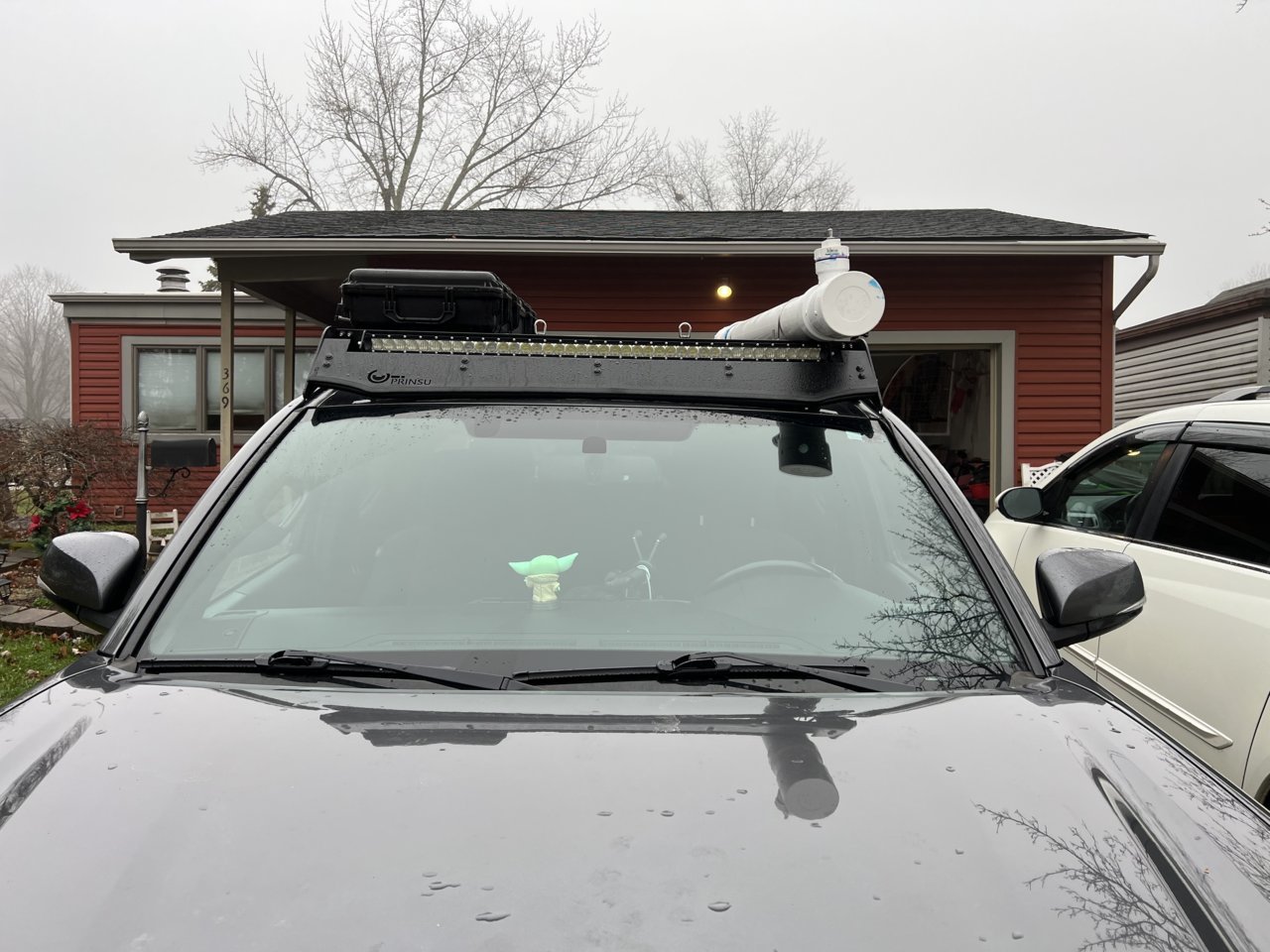

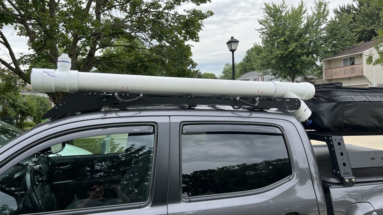

    Mounted the shower today.

    I'm liking the DIY shower. I suppose the sun would provide a little warmpth. I'm looking forward to seeing it painted. ;) How many gallons does it hold?

    Thanks man. Holds about 4 gallons. I need add a pressure relief valve set to 30psi and get a cheap battery operated air compressor. Plan is to run the compressor continuously at 30psi while the relief valve will purge any extra pressure. This way the tube remains pressured when in use. I found that I lost pressure pretty quickly when testing a couple months ago.
