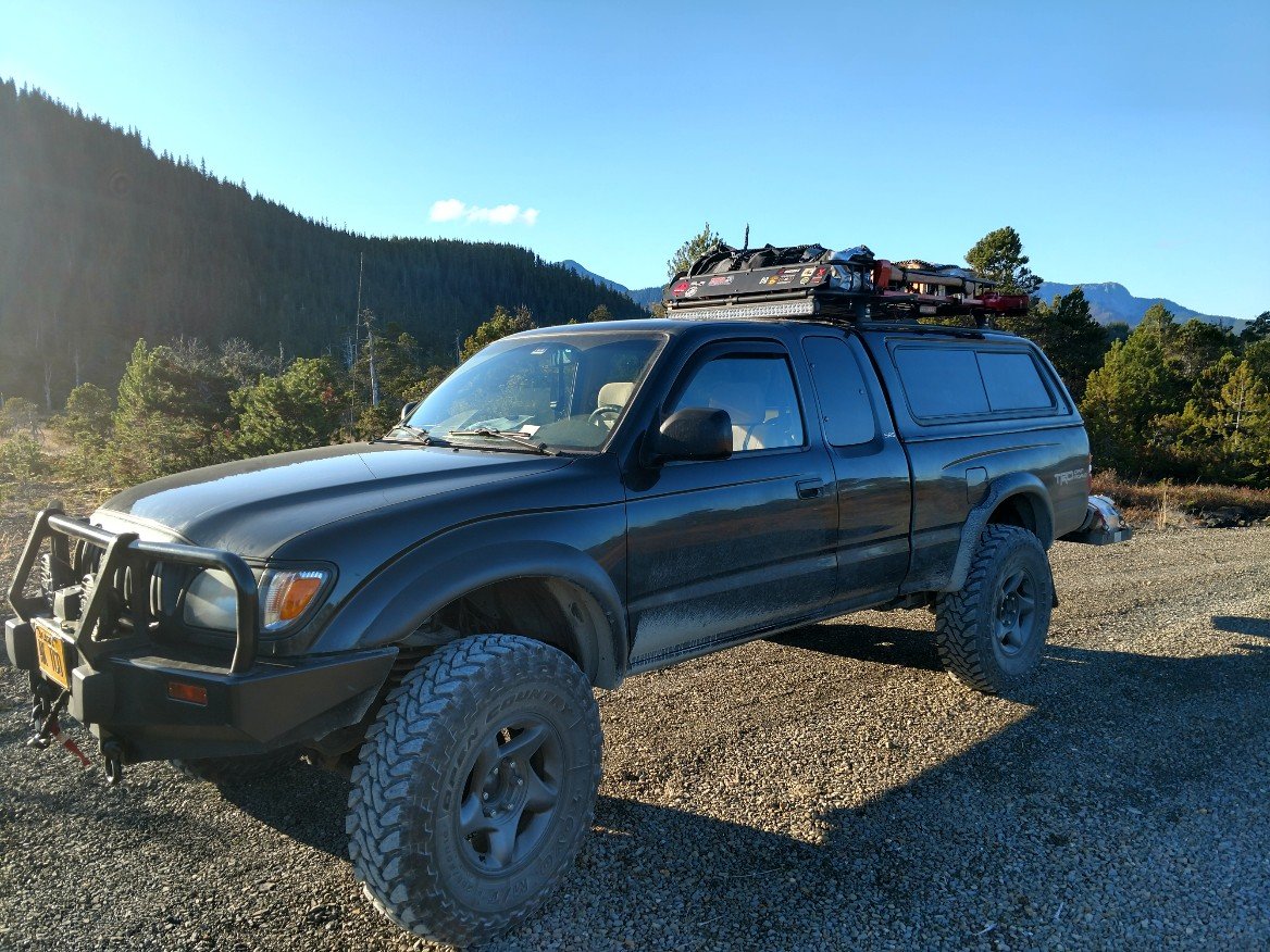

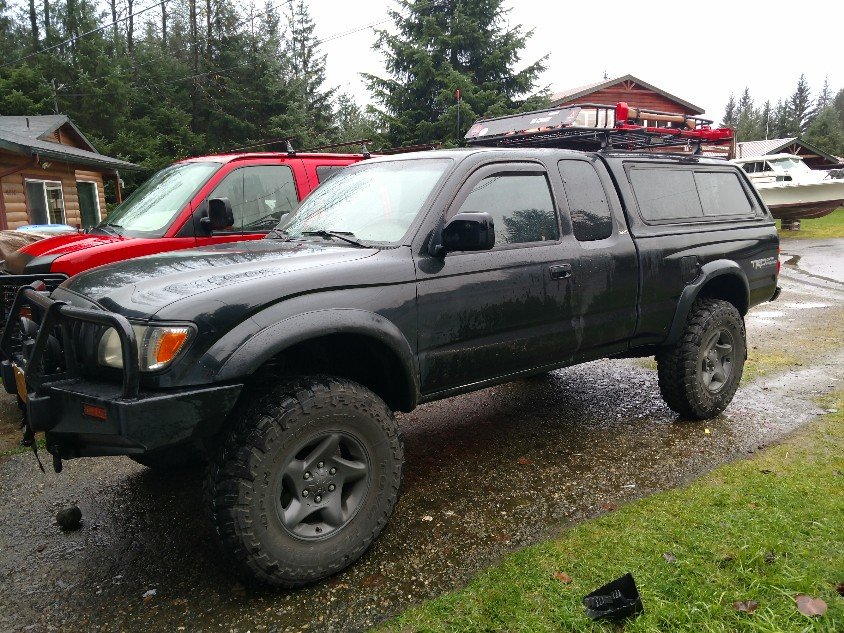

    Here is how she sat a few hours before getting on the ferry

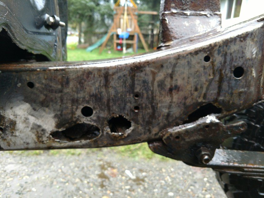

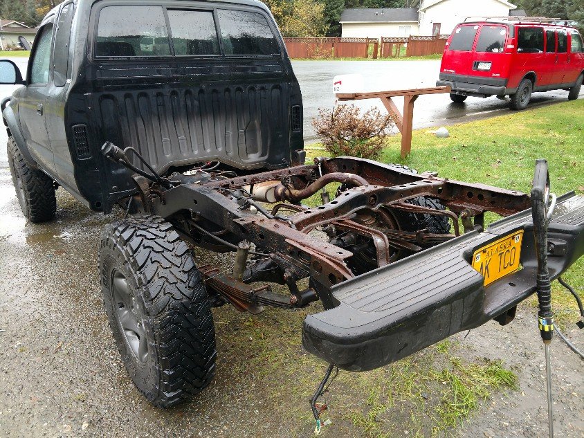

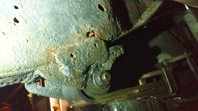

    I bought this 01' Tacoma back in Feb of 2015 and right off the bat (lot?) I was into the adventure! To make a long story short (kinda) it involved me driving the 730 miles from Anchorage, AK where I bought the truck to Haines AK where I was catching a ferry... in a little over 24 hours because I was... well...not smart. Mind you I did this alone, in the dead of winter with a few extra jerry cans, a wool blanket and lots of Monsters.
    What I though would be simple drive a bit... take a nap... make it there, turned out to be MUCH more than I bargained for. To sum it up... I took a 4 hour, 200 mile detour to Valdez because I wasn't paying attention.... I was blown off the road due to very worn "winter" tires and forcasted 90mph winds and was luckly pulled out by a helpful passer by... I nearly froze my hands off in -52 F weather spilling fuel all over myself because all the gas stations were closed... then I fell asleep at the wheel and ran off the road a 2nd time (again, being rescued by a passer by)... in the process learning that NO AMOUNT of 4x4 will help you get out of snow thats past your frame without the proper tools.... then having to deal with a flat tire because I popped the bead running off the road... and because karma hadn't had enough with me that day... spending 3 hours trying to change a flat tire with a stock bottle jack and larger tires in the middle of no where... and finally making it to the ferry in Haines with 30min to spare.
    Let me just say to those of you actually reading, this was a STUPID idea in the first place and I realize now that things could have gone a lot worse.. as in die on the side of the road in the middle of the Alaskan wilderness. I can't even use the "oh you were young and dumb" excuse... I knew better, I was just excited to get the truck and go on my little "excursion". It was a definite eye opener and a story I can tell my kids as a warning to never leave the house... or drive for that matter ;)
    That said, it was a pretty stock 01 Tacoma TRD, with worn springs, a non functioning rear E-locker, worn tires, broken window motor and other neglected maintenance items that I at least got with an ARE camper shell and for a good deal. Since then I have done the following upgrades with Pics to follow:
    Suspension:
    Eibach Coils from Toytec
    Bilstein 5100 front, 5125 rear
    OME Dakar Rear Leaf springs (+Deaver AAL)
    1" front Diff drop
    Wheels/Tires
    16" steelies all around
    255/85 Toyo MT's (pizza cutter all the way)
    Engine:
    Standard tune up items
    AirRaid air intake tube
    Deck Plate Mod
    Electrical/Coms:
    BamaToy1997 200A alternator
    AGM Battery
    9" LED xprite bumper lights
    30" Xprite light bar
    LED roof rack lights
    LED Interior lights for camper shell
    Complete wired switch panel for accessories
    Additional fuse box for accessories
    Cobra CB mounted in ashtray location
    Armor/Recovery:
    ARB Front Bumper
    4x innovations rear bumper w/ swing out tire carrier
    4x innovations skid plate
    Trail gear rock sliders
    Rear frame reinforcement plates
    Smittybilt XRC 9500 winch (hard wired switch in cab)
    Full recovery gear bag
    Maxsa recovery boards
    High Lift-Jack
    Axe/Shovel
    Accessories:
    Prinsu roof rack
    ARE topper
    I'm really enjoying this rig so far, and while there aren't many places to explore here in Juneau, I'm looking forward to future adventures. I'll make sure to update as I do mods from here on out!

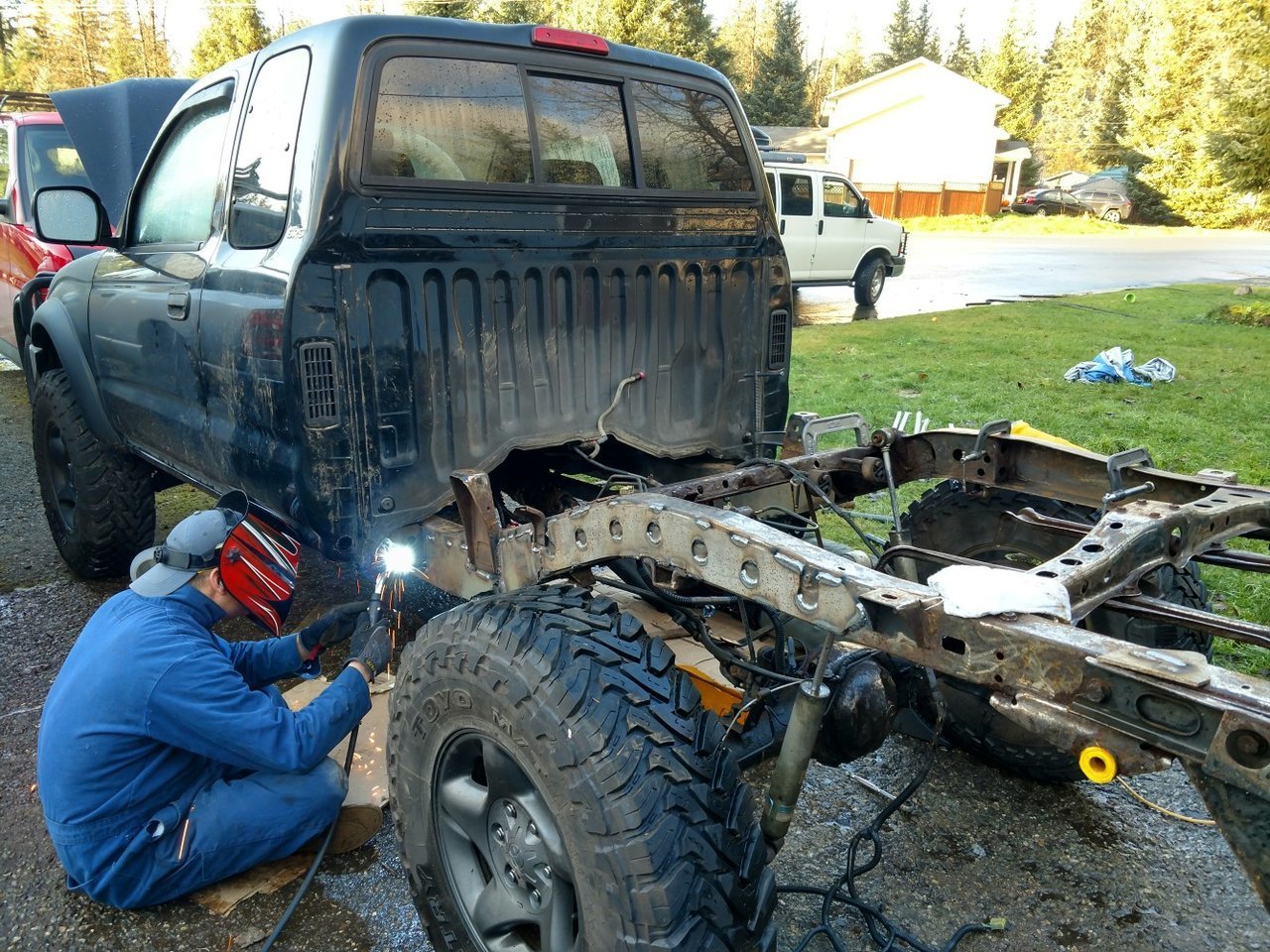

    I spent the weeknights doing the dirty work prepping and fitting, the actual welding only took a couple hours, and I had everything coated in POR15 and put back together exactly a week after I took it apart

    Truck looks great man! The frame rot on these Tacos and 4Runners are crazy.

    Thanks, it's got a bunch new pinstripes due to narrow logging roads, but to me it's a tool. I'm all about keeping this old girl on the road, so the frame repair was a must. The forward part looks great... It was just around those spring perches that it gave way. When I picked up the truck you could tell it was a neglected area.

    How are the Toyos in the white stuff? I think I want the 255s, but am think I'll need to run winters for the slush and ice that we are known for.

    They do pretty well, not quite as good as BFG's but I can't complain. I've got a friend that runs Toyo MTs on his F250 and had them sipped... He swears by them now, I might try it.

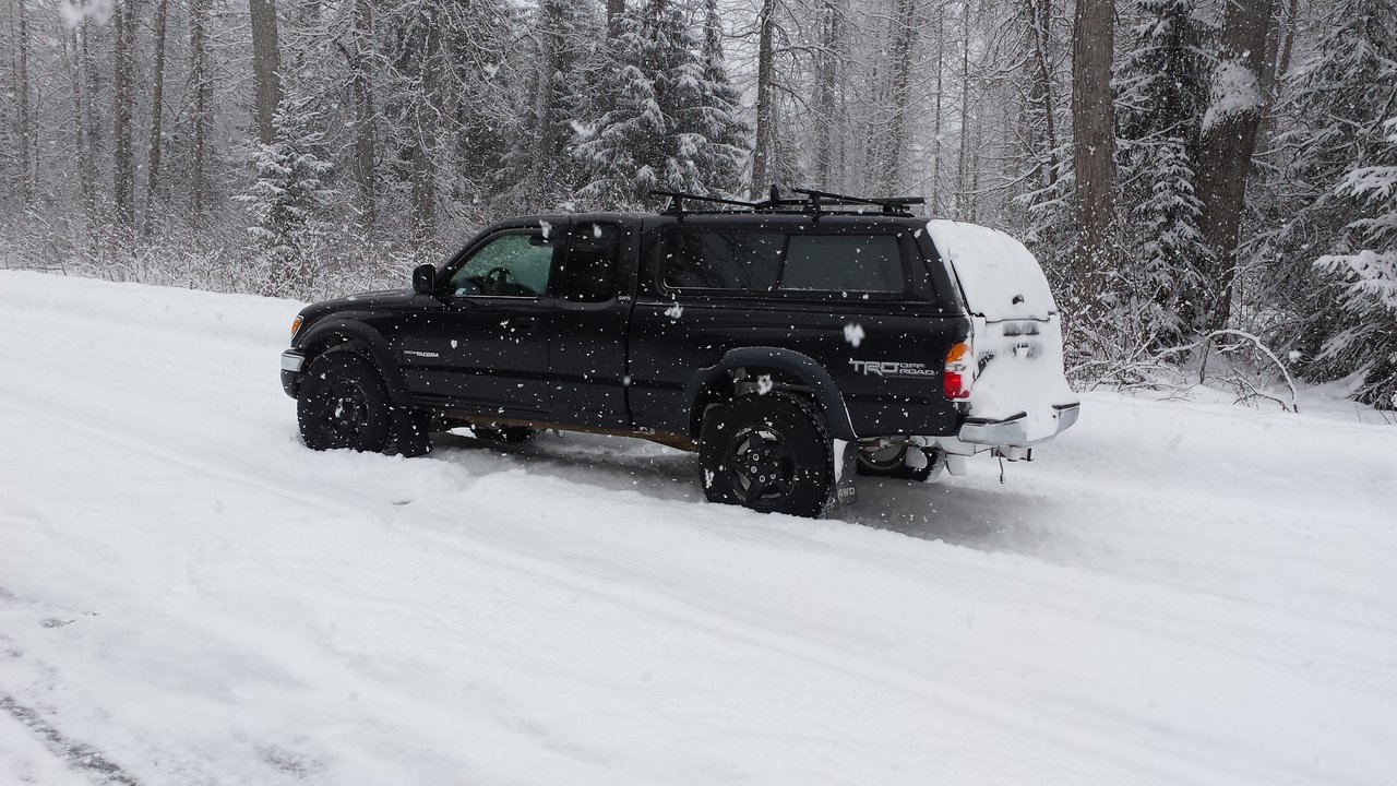

    Just got our first snow today, only a few inches, but supposed to stay below freezing for the next few weeks. Juneau is pretty mild compared to the rest of AK.

    My guess is something to do with the ocean. Kinda like west coast BC.
    Cool pic, I'm digging the 255 Toyos. They look so good :drool:
