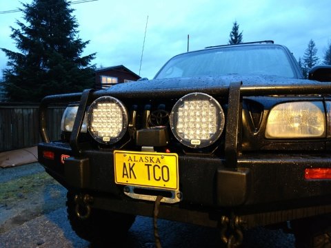

    Got some real "important" work done!

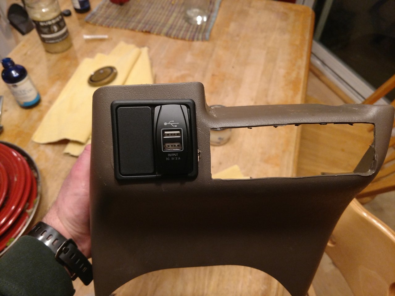

    Mounted my new xprite LED's
    Added a USB port (Amber of course!) and blank switch slot
    threw in some new husky liners (sans little boy of course)
    and switched to LED interiors from @csjumper2003

    I would appreciate some output pics of those 9" bad boys :thumbsup:

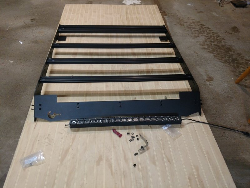

    Man I've been on hiatus for WAY to long! Was forced to leave my home state for the "lower 48" this past summer ( PCS move to the U.P. of Michigan for the Coast Guard) and it's been a rough ride, always tough to move a family of 5 with dogs and cats, selling and buying houses... Anyways, now I've finally found some time to work on the truck! Other than maintenance, big Accessory has been the prinsu rack, and a 4x innovations rear bumper I'm still waiting on.

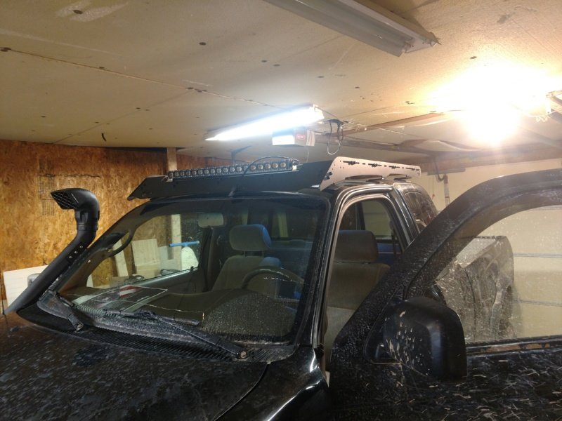

    Prinsu install was pretty straight forward, followed @BYJOSHCOOK install and modled mine after that. Putting the rack together was easy and took me about 45min, then I threw her up on the roof and started measuring and eyeing the positioning. I marked the center of the rack and aligned it with my rear view mirror and 3rd brake light, then a quick check with a tape measure and on to marking.
    IMG_20190420_232445951_resized.jpg IMG_20190420_232639704_HDR_resized.jpg IMG_20190421_001751932_resized.jpg

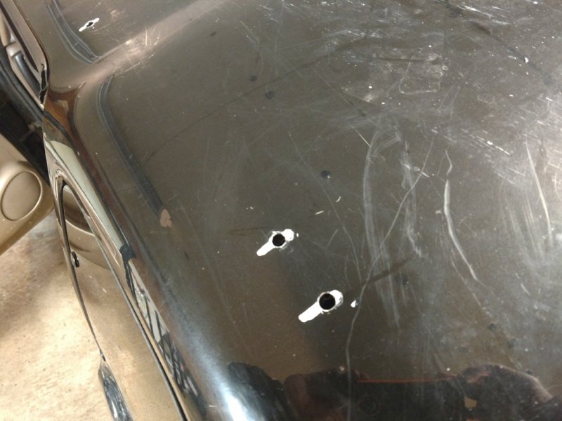

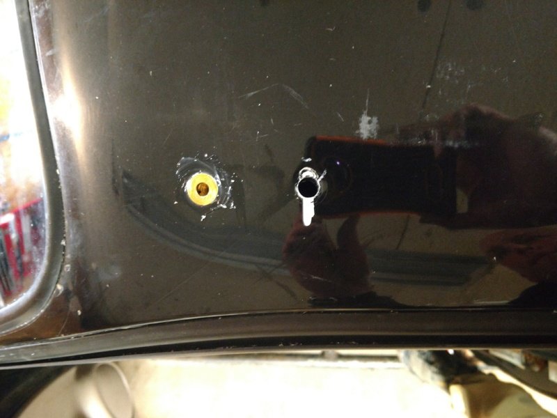

    Then it came to drilling, if you have reservations, just go for it... It's really no big deal! I worked my way up to a 3/8 drill bit.. only breaking one in the process!?
    Then it was time for the rivnuts... Used one of the bolts that came with the rack 4 washers and the rivnuts tool to install. I was sent a bolt kit meant for a double cab with the rain gutter, so I grabbed some shorter bolts cut my own rubber spacer pads for mounting, already had the rubber laying around and 2$ in bolts was worth not having to wait for replacements.
    And here she is all buttoned down, with the 30" lightbar in place. Have not noticed any leaks or excessive wind noise, and the rack is SOLID!

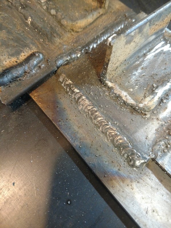

    Also picked up a Forney 140 flux welder, since this is a skill I felt I really needed to learn! Plus now I can build my own accessories and maintain the only crappy part about my truck... Rusty parts!
    Not too shabby for my first few welds I think!
