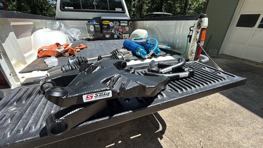

    Well…. Hello there!

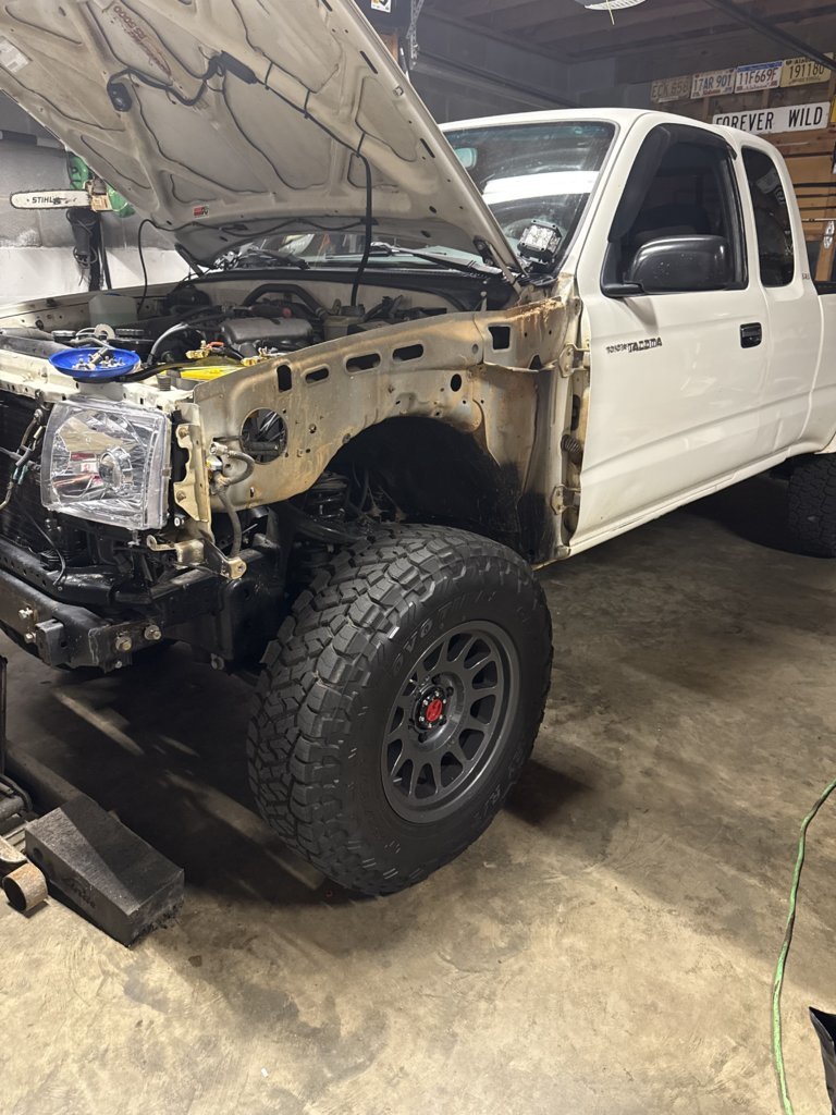

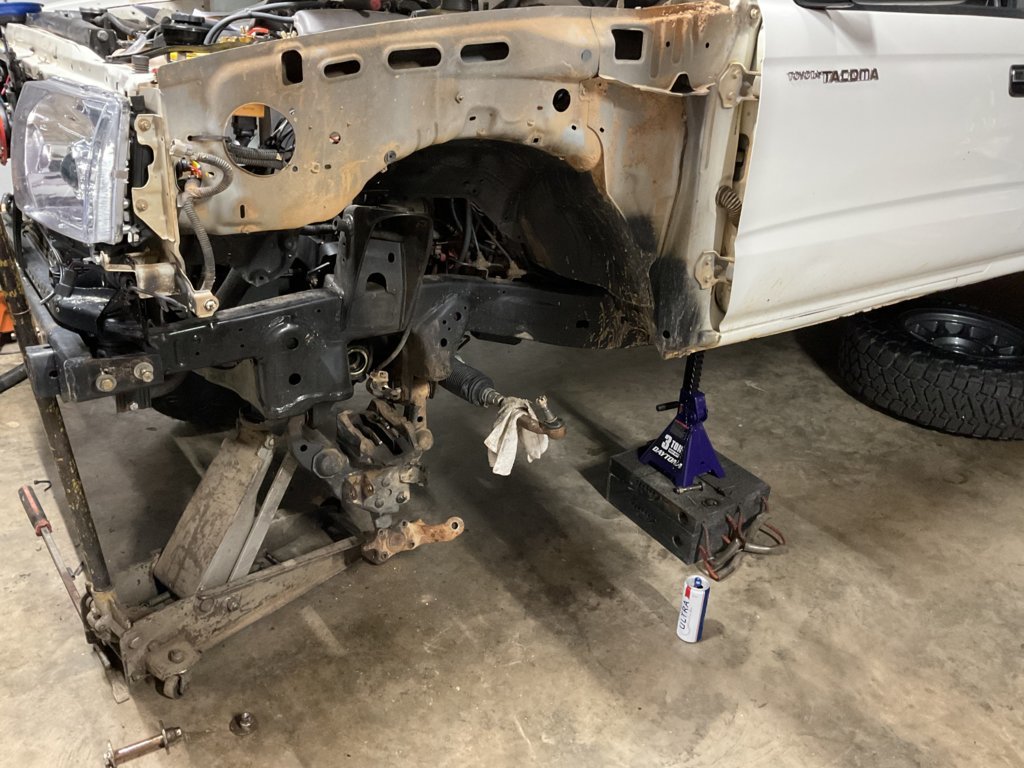

    Got a decent start on the teardown this afternoon. Noticed a few things that I’m going to have to decide on / figure out.
    • the axles that come with the solo kit are for ADD front hubs. My truck is a manual hub truck. I **THINK** I can just swap the outer joints from my truck to the new axles…. Maybe. I’ll call solo Monday and see what he says.
    • I need to decide if I’m going to do aftermarket cam tabs, to be honest, I really don’t want to mess with it….. but man, now’s the time to do it.
    • I guess I need to order fenders this week as well.

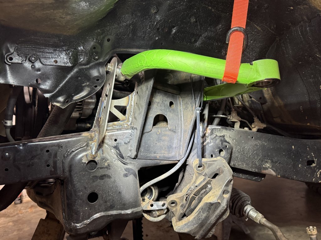

    I guess a little progress is better than no progress. Both sides are torn down. I got the solo upper arm double shear kit welded in on the driver side this afternoon.
    I may be able to get the passenger side mocked up and tacked in tonight.
    I went with the marlin crawler LCA frame brace kit, brown Santa dropped them off today. Fingers crossed that’s tomorrow’s project.

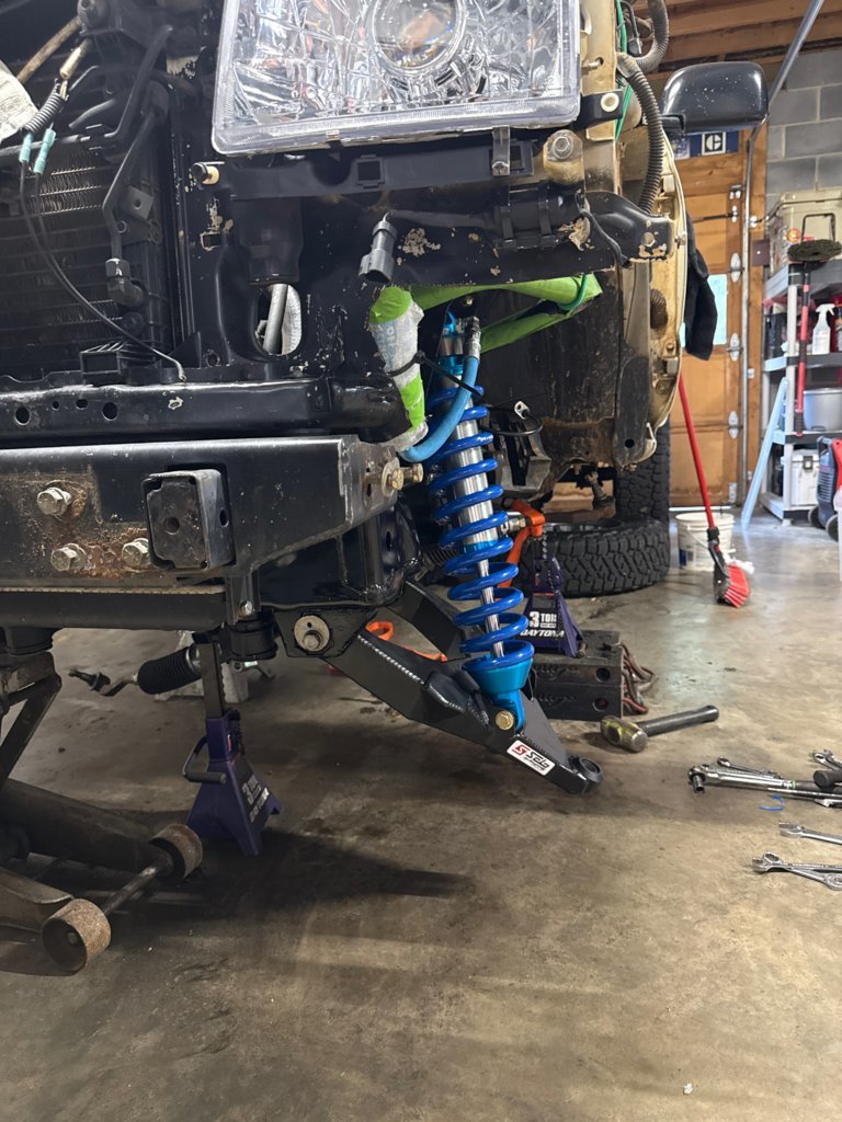

    Getting things done…. Just slowly. Luckily we don’t have any plans this weekend so I’m hoping to get it holding its own weight again.
