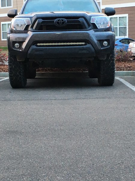

    Does my front tires looked bowed in

    Yes, but mine do as well.

    Look how it's wearing. Is that tire pressure or alignment? It was aligned earlier today.

    Looks like you're going to need UCA's.

    How do you know? How long can I got without?

    If you just got an alignment, that tells me that they couldn't adjust the camber any further. That's why your tires are leaning.
    You can leave it like that as long as you can afford to keep replacing your front tires. You're going to wear the inside of them first.

    It's different for each truck. Some need UCA's at that height, and some don't.
    It also may have helped that yours came off a truck that had a 170lb bumper sitting on them for a few months.

    Would it hurt to go back to check if they could go out more?

    Never hurts to check. They should have told you that they couldn't get it right though.

    So tire pressure has nothing to do with it? I asked them for the sheet with specs and they said they couldn't produce it since I asked afterwards. But it is for sure not aligned?
