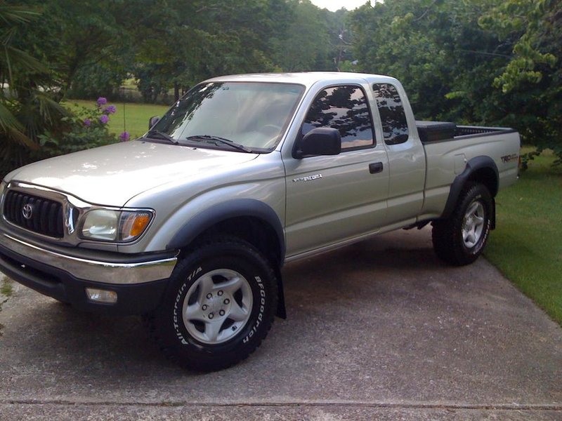

    I have always wanted to go with BFG M/T's because I've run BFG A/T's on my truck most of the time I have had her. I guess it's just a preference. I've never had a complaint either. Roll Tide! Def stuck on my tire selection.

    I wanted a more beefy/agressive looking tire now, since I will have a little more room to work with. Most likely 285/75/16. The lift is a 3 and 1 suspension. I figure that will even it all out.

    What are yall's thoughts on the Rough Country 2.5 front 1.5 rear suspension lift kit? Also, I've ordered some Cooper STT 285/75/16 's. Is that a good size tire for this type lift. I really don't want too much tire hanging out of the wheel wells. Thanks

    if you haven't already bought it yet then look at billistiens and ebitechs or OME. i am rocking the spacer on my 01 and it is just slowly tearing the front end apart, so are running 35s. billies are the best way to level out the ride without messing up the front. i look and asked a lot of questions before buying the OME for my 08. spacers are okay for dd and light wheeling but in the long run they will start messing things up. and i think for around the same price billies are gonna do the same thing but out perform the spacer.
    EDIT: that is a good tire size, i ran that size in the BFG A/Ts and rubbed some at full lock on frame. i ran 32" cooper stt with no rub nor coming close to it so you should be good, if anything minor trimming of the inner fender well plastic piece.

    Rough country is gonna have a block for the rear and that is going to actually decrease the ride quality. Do what Gator said and go with the bilsteins and eibachs or OME. You won't regret it.
