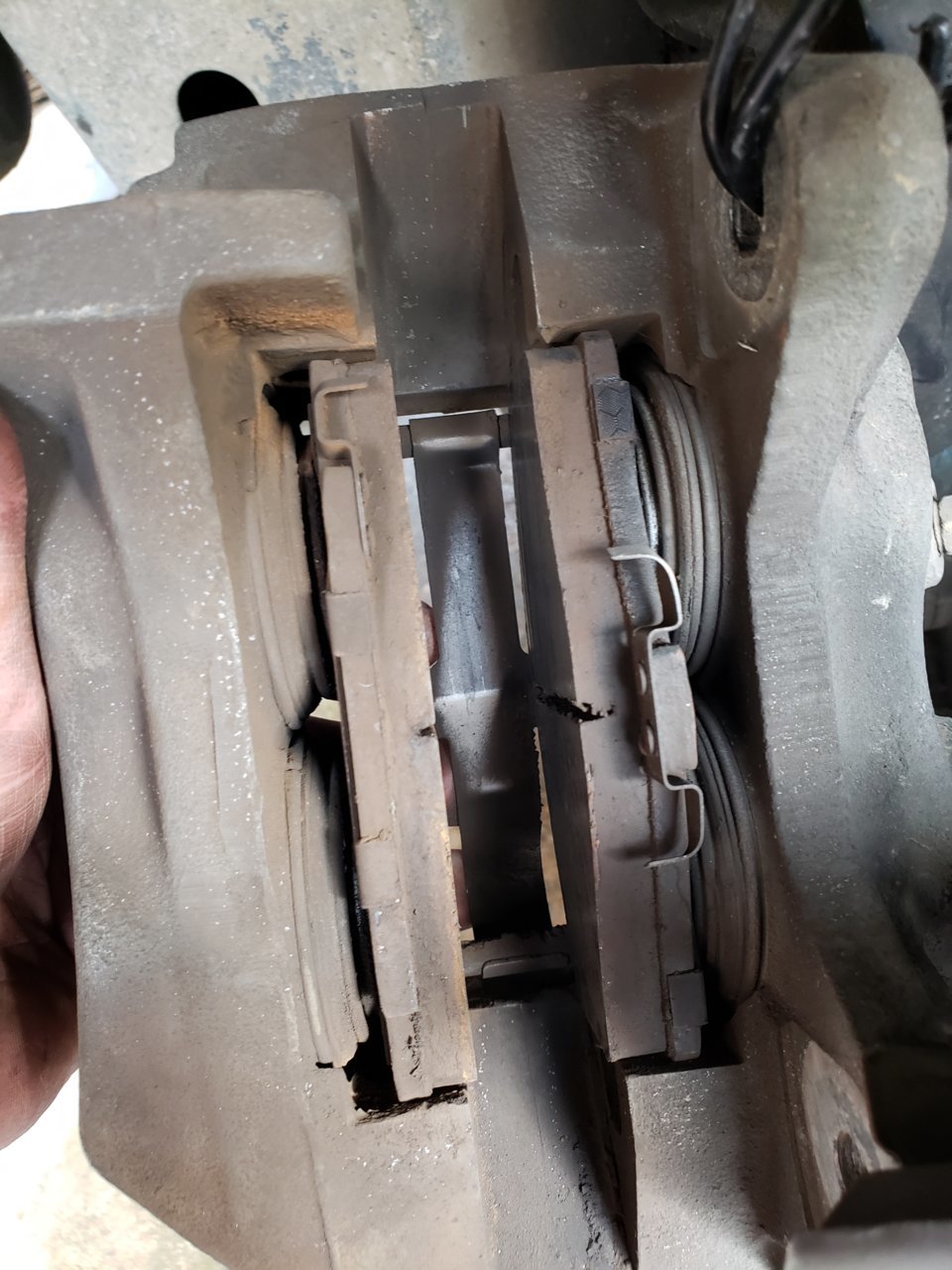

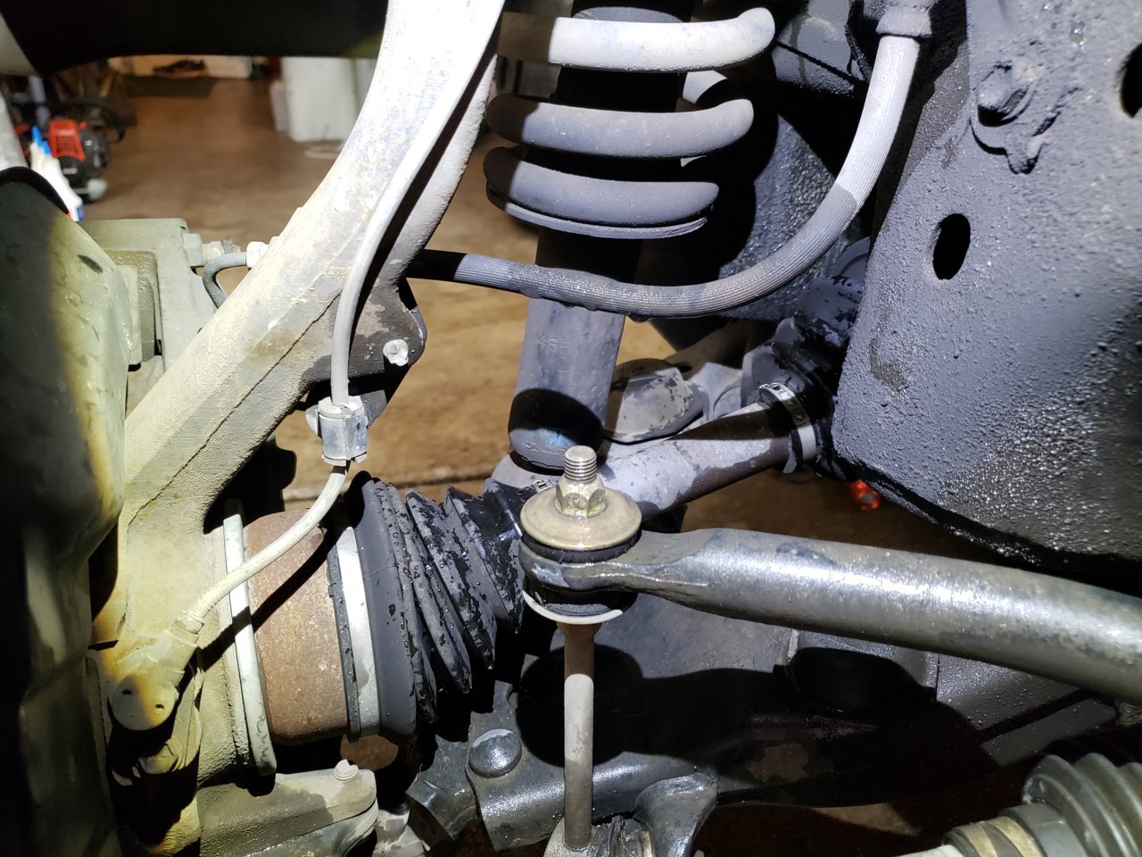

    I am beginning to think nothing is wrong with the steering wrack and that is all from some old oil leak. Like I said I've watched the oil like a hawk since I got the 4runner and never lost any. All the grease/oil in these photos looks fairly dried aside from a couple of spots. I just sprayed purple power on all of it and rinsed it now trying to wipe as much as possible away. Want to see if anymore shows up. Still not sure what causes the wobble in the front driver side.

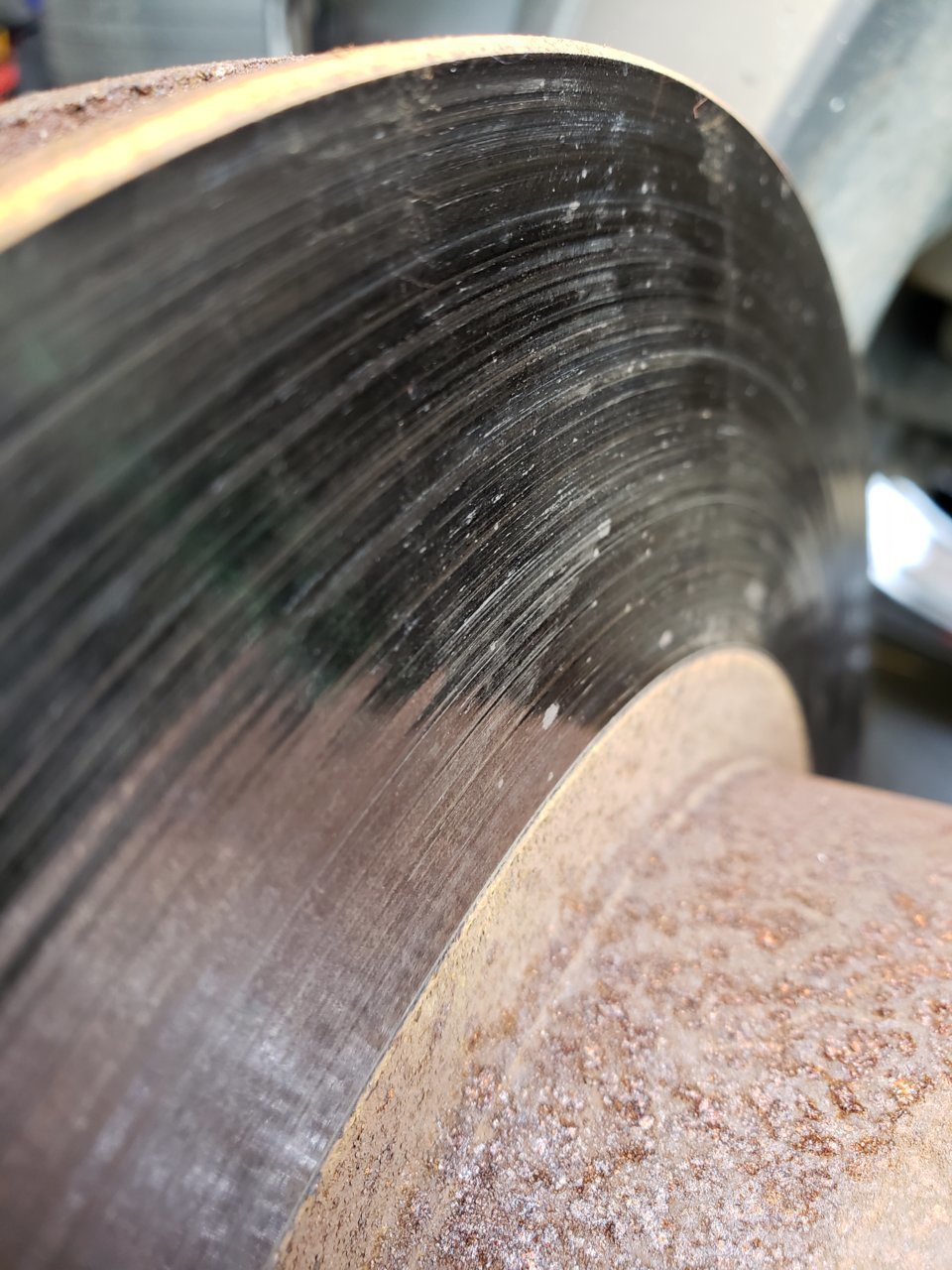

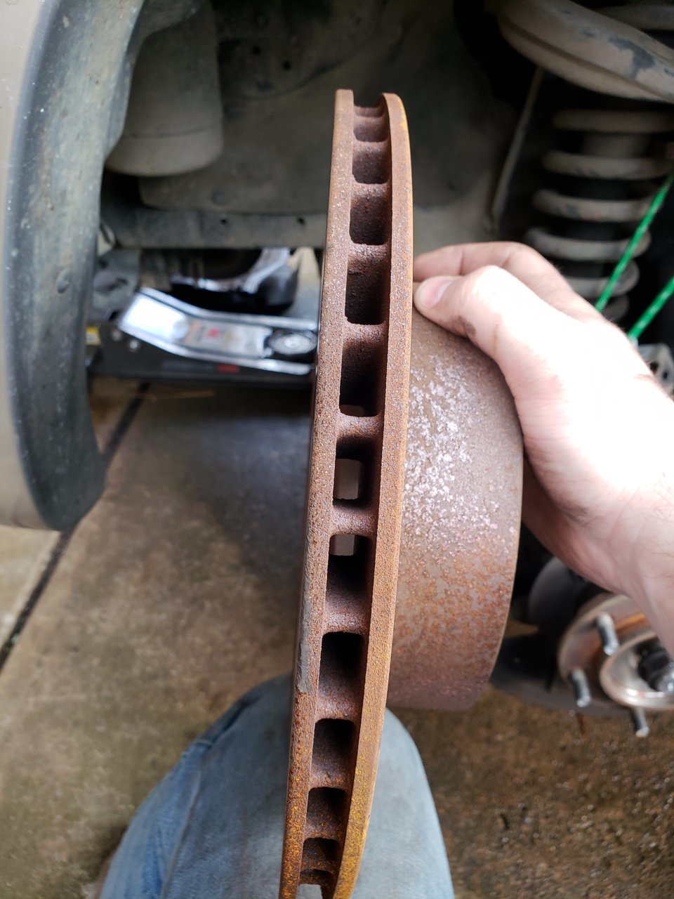

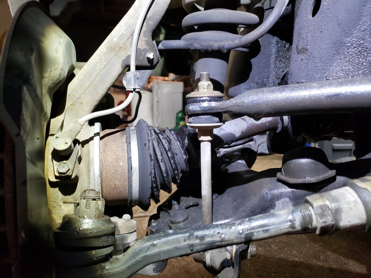

    Well I tore the driver side down, again...checked the wheel bearing first with the tire on..no movement. Tore it down to the bearing...dont have a bearing puller so stuck there but checked everything out. Rotors, pads, spun and listened to the bearing and CV and everything. Nothing unusual. Guess I might just live with it till something breaks or until I replace it all. Rotor does have grooves worn into it, but that's it. Seems straight to me, no warping. Just rusty af.
