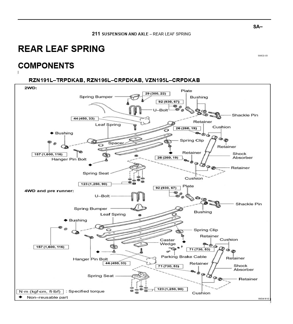

    I think that may be wrong, I know y'all's truck is not a 1st gen but mine are torqued to 90lbs according to FSM.

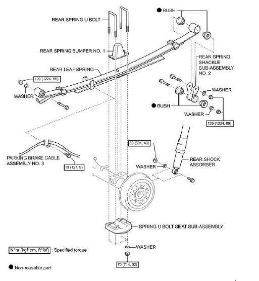

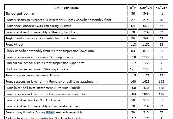

    I'm just saying what the document says. Ain't no use in arguing with me, argue with the document creator. Its says 37ft lbs in at least 4 locations on 4 different sheets.

    I'm with you mine are set to 37ft lbs. Never had a problem, surprisingly everything I have touched on my truck is torqued to that sheets specs.

    Okay - I started it last night so I'll put it to bed tonight. Thanks for all your input! I'm going to stick with my 60 ft. lbs. I found a discussion here (https://www.tacomaworld.com/threads/check-your-u-bolts.397913/ ) and the manual here (https://www.tacomaworld.com/threads/2016-tacoma-service-manual-availability-pdf.485229/page-6 ) that has the manual. Looks like the third gen is 52 ft. lbs. in one place and 37 ft lbs in another.... I'm gonna assume you are safe with either one...
