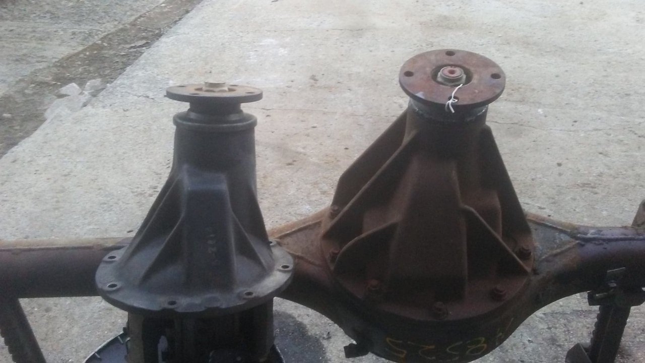

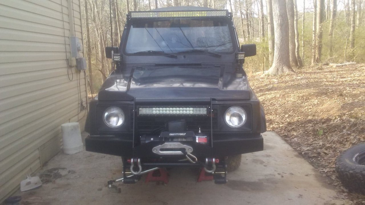

    Samurai :burnrubber:
    The Samurai is on the left and Land Cruiser is on the right, lol

    Building a 84 Toyota axle for the front and the Land Cruiser is going in the rear.
    Should not have to worry about breaking axles anymore.

    I want to put 35s on it

    It looks sad right now

    Stock Samurai transfer case has 2.2:1, I have regeared mine to 6.5:1 that's 187% lower than stock so it should be ok.
    Stock Diff gears are 3.73 the ones I'm putting in are 4.10 so that will help too.
