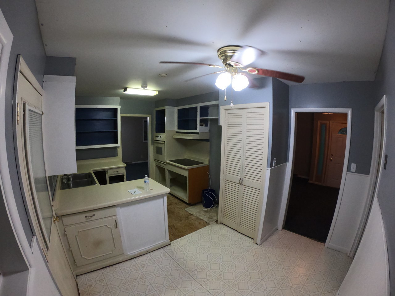

    LR fan should be a double switch - light and fan control. Entry light should be its own switch.
    why should it be a double switch? the light/fan has pull cords on it to control each one, or I might even get one that has a remote. the switch only provides the power, then the cords/remote control the options. For modernization, you should really consider a light switch and a fan switch with speed control on the wall. Pull cords and finding a remote is not a convenience.
    Are the green circles your can lights? If so, you are going to have significant shadowing when you are working on the counters. The can lights should be located over the front edge of the countertop, not the middle of the walkways.
    the green circles over the island are pendant lights. the other 5 circles in the kitchen are can lights. the can lights have a lot of throw and should not cast shadows since nothing will be blocking them. You will be what is blocking them while you are standing at the counter.

    I disagree on the switch for the LR fan. I have never been in a house that had that control on the wall, and it has never been an inconvenience. Every fan in my house is controlled by pull cords.
    I understand that I would block the can lights. The only counter space is by the sink (can light above sink, and depending on which side you're standing at the opposing can light will provide light) and then same situation at the island. The fume hood itself has lights and there are pendant lights as well. These aren't can lights that only shoot a beam of light straight down lol

    Do we need to return to the "before" version of my kitchen and see the lighting in there?

    haha thank you for your opinions, I'll comment/answer the best I can to each line.
    You're going to hit the disposer switch instead of the DR light switch a lot - if not you, your guests. Reaching over a counter is not convenient for a light switch.
    I could possibly do two separate switches instead of in the same plate to prevent hitting one and not the other, but I was trying to minimize the amount of switch plates I have on the wall. I don't think reaching over the counter is a big deal, it's not like a 4 foot stretch lol
    Minimizing switch plates is a good thing. However, it is an odd place for that light switch.
    Were it me, I'd think about adding a 3-way for the DR by the front door (porch light). Put the second switch in a location convenient to the DR (3 or 4 feet up the wall, closer to the DR).
    Putting the DR light by the front door seems weird to me because that's SO FAR AWAY. I would never want to turn the light on from that spot.
    I get that. But, are you keeping this house forever, or selling it one day?
    I'd move the pendant light switch to either next to the sink or to the island itself.
    I mentioned to the contractor that the pendant light switch can be in the island cabinets, I like that option too.
    The switch for the fan can control both light intensity and fan speed. Pull cords are so 1980's...
    Remotes are fine - except when you can't find it.
    The cans, in the position you have them, will cause shadows - independent of the throw of the light. You see, you will be what blocks the light, when the can light is behind your head.
    yes, granite. will most likely be LED lights in everything.
    Halogen bulbs put out a much warmer light. LEDs are close, but still not the same.
    Also, you want a dimmer switch on the can lights. And make sure your LED lights are dimmable.
    If you can identify a better location for the switch for the DR let me know. By the front door, in my opinion, is not a better location.
    Selling it, but as a buyer, I would also think a switch that far away is weird as hell.
    I get that pull cords are 1980s, but go into Lowe's and like 95% of the fan/lights still have pull cords. It works, and it's easy.
    there are lights located in every position that would cause concern (over the island and the sink can light). I am not doing under cabinet light as I feel with only two portions of upper cabinets on each side of the sink not much light will be blocked. See photo of previous kitchen lol
    I do plan for them to be dimmable.
    See if you follow this, picture the sink wall, in order to get the DR light and disposal switch separate but not have too many switch plates.
    in this order, left to right:
    door, deck switch, kitchen can lights switch, GFCI outlet, sink can switch, window, disposal switch, GFCI, DR light switch
    yes really. Any house I've been in and needed to flip the switch was a single power switch. I'm not disagreeing that new styles have double switches or whatever, just that my experience has never had that.
    I personally would hate to have 5+ switches on one plate, it looks tacky AF

    simply because there will already be 4 switches in that plate, 5 would look even worse.
    in my experience and preference the fans always stay ON and the light is the variable. pulling the cord for the light is just as easy as flipping a switch. easier even, because the layout of the living room you'd have to walk behind the couch to go get to the switch or you can just stand up and pull the cord and be done.
