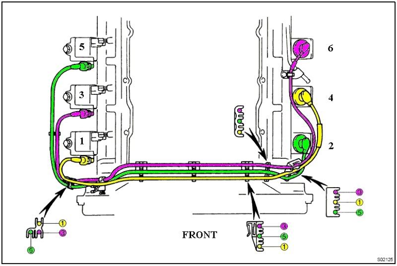

    Sounds like the throttle position sensor or a coil.
    Try mashing the gas peddle about 50 times all the way to the floor. The throttle position sensor is a potentiometer and over time it can build up crap in spots causing it to not read correctly. Mashing it several times sometimes dislodges the crap, it could be a coil too. It could be a lot of things but for me most often it has been those two things that cause that problem.

    smash it to the floor while running or not? driving or parked? I just don't want this to backfire really badly..
    coil? like with the spark plugs?

    Not running
    The coil sits on the passengers side of the engine, you have 3 coils, one on top of plugs # 1, 3 & 5
    stronghammer[QUOTED] likes this.
