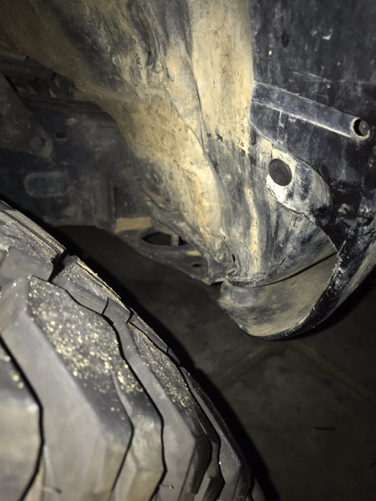

    New and improved cab chop done today :headbang:
    Alpine Designs relocate plates. Basically they take place of that monstrosity triangular piece everyone likes to hack away at, and moves the bracket further back while keeping the cab mount in the same spot. All in all it was a huge pain in the ass; but after some trial and error could be done in half the time especially if the truck could come off the ground more. Can't thank @Bigdaddy4760 Mike enough for all the help and letting me use his space :fistbump:
    A little before action. You can see with after my original chop, my tires were still eating away at it, and that wasn't even at full lock.. Time for that fucker to go..
    After some burning and grinding, same view
    The real burning man. Again without a lift, it makes this project that much more miserable
    You can see how the bracket is designed and intended here. Keep in mind I still need to do a bunch of little grinding work to clean the old cuts up, but with some time restrictions we did what was needed to finish it up; and I can always go back and clean those up another time. His welds weren't skipped though :benchpress:
    And BAM.. The clearance gained is awesome..
    At full lock. Before, the tire would start rubbing about halfway down on there.. A couple inches does wonders, ask any woman out there.. It might still look close, but with these tires this is a killer improvement
    I feel I've gained 7-33 hp from the weight shaved off as well
    And nothing better than taking numerous breaks in between to check on these bad boys. I'm gonna continue on to my meat coma. Thanks for checkin' it out! :thumbsup:

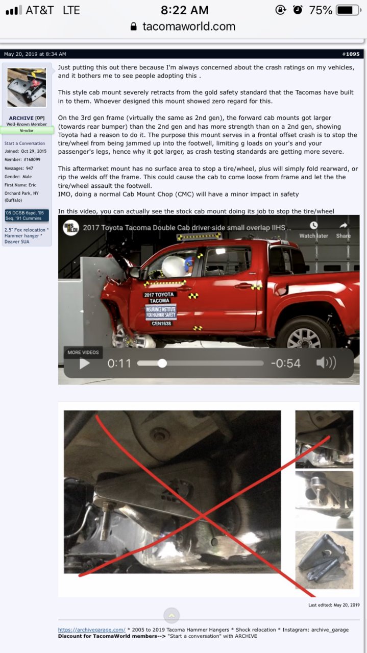

    Archive garage made a good point about those relocate kits not too long ago.

    I cant say I disagree, plus if you just trim the hell out of existing cab mount on the front side the back side should hold up to any impacts.

    That’s the train of thought that he was following as well. Even without filling the CMC back in, you still retain most of the structural support
