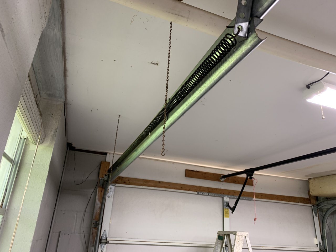

    15,587

    We have the spring version

    No springs on the tracks. The new spring winds/twists tightly as the door closes. When you open the garage door, it unwinds/twists, turning the shaft, thus aiding in lifting the weight of the door.

    Broken torsion spring. Shaft holds it safely in place, instead of flying around busting out your windshield of your vehicle, like the track springs would etc.

    Hey so I have these springs on the side of the tracks, are they the same thing?
    I just remember my home inspector put in the report that the door didn’t have safety springs whatever that means.

    I believe those spring should have a wire running through the middle of them. What's the front end of the spring attached to? A cable that's attached to the bottom of the door?

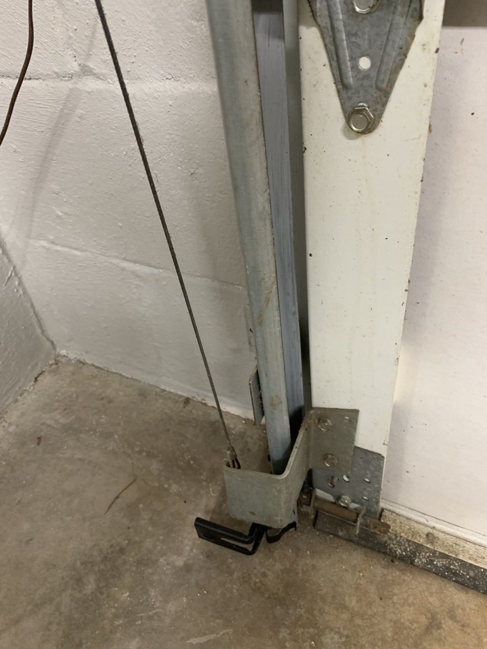

    To the bottom of the door.
    Ignore the nice black piece I’m trying to locate my new sensors

    you're right they need a safety cable so if they break they can't go anywhere.

    So I just need to add something down the middle of those springs?

    You had springs the whole time Scotty! When you open your door, those springs should be in its relaxed state. When the door is closed, they should be stretched. Those will work with your garage door opener. I heard adjusting torsion/coil springs are dangerous if you don't know what you're doing. I didn't know what I was doing, so I called a serviceman! Just run you a metal wire down the middle of those springs and you should be alright. @whitedlite, are you a garage door specialist?

    They sometimes have a cable running through the spring to prevent them from slinging around when not if they break.

    Thanks Scotty, and that cable is all that's needed.
