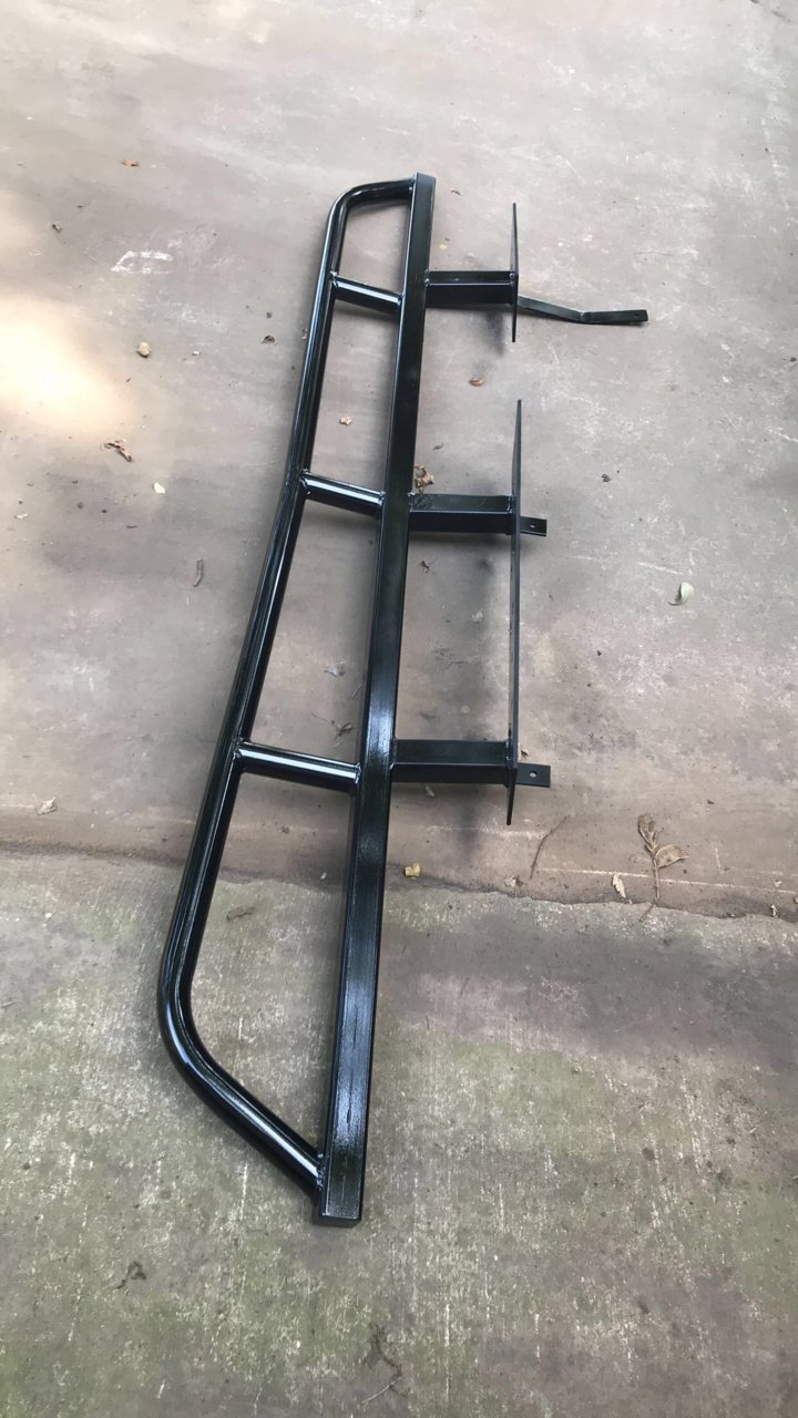

    It's different. There's only so many ways you can build some sliders!

    the front should "push" the truck off of stuff...I feel like that's going to get hung on something with that hard flat face stuck out that way...

    Seems like an additional cut that's not really necessary. I could see that potentially funneling a branch or something in between the slider and truck body.

    Looks like a good place to snag a rock coming out from under your front tire and jack up your sliders. But that could just be me. Maybe it looks better on the truck.

    Like Wes and Scotty, it does look like it would funnel brush and all kinds of shit towards your truck if it gets caught behind that front angle. My RCI ones are about 1.5" shorter in the front than the ones I got from Wes and 3/8" away from the pinch weld all the way down.

    I like the design of mine a lot. Gives me plenty of pertection! Can’t wait to use em!
