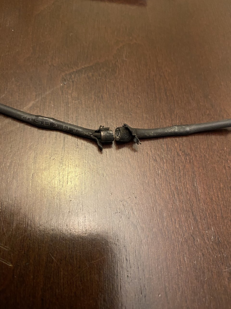

    Now I confused, You saying the red and yellow is power from the ignition is connected to the red wire coming out of the fuse box?
  2. Dec 6, 2019 at 7:50 PM
    JBTacoma
    JBTacoma Well-Known Member
    Feb 16, 2015
    #148844
    11,118
    Jeff
    Cullman Alabama
    2000 SR5, 2003 Double Cab and a Suzuki Samurai
    It should have blown a 10amp fuse long before it melted a wire.

    Red and yellow wire is connected to fuse box. I
  4. Dec 6, 2019 at 7:52 PM
    Brian422
    Brian422 I fell into the pit that is TW
    Jun 8, 2011
    #57958
    15,688
    Brian
    Birmingham, AL
    2012 DBCSB F/R Locked, 35's ,Long travel, 23 Tundra 4x4 limited
    Not Stock
    That’s what I’m saying!

    It almost looks like this was designed to fail here in case of heat

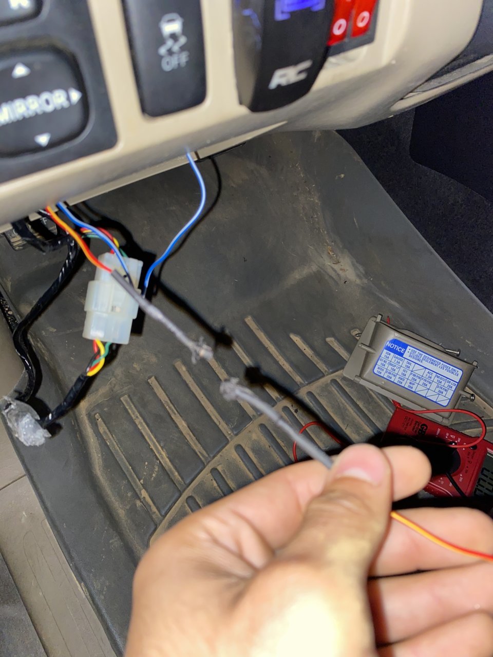

    You should have one 12v running from your switch on your dash that runs to the relay to trip the relay and one 12v running to the relay that runs through the relay that powers the compressor

    Is it an inline fuse? if it is then your problem is some where along that wire?
    Trace that wire from one end to the other to see if it is shorted out some where

    You melted the ARB harness or is this some make shift stuff?
    I’d be nervous if wires are melting under the dash. Definitely get some bigger gauge wire for that much power going through.

    So I repaired the connection and everything works as should! JB I’m going to let you look at it tomorrow before we ride to get your input. Idk if the wire melted or that was how it was designed to fail if a surge of energy hit that one spot. I can say it failed when I switched it on. So it sounded like a fuse issue or power surge but no fuses were blown

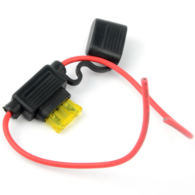

  13. Dec 6, 2019 at 8:13 PM

    That wire you showed was most likely a inline fuse like this one.

    Yes it was! It blew!

    Should I replace the fuse or just leave it? ARB had been working fine for months?

    You need a fuse there then, get one like this one
    I would not put those wires back together without a fuse, something made it blow. if a fuse is not there to blow then it could cause all kinds of problems or a fire.

    Looks like an inline fuse, who wired the compressor?

    What size fuse?

    Arb stock harness
