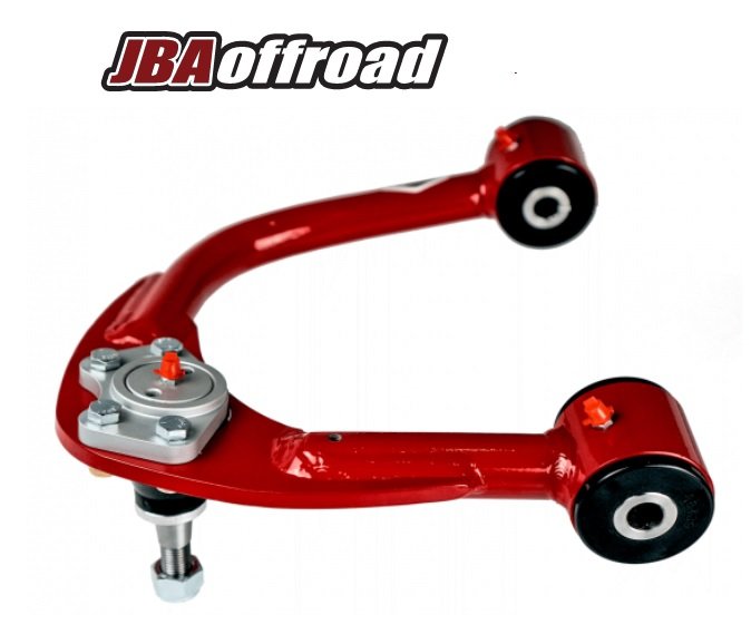

    Do you ever plan on running a tire bigger than 32 inches?

    They are not recommended above 32 unless you buy wheels with less back space

    From JBA website
    Please Note: 32.7" and larger diameter tires need aftermarket wheels with less then factory wheel back space.
    • LT285/70R17 (32.7" x 11.2") tire on 17 x 9 wheel, -12mm offset (4.50" backspace)
    • LT285/70R17 (32.7" x 11.2") tire on 17 x 8.5 wheel, -9mm offset (4.30" backspace)
    • LT285/70R17 (32.7" x 11.2") tire on 17 x 8.5 wheel, 0mm offset (4.75" backspace)
    • LT285/75R16 (32.8" x 11") tire on 16 x 9 wheel, -19mm offset (4.25" backspace)
    • LT255/85R16 (33.10" x 10") tire on 16 x 8 wheel, -12mm offset (4" backspace)
    • LT315/70R17 (34.4" x 12.4") tire on 17 x 9 wheel, -25mm offset (4.00" backspace)
    Tire sizes that work well with the JBA UCAs
    • 265/75R16 tire 31.6" x 10.4" on factory wheels
    • 255/75R17 tires 32.1" x 10" on factory wheels
    • 275/65R18 tires 32.1" x 10.8" on factory wheels
    • Any tire that is 32" diameter and smaller there is no fitment problem.

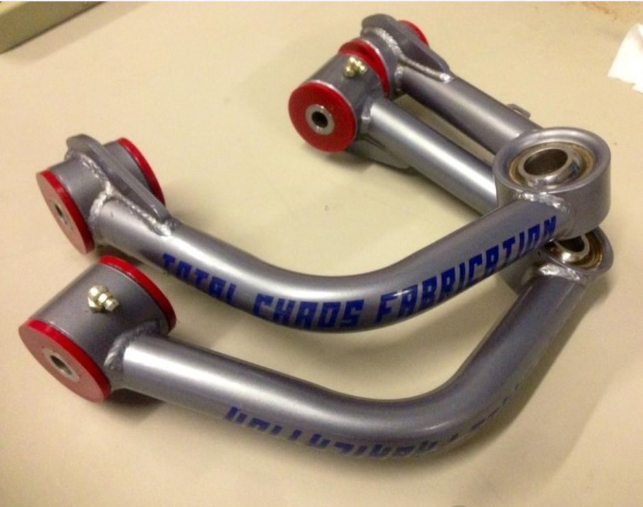

    Might be something you want to think about. They have a lot more metal sticking out past the center of the ball joint than other UCAs, that gives you less clearance between the UCA and your tire. Not sure if you plan on offraoding them but if you do when you air down your tire will get even wider and that may be an issue there too.
  14. Jan 29, 2020 at 3:07 PM
    cubie
    cubie Aznrednek
    Jan 9, 2019
    #278739
    14,675
    Jonny
    Sweet home Alabama
    '06 and '18 TRD OR 4x4 Access Cab
    Are you running the TC arms?

    Sweet home Alabama
    I see that TC and Camburg arms look very alike. I guess there's not much difference between the 2? I know Camburg's have been around for a long time.

    All of the uniball arms look similar and offer about the same amount of camber gain. You throw an icon up there it'll look about the same too. JBA offers an HD version and a little more built in camber.

    I run the JBA's. Only rub very very very slightly at full lock only when aired down.
