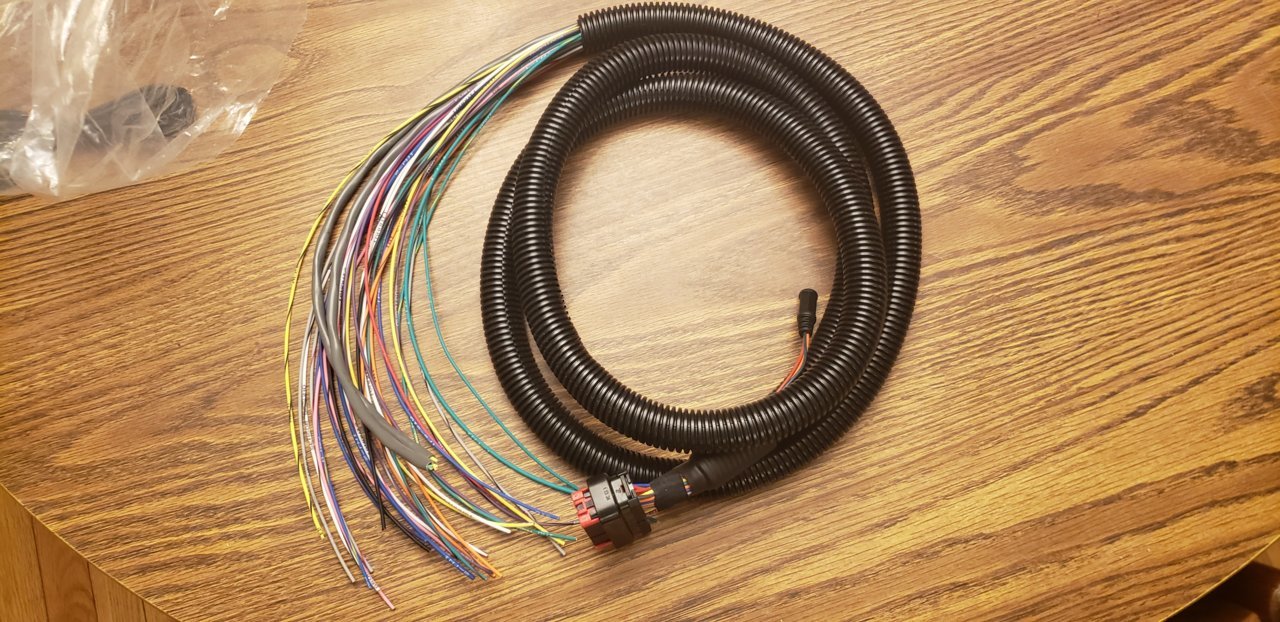

    Yes and to supercharge it
    Once I get all these wires connected

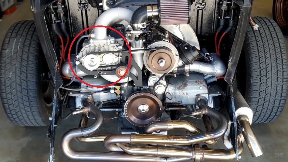

    Gonna use this supercharger, VW guys been using it for a while
    JEtaco03, cubie and tweakit88 like this.

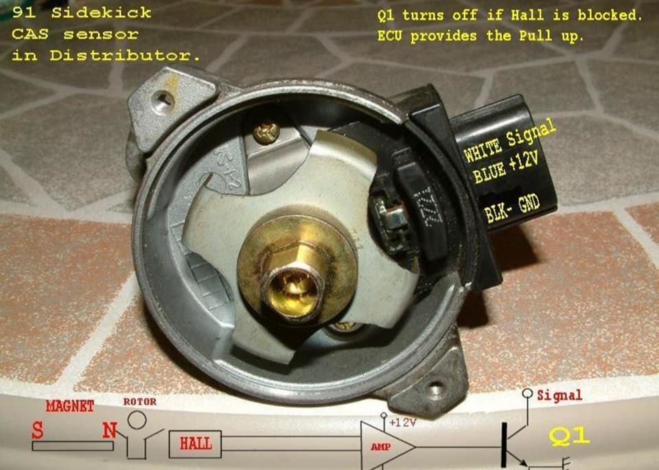

    This is the Geo Tracker distributor before the mods

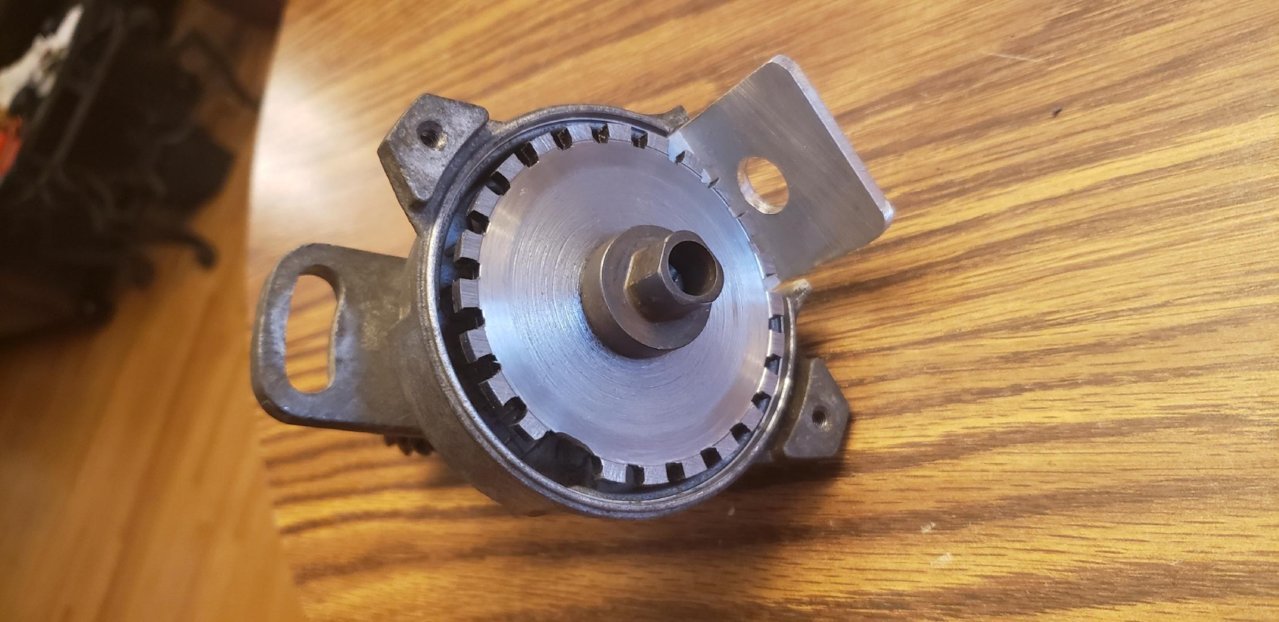

    This is after the mods, with a 24 to 1 missing tooth wheel made out of a chainsaw sprocket, the Hall effect sensor goes in the hole in the custom bracket lol. That is where I will get my crank signal.

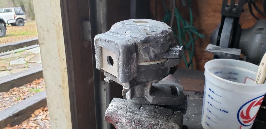

    Modded the distributor cap to make a cover for it, I got the fiber glass work done now comes the bondo and sanding.

    The 500 that Jeff posted is actually the 160 cause it says 167 w/h if you look at it
