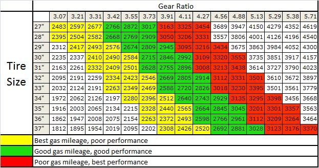

    This chart shows how to pick gears, yellow for fuel, red for performance and green for both.
    But you need to consider weight too so if you have a lot of weight you may need bigger gears.

    Yeah 5.29 way overkill for a 33” tire :). Too bad someone with a manual trans didn’t want to swap gears. That chart shows 4.30 would be great.
    I watched a YouTube vid a while back on gears where the guy showed the mathematical calculations to determine gear size and basically said same thing you did about accounting for weight as well and if in doubt go up to next set of gears.
    cubie likes this.

    Its my opinion and lots of others that the 3rd gens should of come from the factory with 4.88. On a 100% stock truck 4.88 is perfect. Folks like me and you that add 33's+ heavy steel bumpers and camping gear and or pull trailers, we need extra help. So 5.29s are perfect. I can tell you that untuned with 5.29's my truck is still slightly annoying to drive. So i would reccomend to anyone with bigger tires or any kinds of mods that add any kinda of weight dont wast your time or money on anything less than 5.29's.

    I have 4.30 and it is a good balance for me on and offroad.
    By the chart it does show 5.29 as an overkill but that is at stock weights. If I regear I will be going 5.29 just because of the power it gives at low speeds.

    This chart doesnt take our 2 overdrives into account either. It may be accuate for jeeps, 1st gens and 2nd gen tacomas but not ours.
