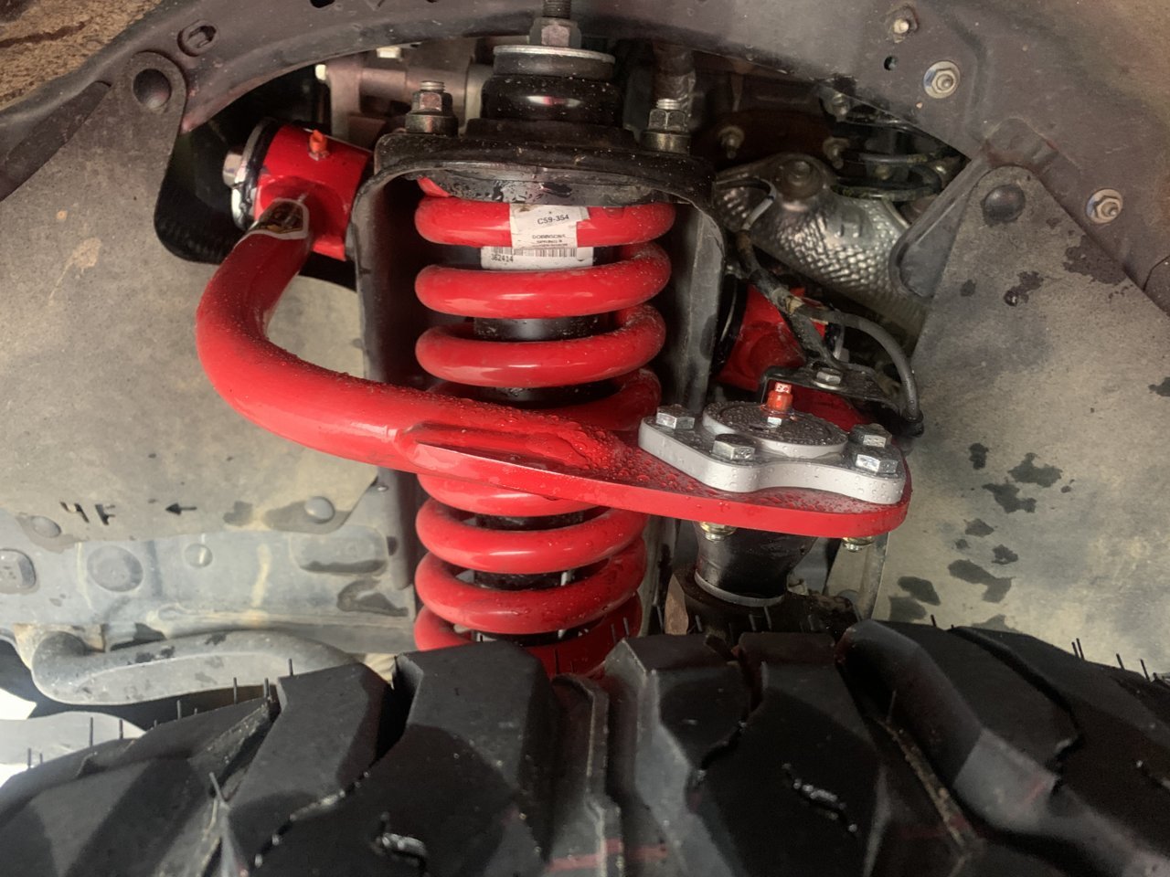

    Out of alignment shop and rubbing so bad it’s unreal. Probably gonna swap UCAs back to factory because this is insane. Can’t even turn the truck hardly.

    Something is wrong if you're still rubbing that bad after alignment. That's very odd. Everything was assembled correctly I assume?
    My alignment data after it was done. Post up pics of yours.

    You didnt get the stamdard non castor arms did you? Also what did he alignment shop set castor to?

    Here is the alignment sheet.

    Those numbers look within spec to me. Is there a part number on your UCAs? I'd get with JBA, they have great customer service.

    I’m contacting them today. Something ain’t right. I have about 1-1/2” of space between wheel and fender when truck sitting still and tires straight. I had over 2-1/2” before new UCAs. Truck shakes bad and sounds like it’s about to rip something off my truck turning hard left. Does same but slower when turning right.

    What are you rubbing on now?

    The alignment shop probably rotated the wheel back.
    Watch this video to see how to set max caster. Set max caster by rotating the wheel forward, then adjust toe and camber into spec. That's what moves the tire forward as far as possible. I've had shops screw up mine before by just looking at the screen, not used to making clearance for bigger tires.

    Here’s what jba says.
    Brandon,
    I am Sorry, I do not know where you got this idea (was supposed to help push the tire forward to fit a larger tire on my Tacoma) We do not state that claim on our website!
    To achieve High Caster, the upper ball joint is moved back toward the cabin, the alignment tech moves the lower ball joint forward. The caster should be set between 3.0 to 4.5 degrees.
    What a good front end alignment will do for your vehicle. The toe and camber set properly to the factory spec will reduce tire wear.
    Caster set properly will give your vehicle stability at high speeds and return your steering wheel to center when you go around a corner.
    If you have tire rubbing when the alignment is set properly you will need to do some trimming.
    Changing the alignment to eliminate tire rubbing will reduce the performance and handling of the vehicle. Having a vehicle that handles well eliminates driving fatigue and make for a more enjoyable time on the road with friends and family.
    Marlin Gehman
    JBA Offroad
    Brian422, cubie and InfernoChalupa like this.

    He is correct,
    The alignment should have pushed the lower control arm forward which would push the tire forward.
    Check to make sure you have the correct UCAs

    Sounds like they tried to set the alignment close to factory specs. 3 degrees caster should be easy to achieve with aftermarket UCAs.
