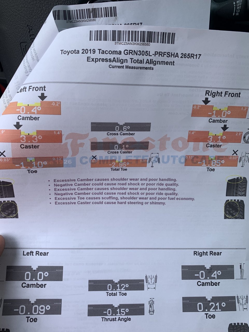

    Before pic

    Damn, looks like they aligned it backwards! lol Those caster numbers should be what you have AFTER the alignment! Go back and tell them you want to keep those caster numbers and THEN adjust the camber and toe. Looks like they tried to bring you back to factory spec numbers.

    They gave you less caster

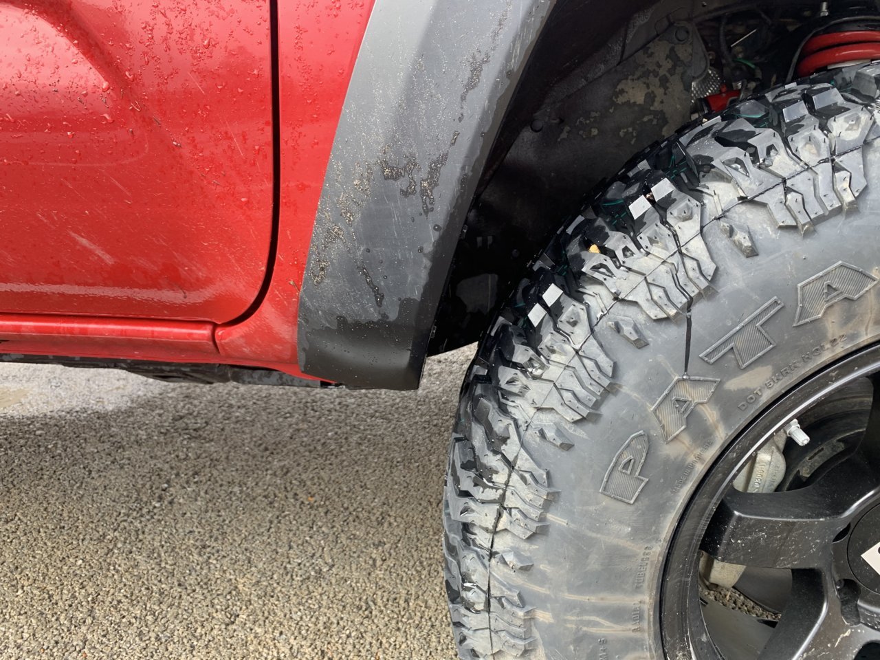

    Here’s pics of the gap sitting straight. Can’t even fit a 2x4 block in that gap in it.

    There should be a bigger gap at the rear of the tire if the caster numbers are higher. Take it back to the alignment shop and tell em what you need. A competent one should be able to keep your original caster numbers and adjust camber and toe around it.
