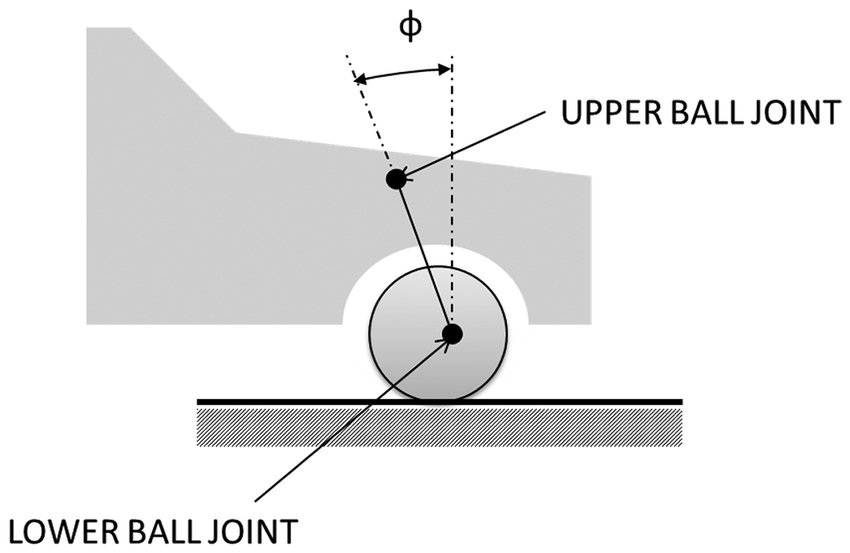

    JBA control arms have built in + caster which means they move the top of the knuckle back, it does move the knuckle back but very little. But an alignment moves the knuckle forward much more than the top moves it back. When he got the alignment they took caster away and unless you tell them you want a custom alignment and what you want they will put it as close to factory as they can.
    The lower ball joint is what moves when you get an alignment. Positive caster moves it forward, negative moves it back, the top ball joint does not move.
