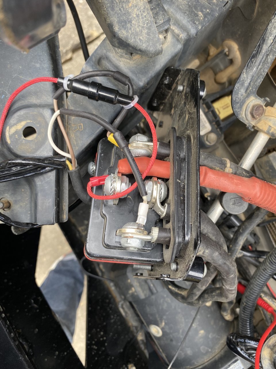

    @JBTacoma i need help diagnosing my smitty built winch issue. Winch is getting no power. @tweakit88 and I worked on it for a bit yesterday and opened up the control box to find a couple of corroded leads. Cleaned them and still nothing. I think the solenoid May be the issue. From what I’ve read it seems to be a common issue with them.

    Do you have the wireless winch

    No it’s the 9500 and it’s not the controller because I tested it with mats in his works

    Do you have power coming into the control box?

    @Brian422 If you have power in the control box check the inline fuse inside the control box

    Power is coming from battery but not from control box. Just tested with meter

    Checked that yesterday and it was not blown

    The small fuse inside the control box?

    Yes. Solinoid looks to be getting power from the leads in the box actually.
    could it be a bad ground on the winch itself?

    Since you had corroded wires in the control box I would remove all the wires coming from the battery to the winch and clean them. A lot of people have problems with the wire corroding where they connect to the winch, especially the ground cable.
