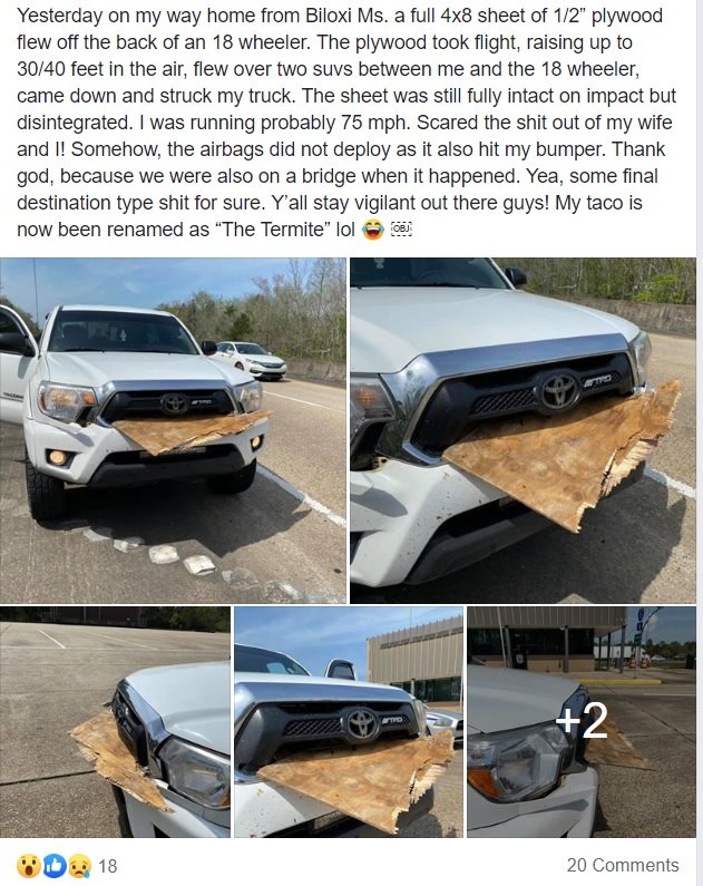

    Damn, luckily that didn't come through the windshield!

    I saw that on FB lok 15 min ago. Thats wild

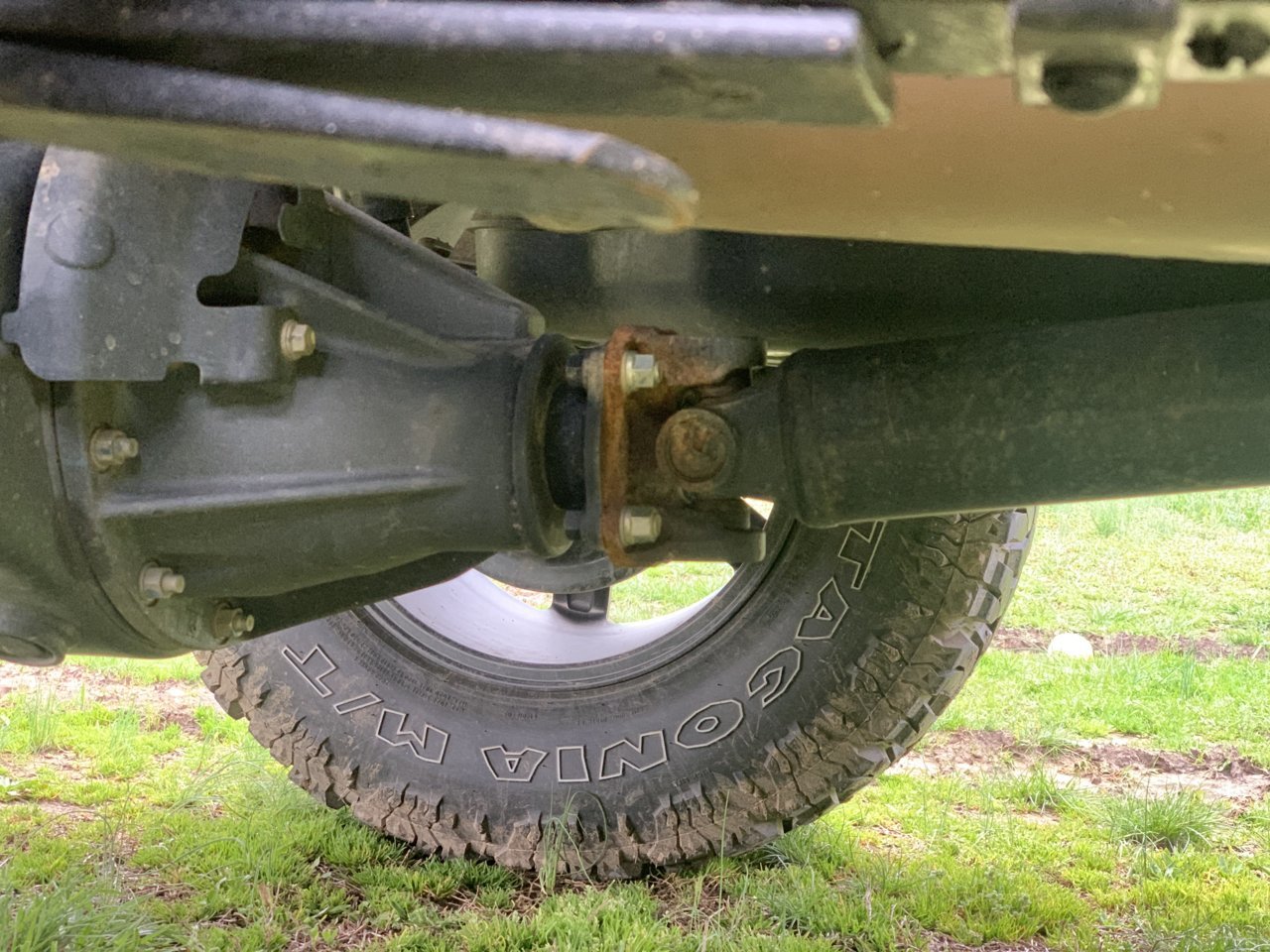

    Here’s a pic of the rear drive line angle. Not severe but definitely not ideal.

    Mine looks about like that. The CB drop kit did help a bit, but I think those 2 degree 4crawler shims will help tremendously. I watched that video that @JBTacoma posted and another one like it here on TW and it gives tons of info about your driveline angles. I picked up a digital angle gauge from Lowe's for $30. Helped me determine to go with 2 degrees.

    No clue on the video. Must have missed it. As for angles I’ll just use a straight edge and math :). Save me $30 and a 45 minute drive to jasper Home Depot.

    Make sure you get shims that bolt to your leaf pack. Not ones that slide in or just sit there.

    I got the 4crawler steel ones with longer center pins, the man sure knows a thing or two about building custom shims! I plan on knocking it all out when my Archive flip kit/bumps come in.
