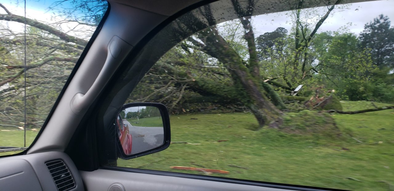

    Lot of trees down close to me but I have only seen mild damage to any structures
