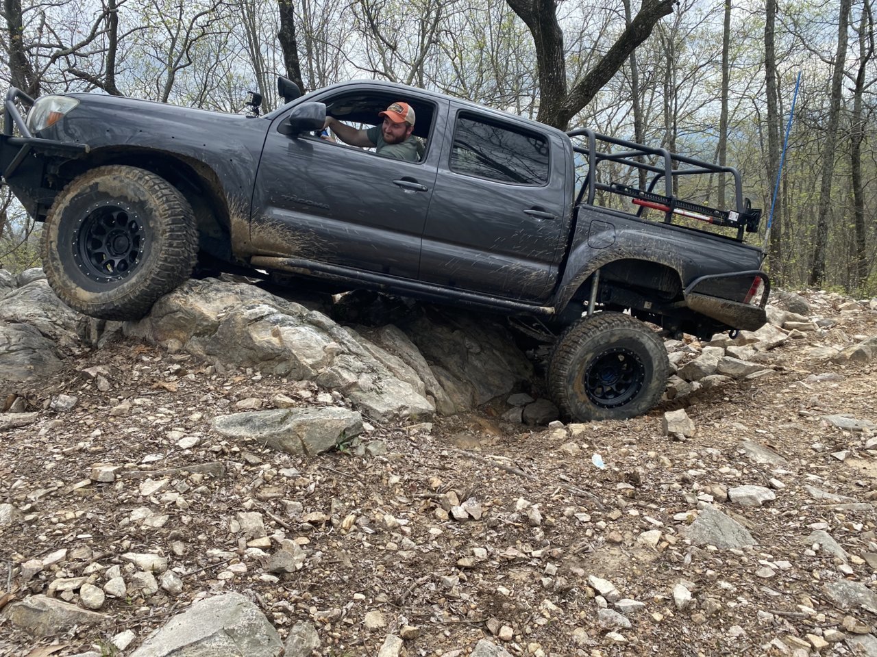

    on rubicon at that spot Trey got a photo (see below) when I was backing off of it, man it jerked my whole front end to the right real hard and slammed. we think just into the steering stops but not sure. it took the steering wheel out of my hand. just wasn't sure if it was somehow related to that.

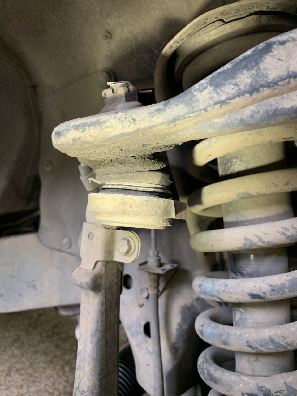

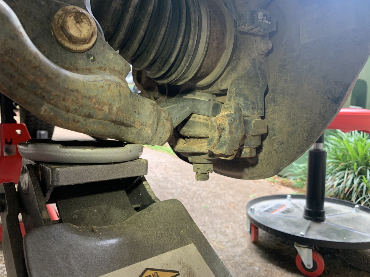

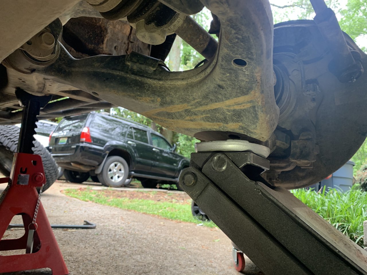

  18. Apr 13, 2020 at 2:49 PM
    stronghammer
    stronghammer STTDB
    Jan 8, 2016
    #174366
    35,132
    Scotty
    Huntsville, Alabama
    2011 MGM DCSB TRD Sport 4WD

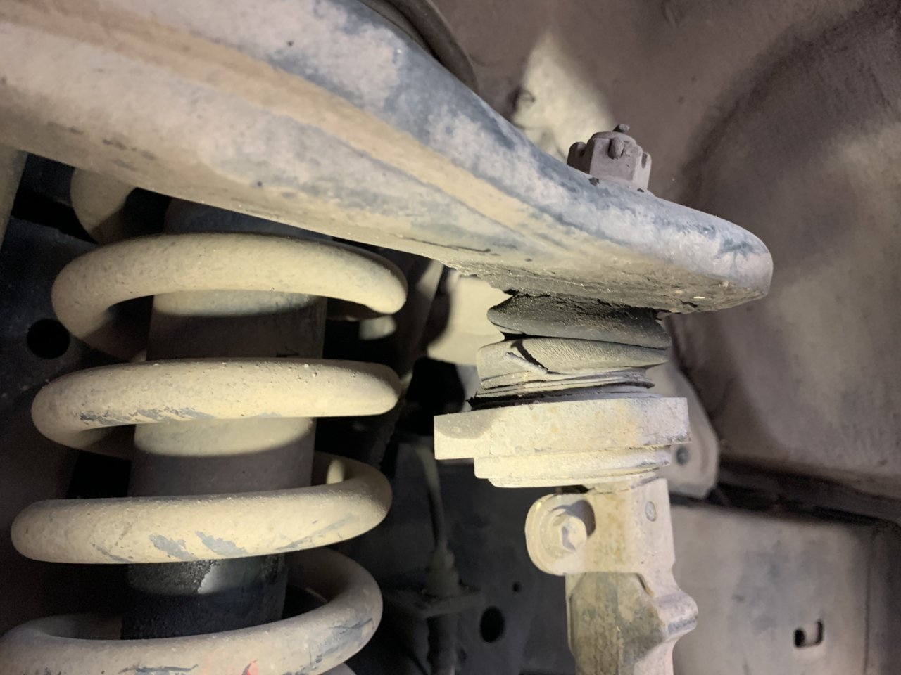

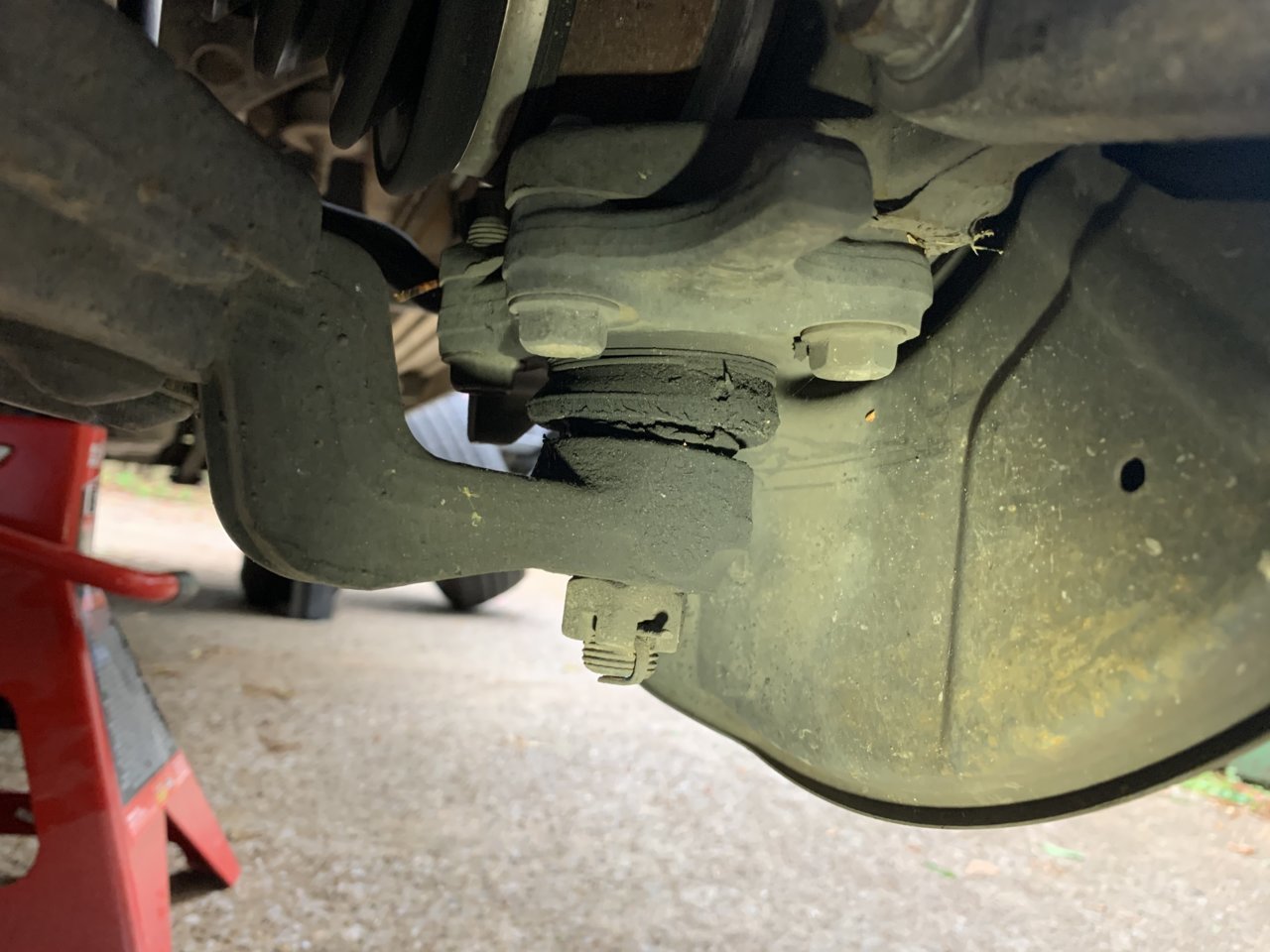

    Alright here’s the 4runner ball joints. Brakes and rotors are good. Cvs look good and everything rotates and spins fine. Tie rods look fine, and obviously the steering rack is brand new. Sway bar bushings look like shit but that doesn’t affect the issue I’m having.
    With the tires off the ground, neither driver nor passenger side tire “wiggled” when I grabbed them and moved em. With a crowbar under the Lca I got 0 movement/play out of the lower ball joints but here’s photos.
    Driver side lower
    Driver side upper
    Passenger side lower
    Passenger side upper

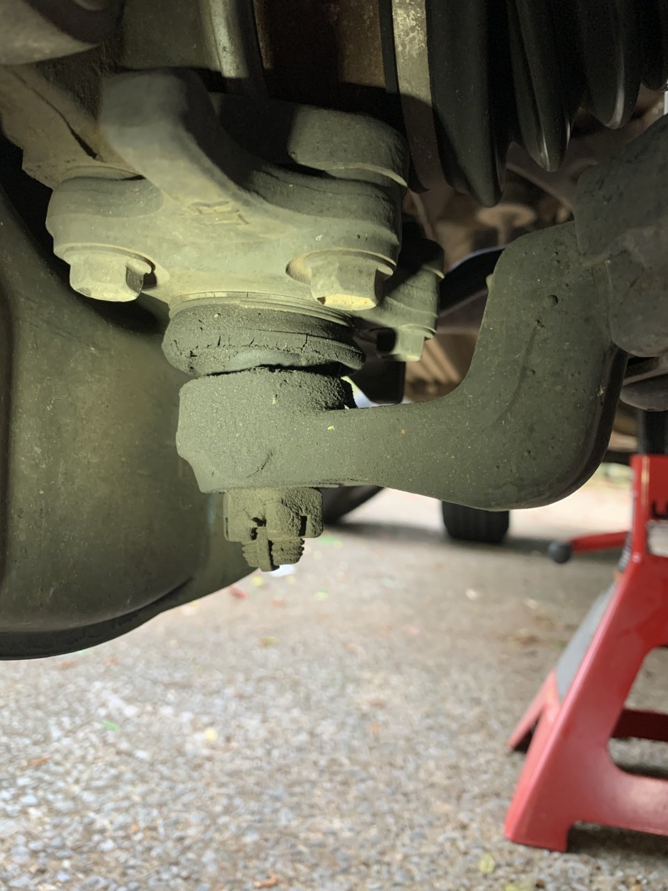

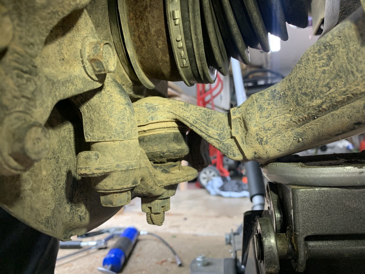

  19. Apr 13, 2020 at 4:03 PM
    stronghammer
    stronghammer STTDB
    Jan 8, 2016
    #174366
    35,132
    Scotty
    Huntsville, Alabama
    Drove the 4runner around the neighborhood and couldn’t get anything to happen to video, since it occurs at higher speeds normally.
    Also checked out the Tacoma and couldn’t get the clunk to repeat in the driveway. I’ll drive it to work tomorrow and see if I can get video. Here’s photos of the ball joints on it.
