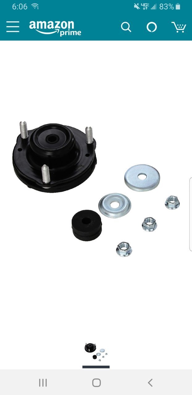

    If it didn’t come pre assembled then you would need a spring compressor. I would recommend getting a new top hat and taking it to a shop and getting them to assemble it. It will illuminate a lot of time. Probably won’t cost much at all to get them to do it

    I bought new top hats. The reason I didn't get them assembled is b/c they are adjustable and I want them to match the rear lift. I figured that was the easiest way.

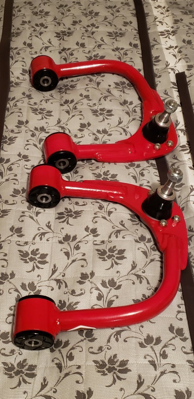

    Looks good. Might take a bit longer cause you got UCA but we will get them in.

    I figured I wanted to go ahead and replace it all at once and not have to do things twice.

    Getting that UCA bolt out is a bitch. If you dont want to bend your body then you need to get another through bolt. I can just cut the head off the one in there and we can slide the new bolt in. Its up to you.

    For $10 each, I'll just buy new ones.

    Just do not slide the bolt in opposite of the way it came from the factory

    Ive hear people do it with no problems. Mine went back in the same way it came out. The reason it goes the other direction is because the angle is angled upword so if the nut were somehow to come off the bolt wouldnt slide out.

    That's your best bet. Cut the old ones out and install new ones. Saves a lot of headache.
