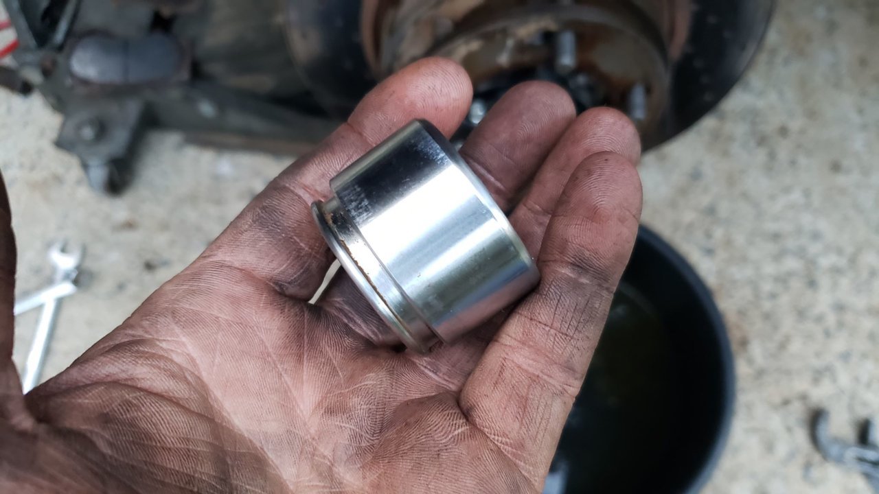

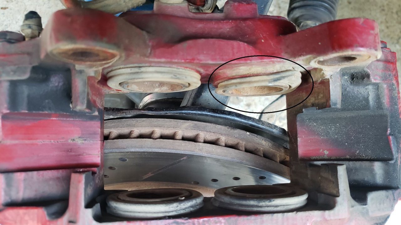

    Found what was causing the stuck caliper, outer seal got pulled inside with the piston.
    Piston looks good so new inside square o-ring and outer seal/dust cover and should be ready to go.

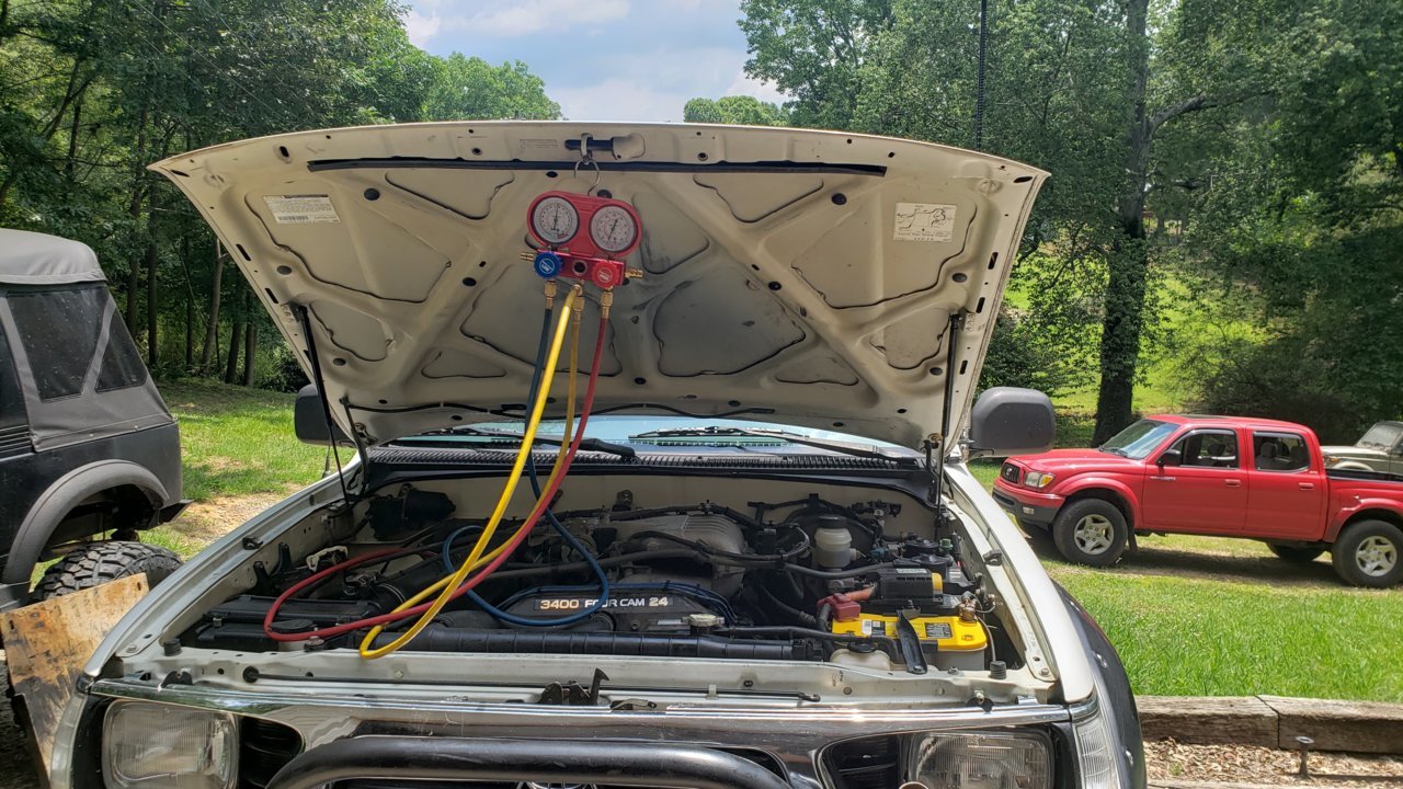

    These fancy looking tools gives the appearance that i might know what I'm doing lol

    How you liking your Optima yellow top? Worth the extra money?

    It's ok I guess.
    I have two of them in this truck, one is under the tool box, I use it for my tent. I use them because I can discharge them a lot and it doesn't affect them at all. When I have the tent on I use them for laptops to dump GoPro videos onto, music and movies if bored, charge GoPro batteries, fans in the summer and electric blankets in the winter. I have never totally discharged them but came close a few times. I have a system that keeps them charged for me without me having to think about them.

    Miss having manifold gauges. Someone decided they wanted them more than me.

    I just get them from AutoZone, I would like to have a set but every time they say that will be $175.95 I say I'll just rent them and bring them back LOL

    yea no point to pay for them if you dont use them often lol. If you do i would buy some haha.

    I had a set from cornwell. Cost quite a bit. Then they walked away lol. Not buying them again
