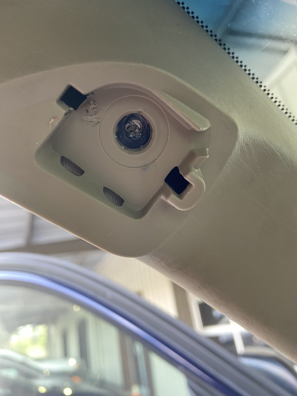

    This is my a pillar grab handle top bolt. It broke. So I drilled into it and tried to use an extractor bit on it and that also broke. Now I have soft and hard steel mixed together. Any ideas how to fix this cluster? Lol

    See if you can drill the extractor out with a regular bit and start over with a new EZE out extractor?

    Pull the plastic piece off and weld a nut on it.

    Cut a slot in it and use a flat tip screwdriver to remove.
