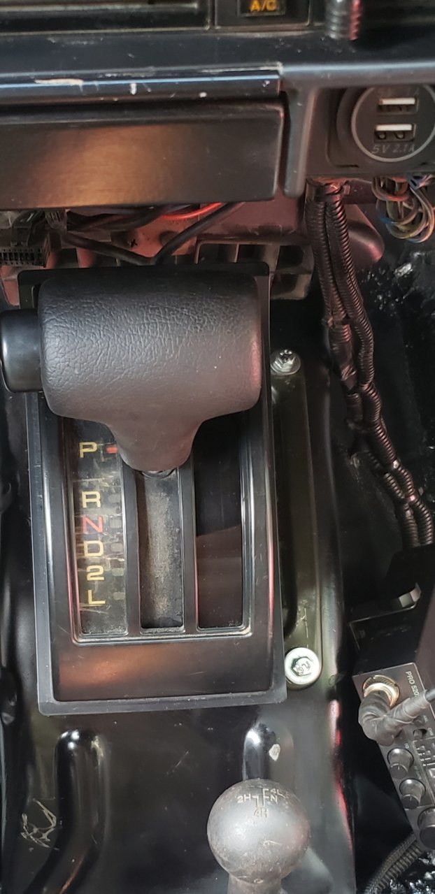

    Got the automatic shifter in today
    Still got to build a fiberglass console to fit around it. But all the metal work is done

    looks good!

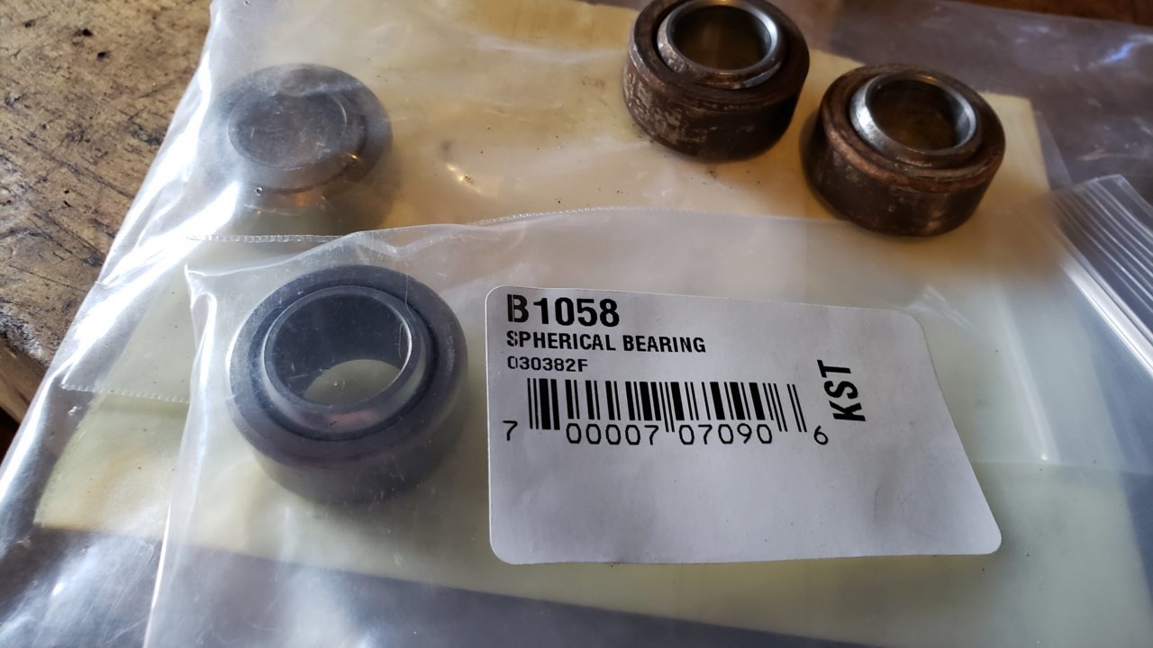

    @JBTacoma didn’t you replace the spherical bearings on your king coilovers not too long ago?

    damn is that thing a 3 speed?

    Yes and I bought the top bushings but they didn't need them

    Yes Sir, I locked the governor so it is a manual 3 speed. I didnt want it shifting gears on me in mid crawl.

    Just primed in, still got a little body work to do and I am going to build a fiberglass console around the shifter but it's coming together.

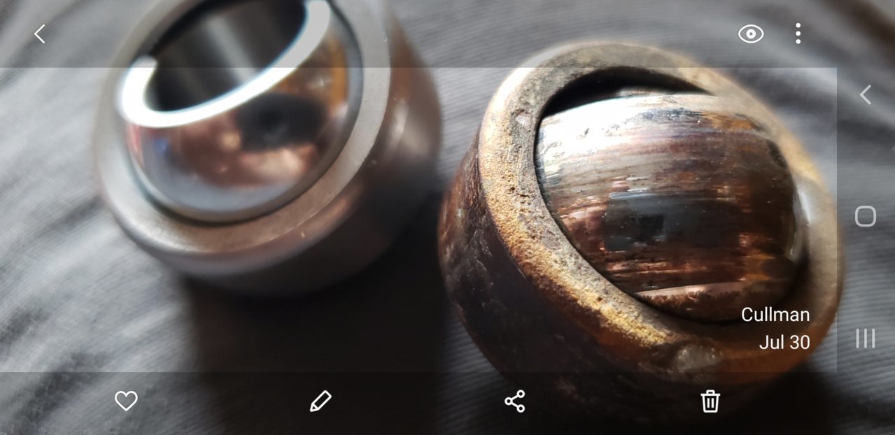

    Why do you think your are bad, idk if that’s what was squeaking on mine but sprayed them and my lca bushings and it quitened it down but always kinda been worried about um.

    Take the bottom bolt out and you can see if they are bad

    Just loose like a worn out bearing?

    Yes and all scared up, here is new and old.

    I use pliers to twist them out

    4Wheel Parts is the cheapest place to get them. Other places are cheaper on the part but charge crazy shipping. 4WP shipping was $6. They may not even charge shipping if you pick them up at the store

    There should be 0 play in them.
